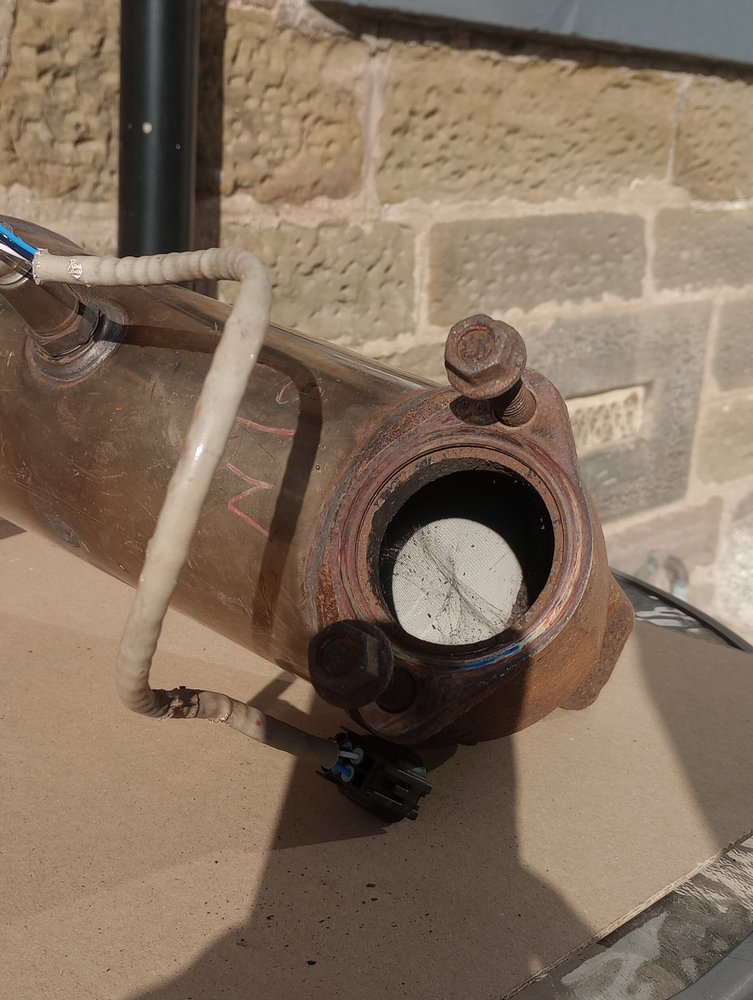

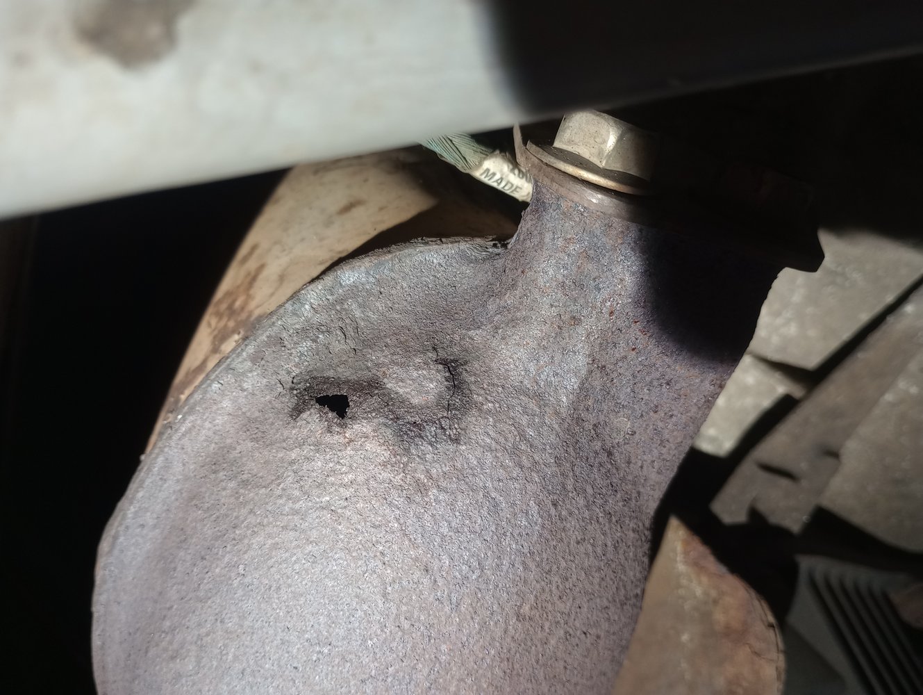

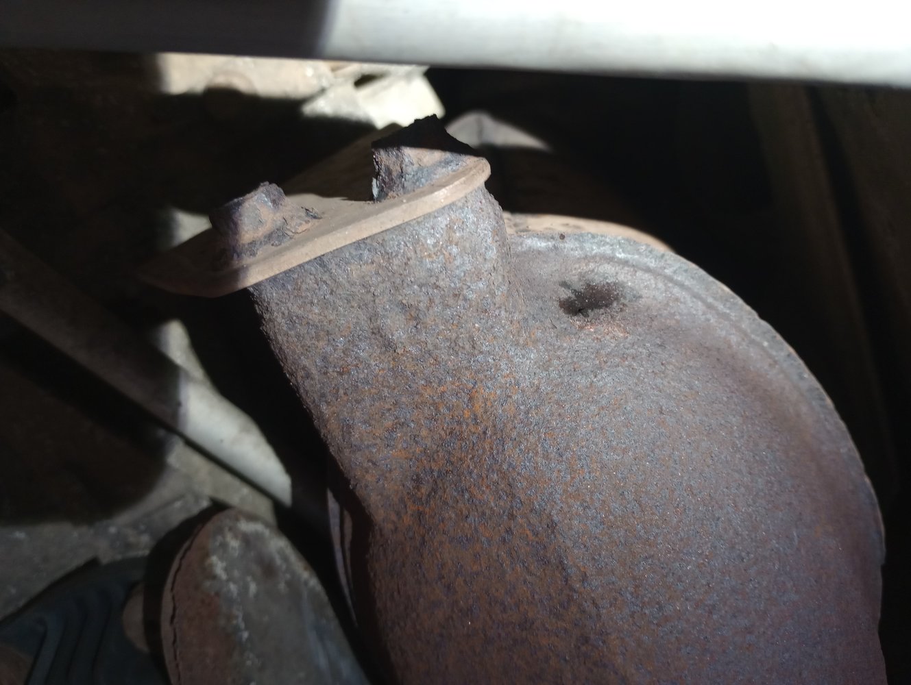

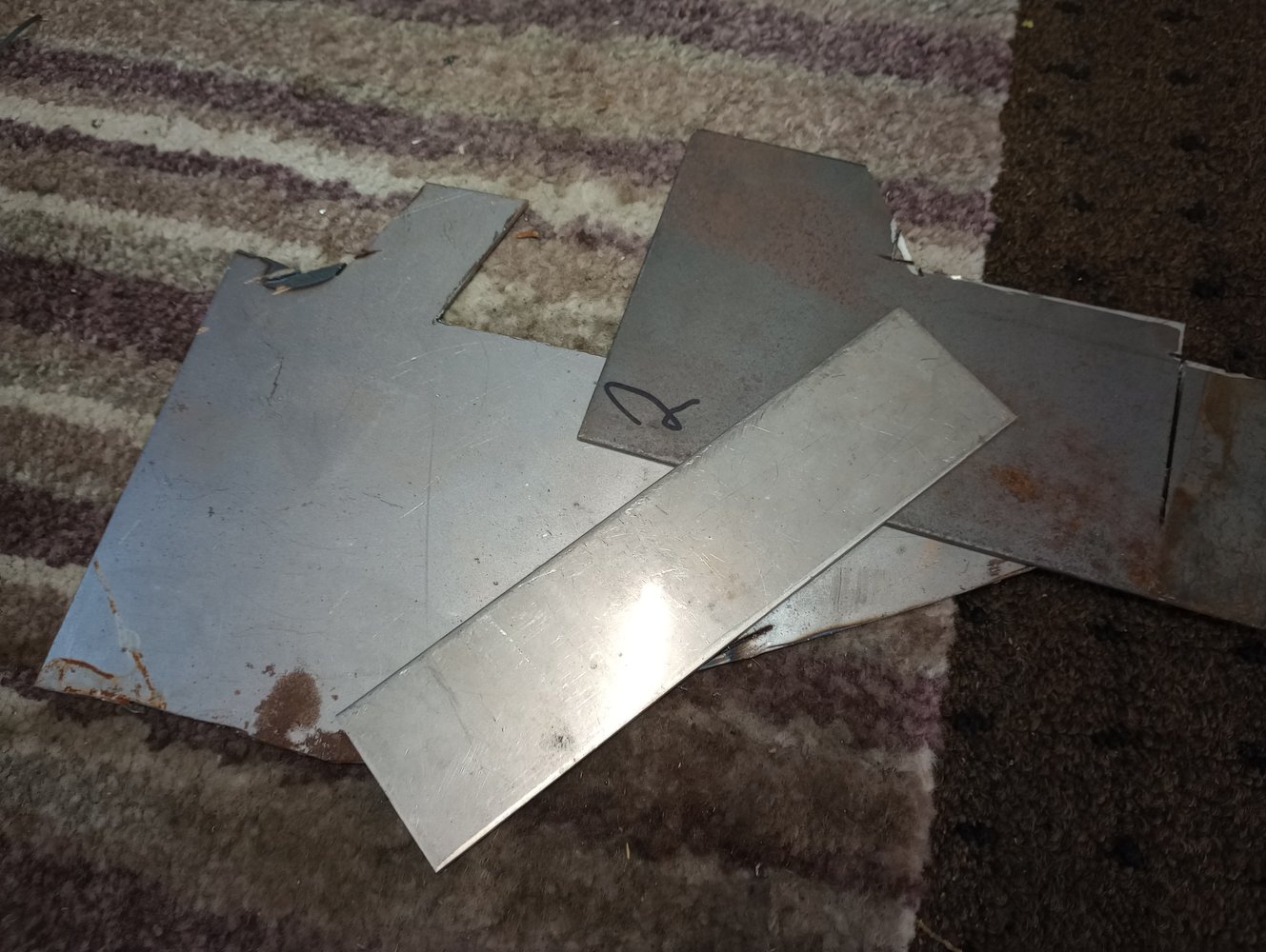

Tell me what I should do not what I can't do.You won't weld 3mm stainless to rusted steel 0.5mm thick.![]()
That's whatThe next problem is the MOT man fails it because he thinks you've gutted the cat.![]()
The perfect example of Schrodinger cat

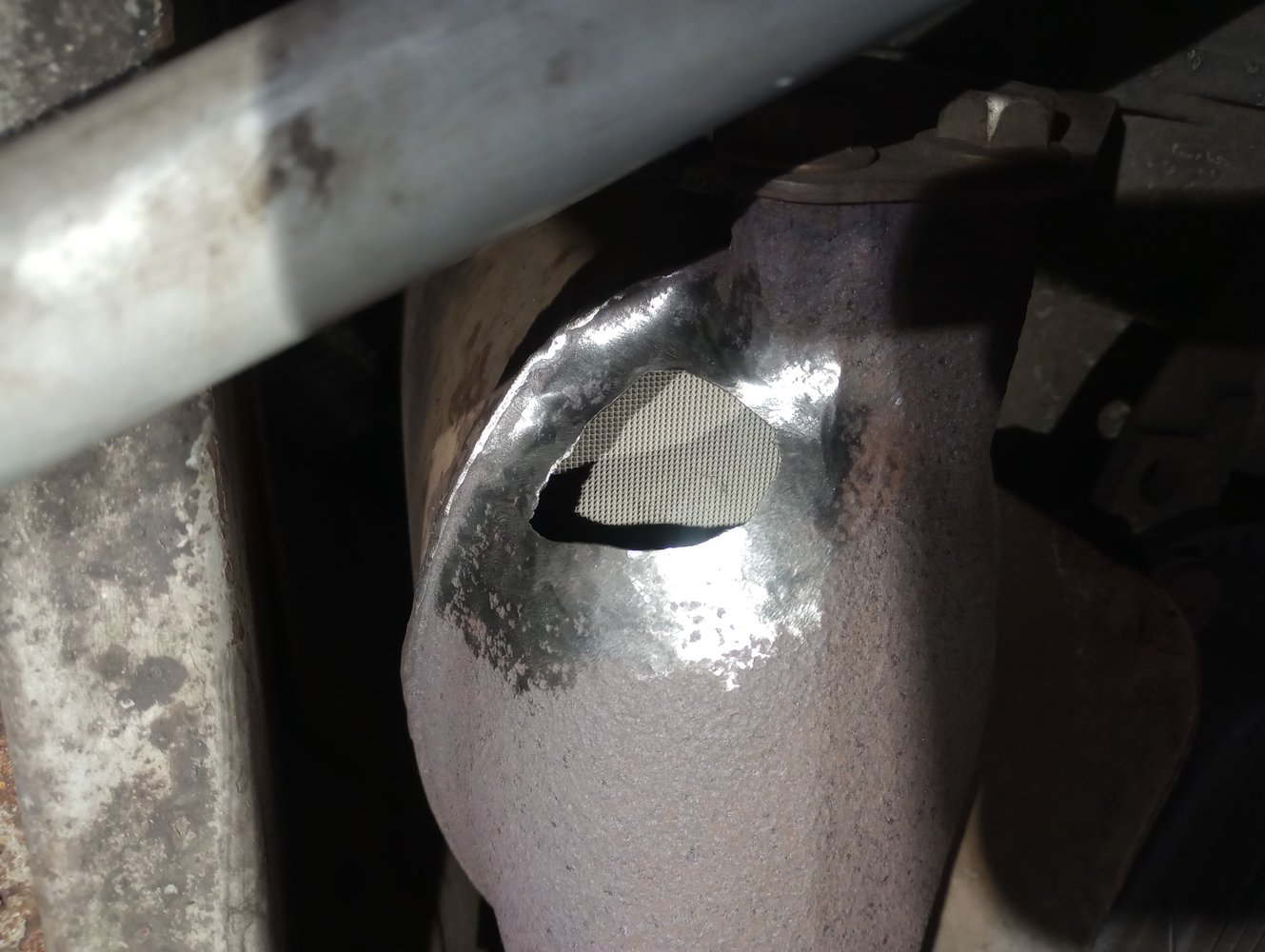

Apologies, oh me of little faith.Tell me what I should do not what I can't do.

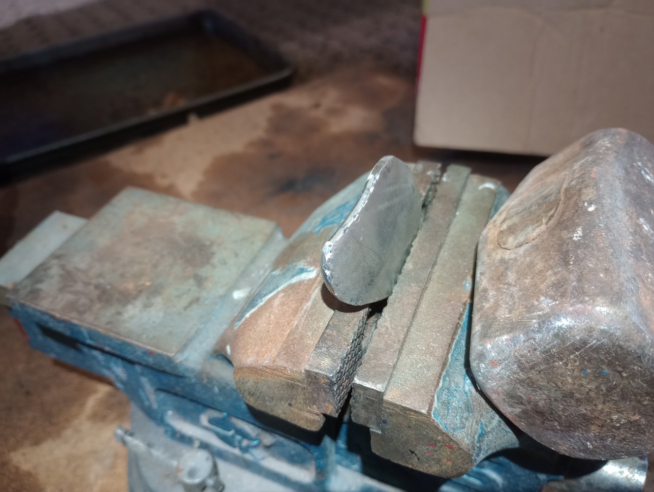

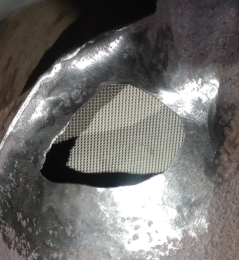

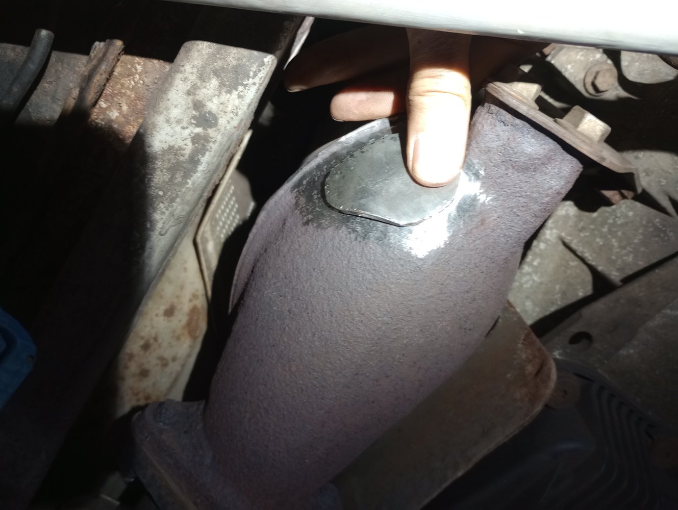

To be fair, that's not a bad repair given it was in situ and using less than optimal repair plateCut out and bent into shape.
A few mm of overlap.

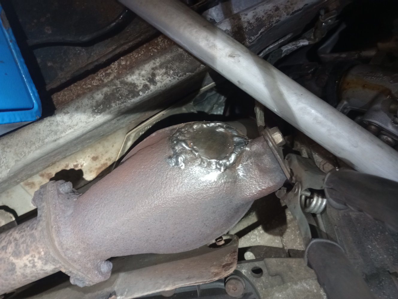

Well I got a bit of burn through, should have cut out a bit more, ended up building up weld to close the hole. That will do for now till I can sort out a more permanent solution.
