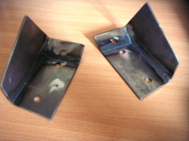

"Their mountings must be reinforced by plates. Each backstay should be secured by bolts having a cumulative section area at least two thirds of that
recommended for each rollbar leg mounting in 1.2.2 above, and with identical reinforcement plates of a least 60cm2 area (see drawing K19).
A single bolt in double shear is permitted, providing it is of adequate section and strength (see drawing K20) and provided that a bush is welded into the backstay. The mounting feet may alternatively be welded direct to the reinforcement plate."
Having digested the above regulation, I'm sure it is interpreted as the "welded bush" being the "mounting" point of the backstay, ie the same as the plate welded onto the bottom of the tube main and front bars, the brackets welded onto the turrets are then the "reinforced plates" which are more than 60cm2. It also doesn't specify a thickness of the reinforced plates although I have used 2mm plate, most of the ones I've seen are usually only 1 to 1.5mm.
If you look at drawing K20 it doesn't show any reinforcing plates between the mounting triangle brackets and the arch.
PLEASE COMMENT IF YOU THINK I AM RIGHT OR WRONG....!!!!!!
