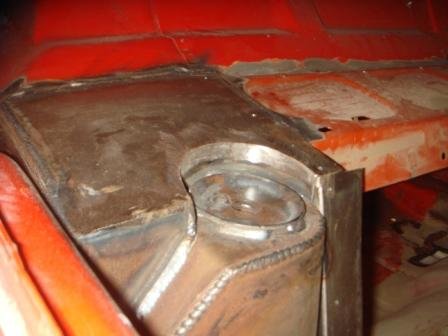

It's not a quick and easy job to fit these tubs and turrets..!! I can see why builders want up to a £1000 to fit them.
I had to make another jig to get the centre distance right, it took Hours and a lot of patience to grind the tub so that the tub to turret gap wasn't too big.
You have to continually measure and check centers. At least one is in ready to be tacked, the other one shouldn't take as long now that I have some measurements to copy.
