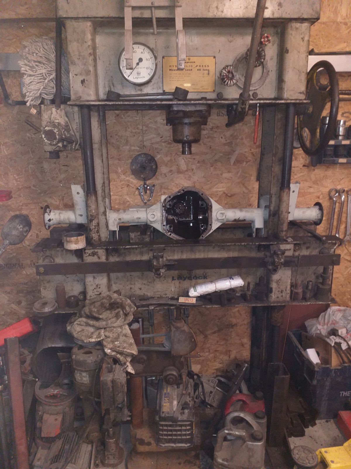

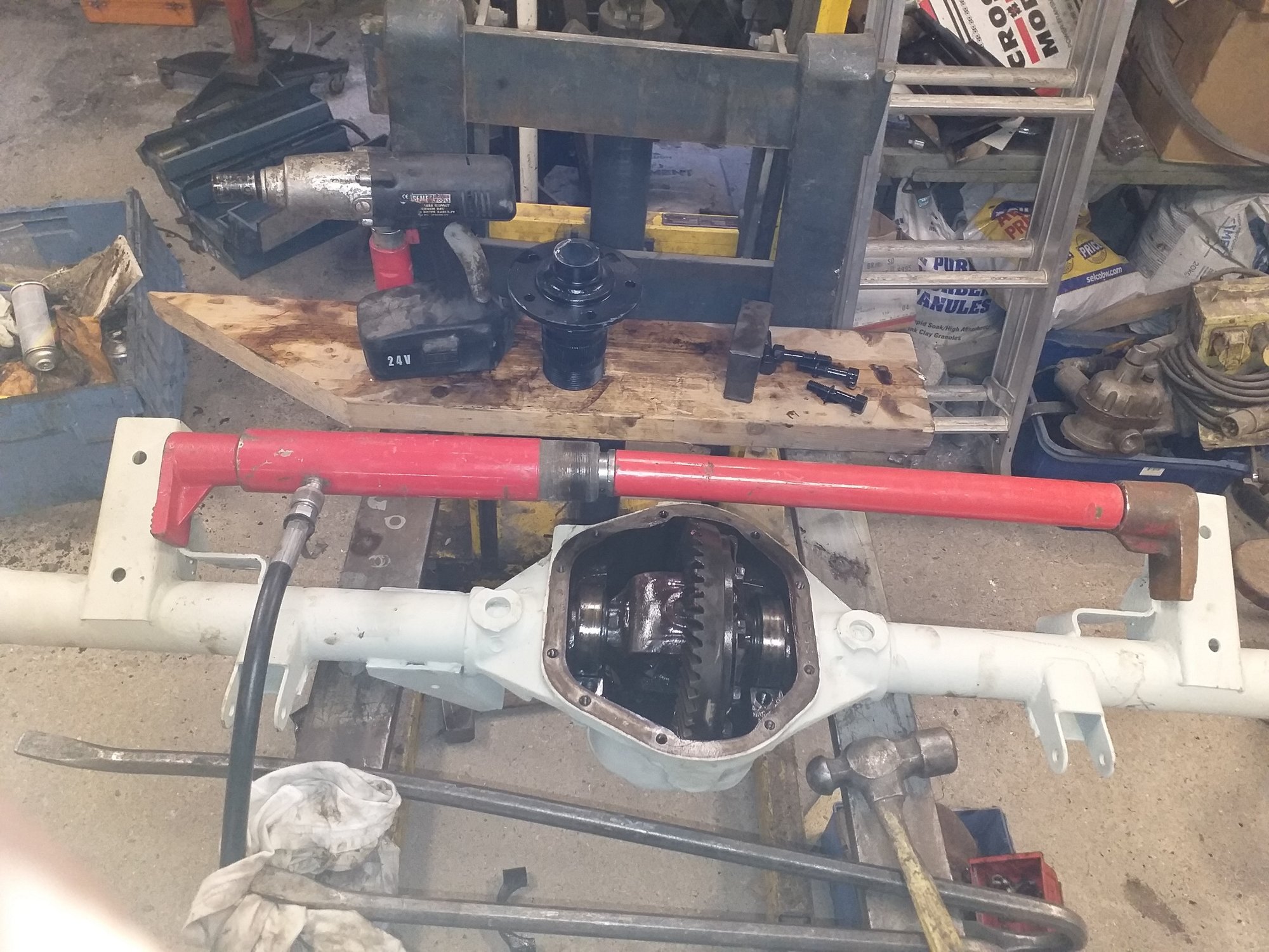

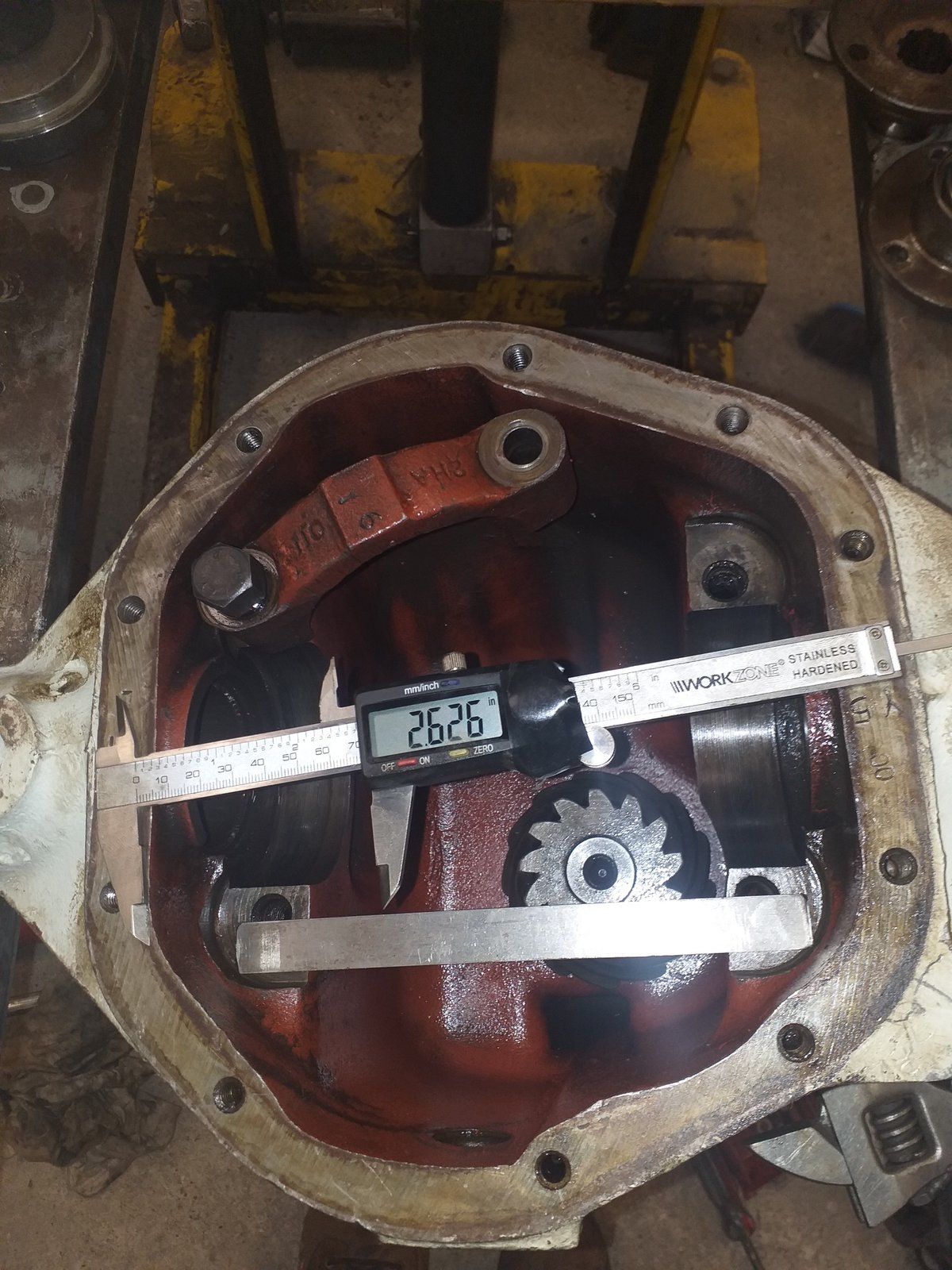

If I understand correctly, you're taking the internals from one diff and installing them in a different housing, is that correct? If that is the case, and I will say that I don't have a great deal of experience with diffs, then it doesn't sound unreasonable to me that the shimming could be a long way off. Is the crownwheel in the correct position? That will greatly affect matters if not. But I'm sure you know a lot more about diffs than I do, just some thoughts.
You could blue the crown and pinion to satisfy yourself that the mesh is, or looks to be, in the right place, once you've shimmed it.
Bit of a read but should make sense to you ?
http://www.thecarnut.com/Manuals/SalisburyAxleService.pdf
