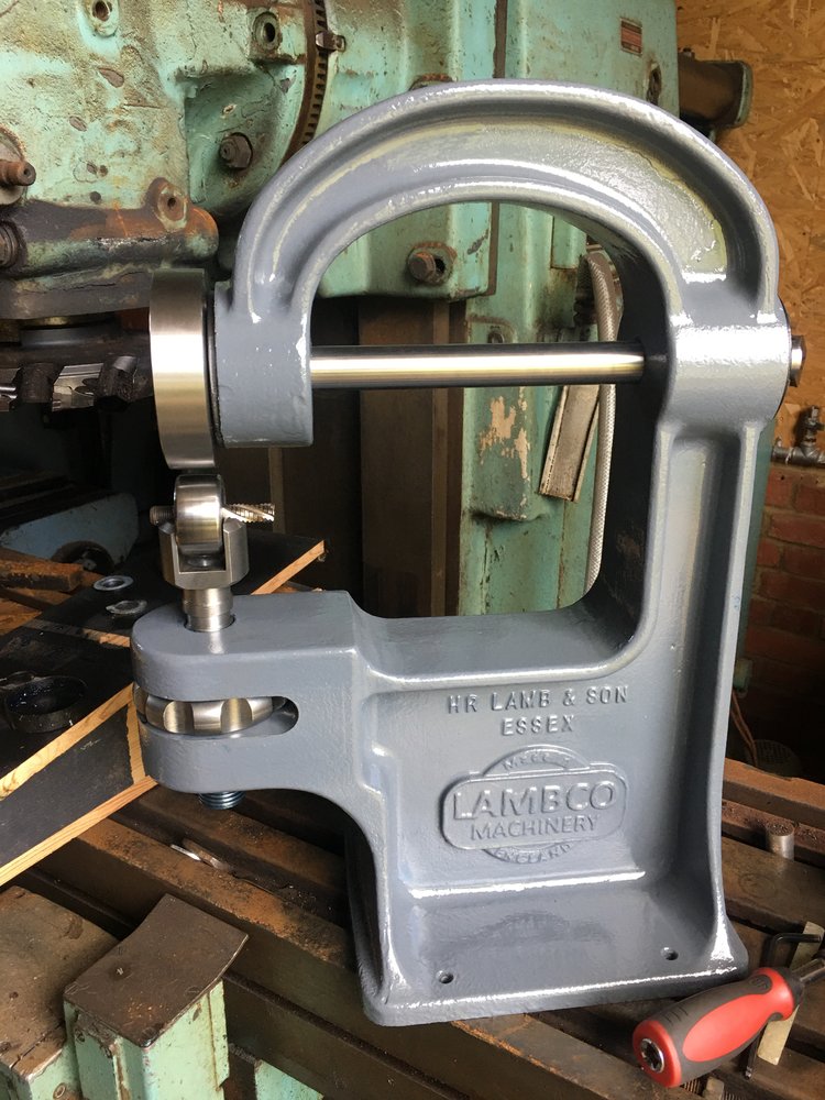

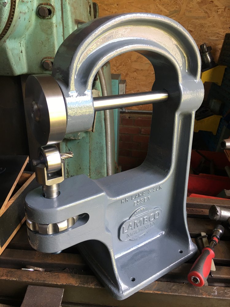

10” approx so 19.5”@pressbrake1 Hi Clive, can you remind me what the size/throat is on these, wanted to work out max panel size I could use one for. Was trying it find the original thread but can't locate it.
Cheers,
Paul![]()

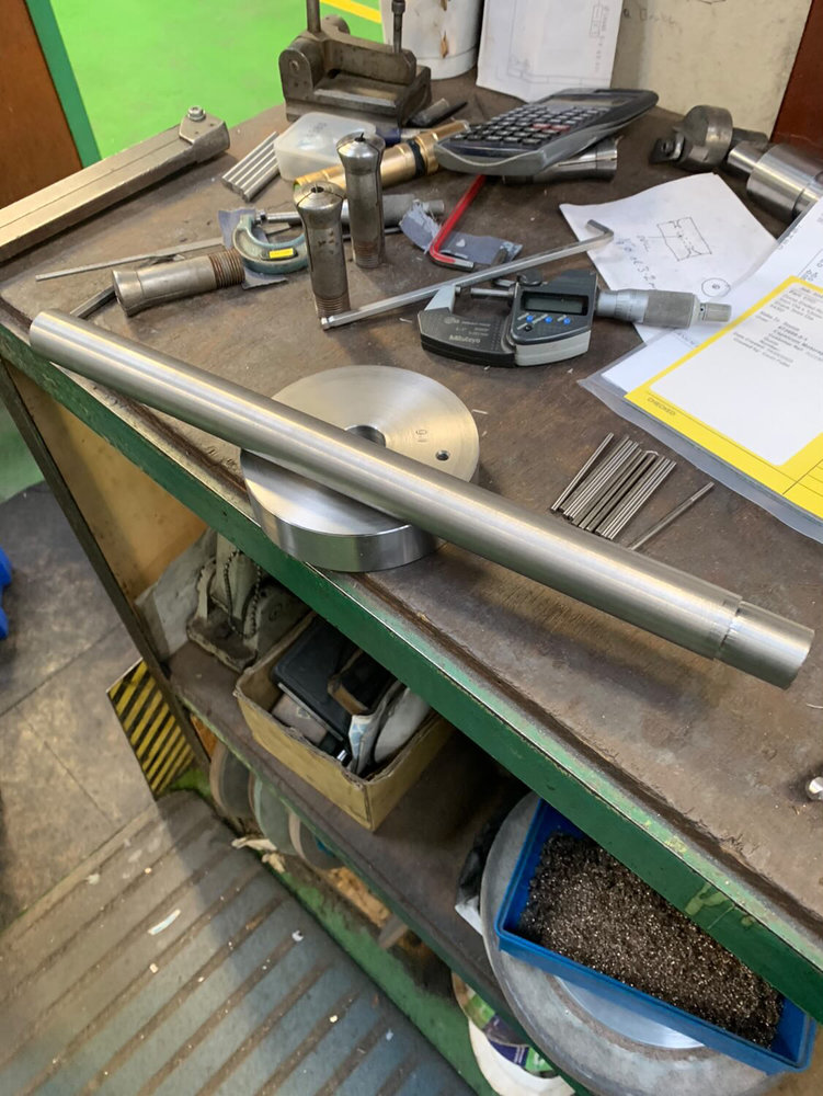

Please be a manky vice,please please pleasetop wheel dead centre ground on the shaft to give sub micron run out but obviously the bearings will ruin this

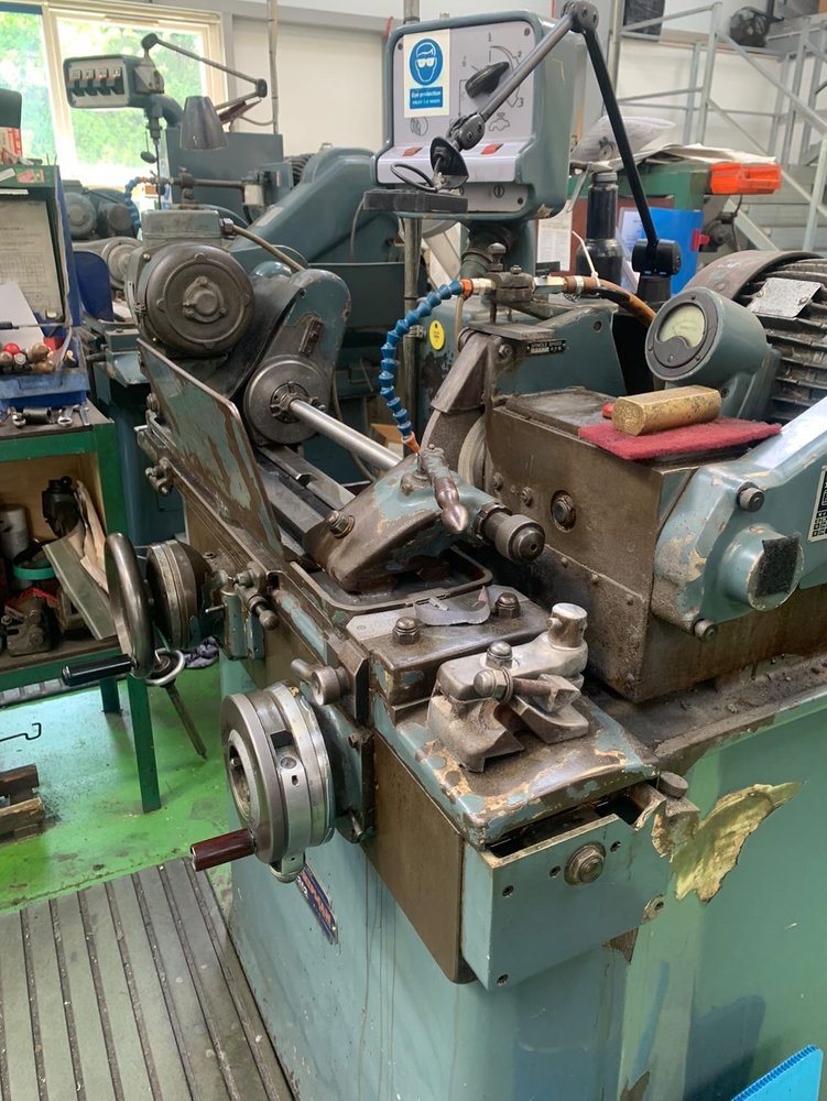

He is a grinding specialist so very fast for .0003 , pretty fast for 0001 and quicker than you’d think for tighter than that!How long does a job like that take someone like Will to do?
I bet it’s less time than it would take me to find the start button on the machine!
Less time than it takes to strip, clean, paint and reassemble a manky vice...How long does a job like that take someone like Will to do?
I know there’s a time and a place for everything, so maybe I shouldn’t be too hard on my ‘that’ll do’ machining but…He is a grinding specialist so very fast for .0003 , pretty fast for 0001 and quicker than you’d think for tighter than that!
A grinder man will be quicker to .0005 than on a lathe

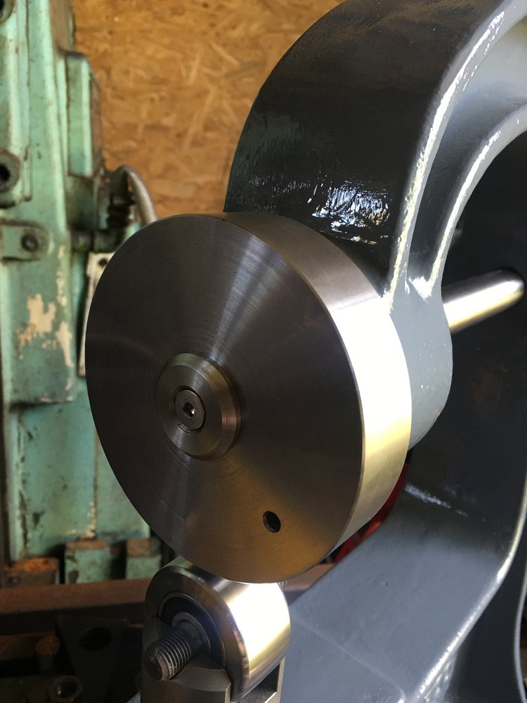

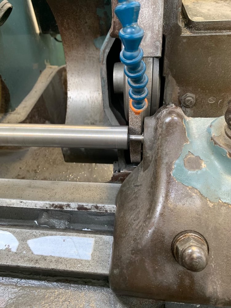

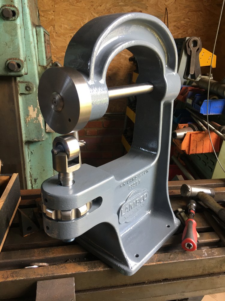

Mini wheel no1

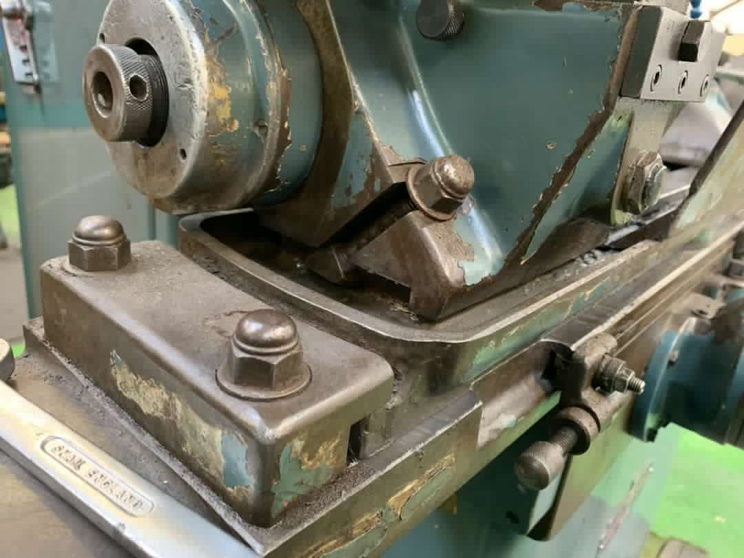

Drove the 170 round hour to wills last night to pick up spindle no1 .
Precision ground spindle and wheel and axes are better than .0001 for square, yes I’m mad but these are legacy pieces
