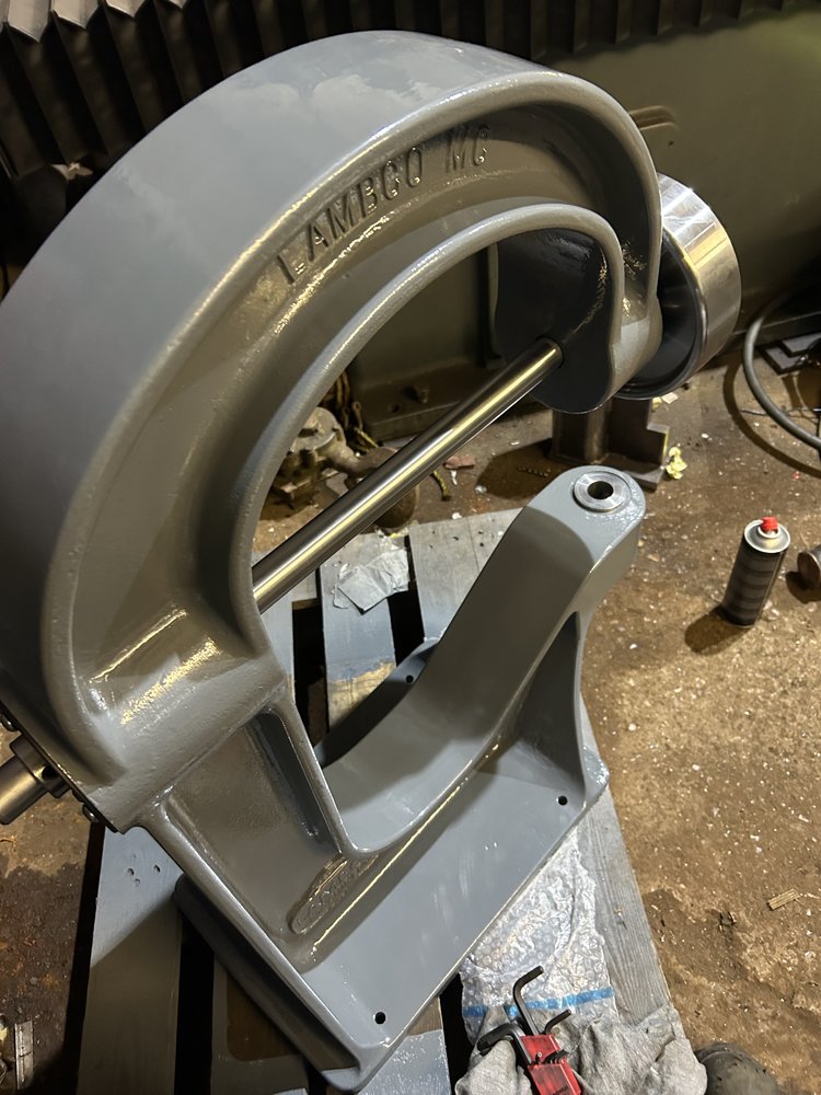

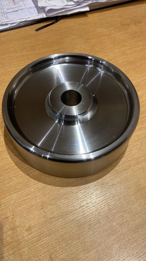

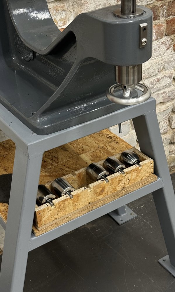

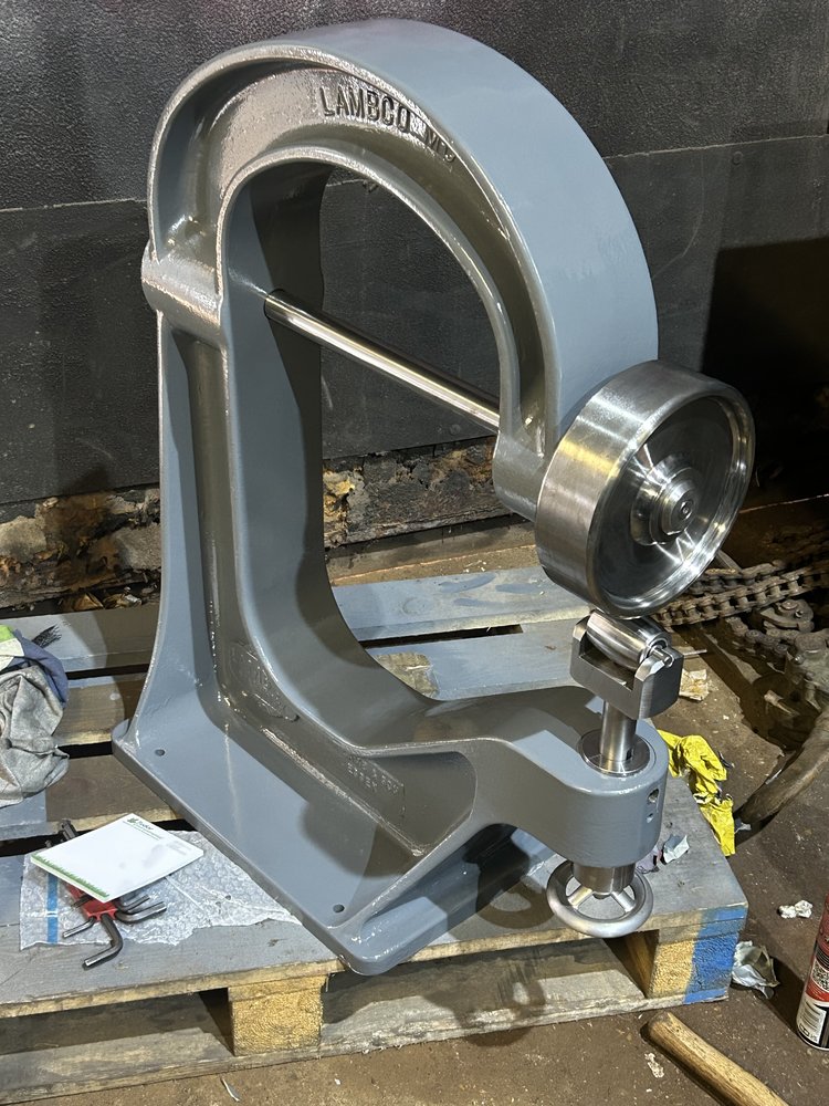

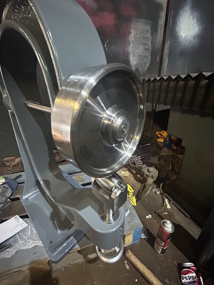

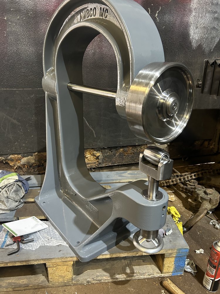

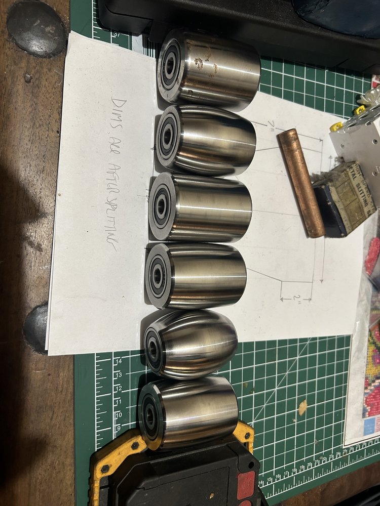

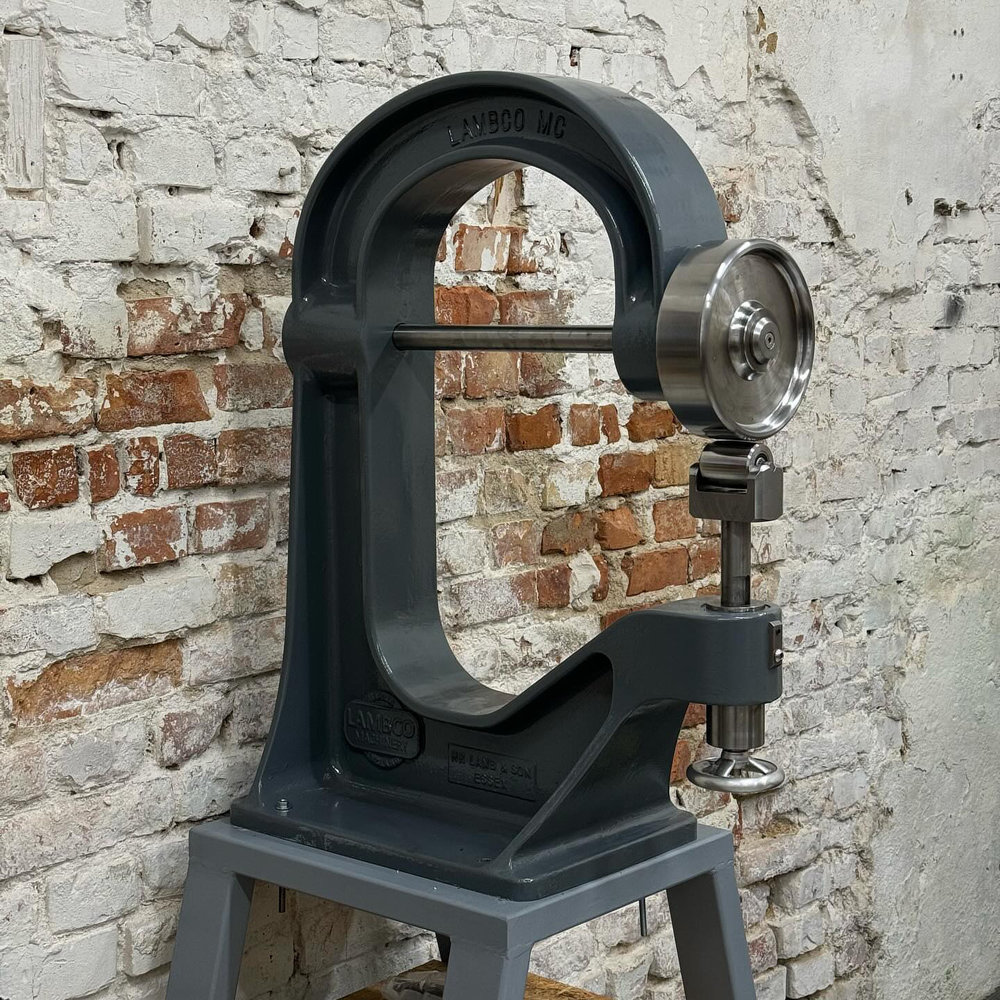

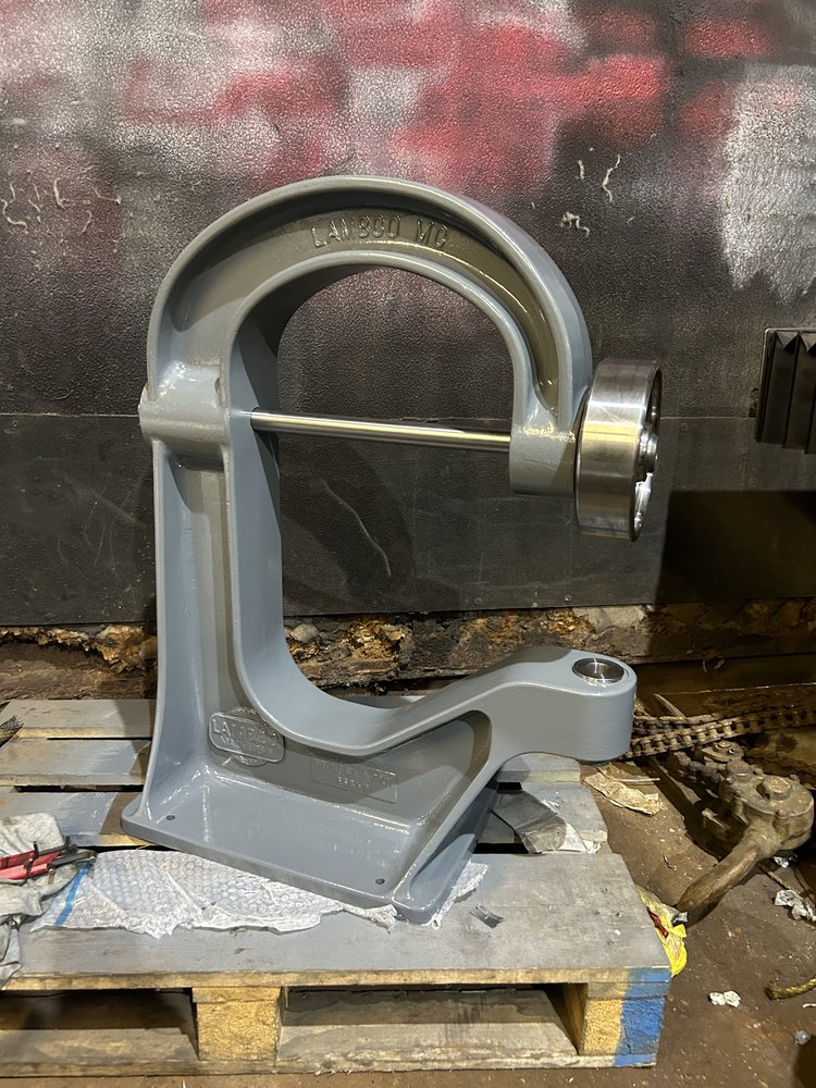

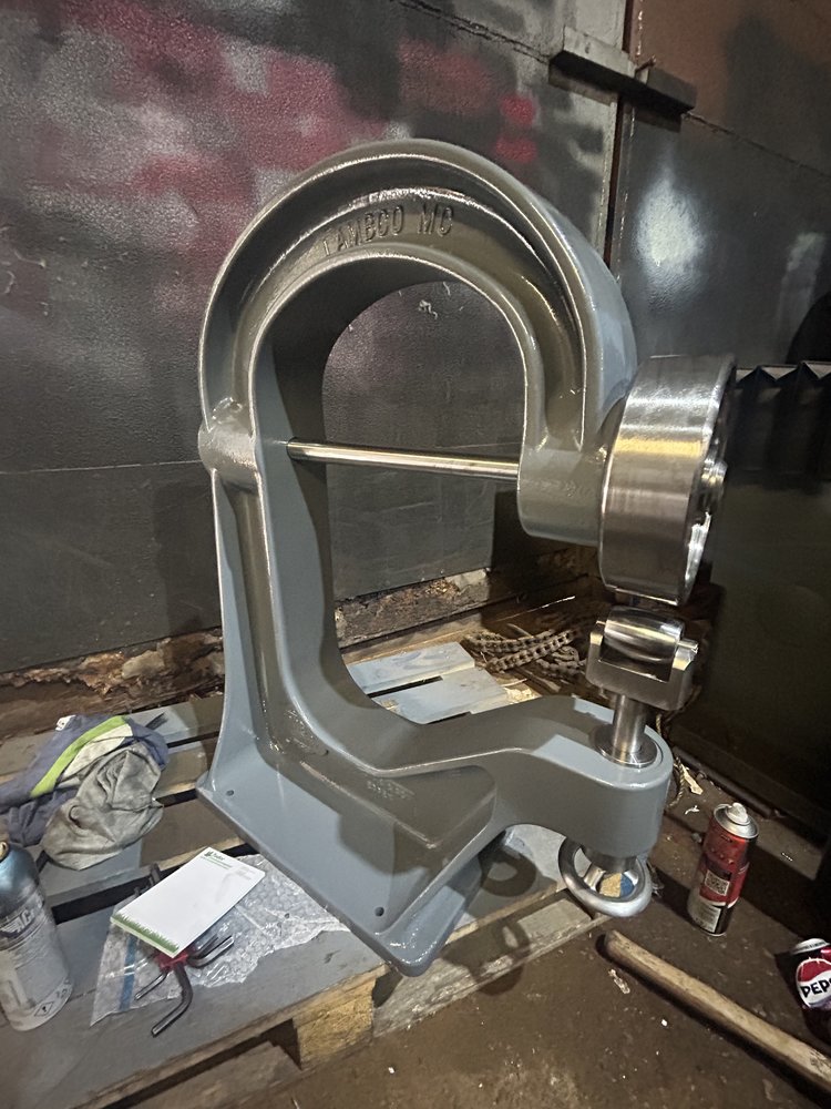

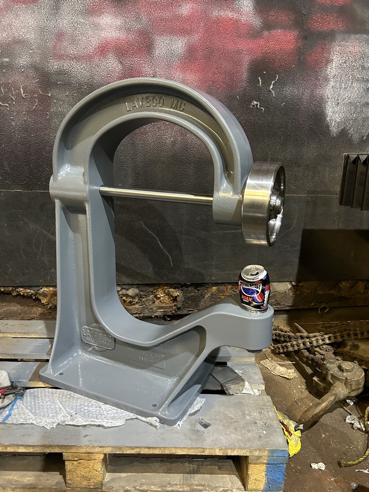

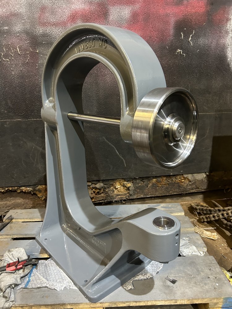

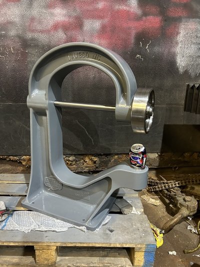

Yes going to Poland. Europeans can’t accept the best wheelers in the world are in the uk and prefer flats as full rad always has a small contact so WONT take any advice.Full radius anvils there?

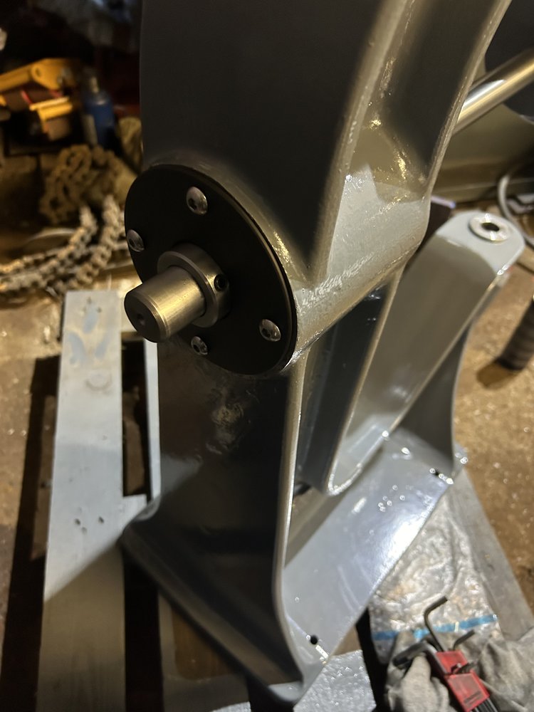

To defeat gravity and hold top wheel in required plane and resist forming forceWhat is the purpose of the spindle?
