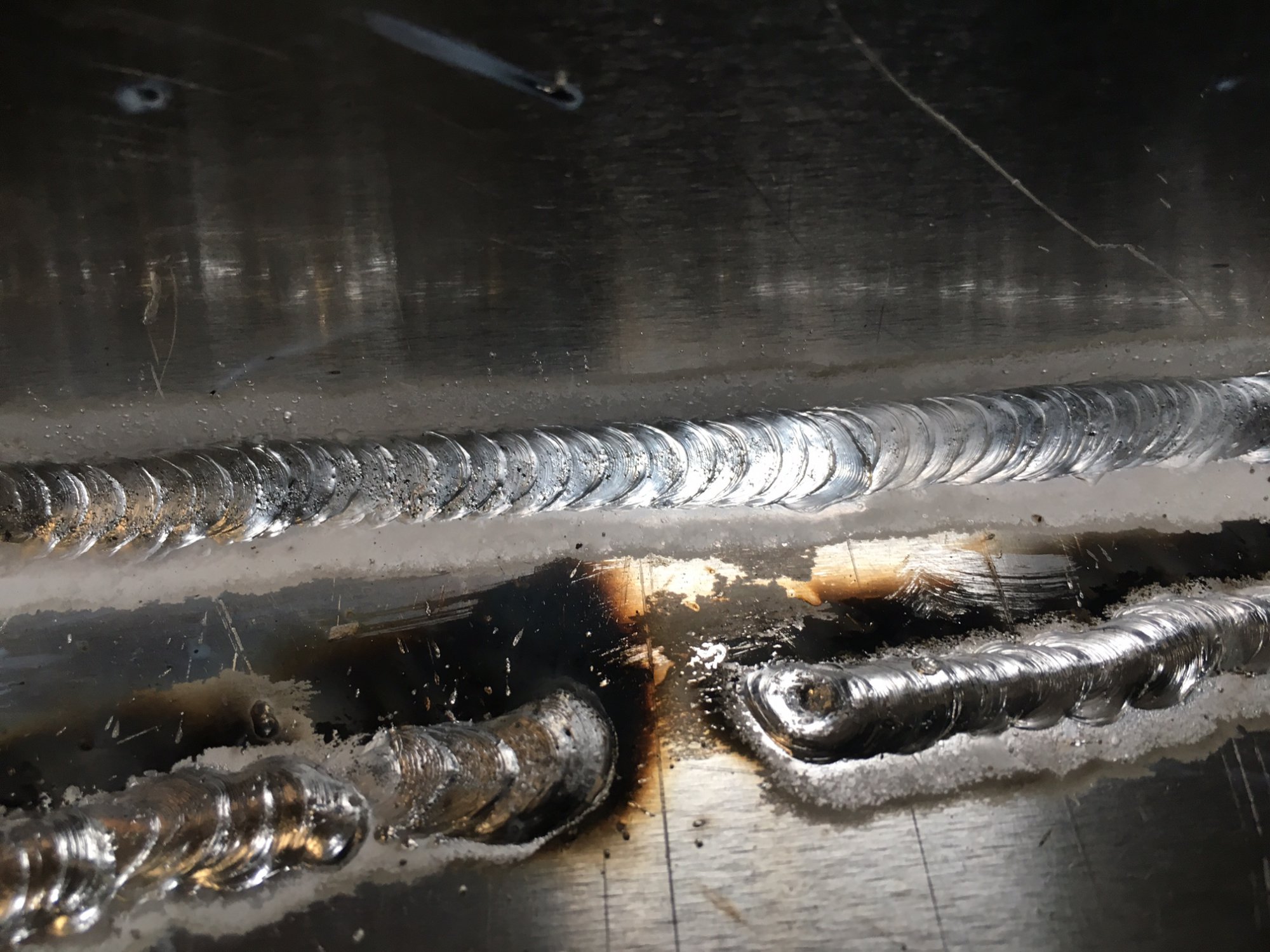

Is there a setup for 1050 wire in the S3, I'm using the 4043 wire at the moment for 1050 sheet ali, we just weld up corners.

I would have thought 1050 wire in a mig may well lead to feed problems?

Of course, Cebora, Binzel, Phillips, Lorch, EWM, Fronius all the major makes have one.

Looking good although there seems to be some dirt or porosity?
Presume it is a pulse mig as if not I have never had much luck under 3mm with mig so want to know your secret?
