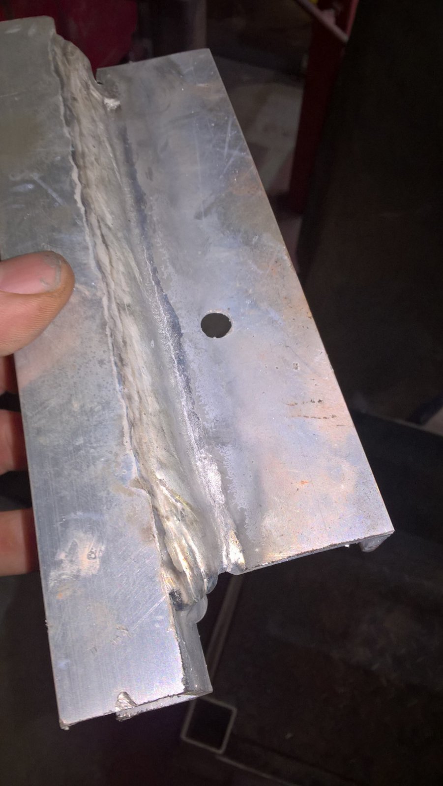

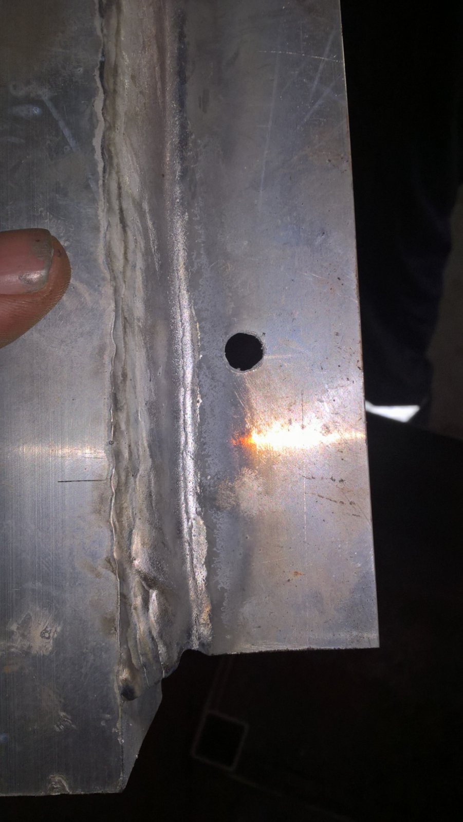

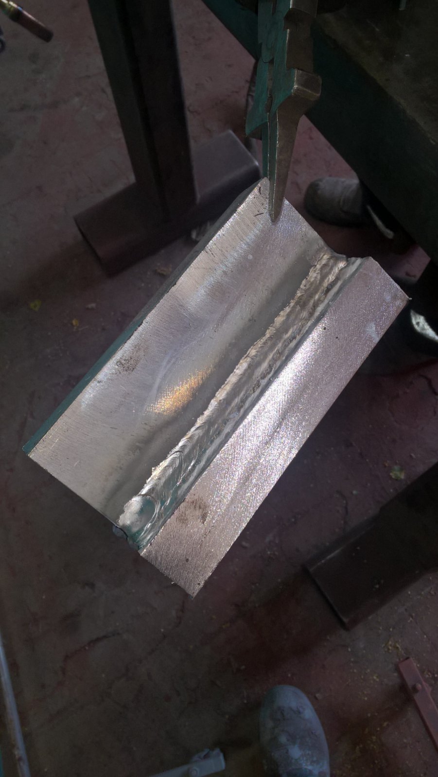

. With a 8m push pull gun, you stick the wire through the rollers, with the gun set fully assembled and set for welding, just press the feed button. Wire passes through the 8m liner, through the push motor rollers, through the neck and out the tip. I wondered always isn't that what all machine are supposed to doHi Paul, sorry if this has already been said as I know it’s old post now, haven’t been in here for a while.I had a blast at MIG welding aluminum for the first time today - first photo - not too bad apart from an end crater - 3 runs there.
Messing about with AlSi and AlMg wires - AlMg gave us the best welds, but with no problems with feed etc, which i'd expected. Combination liner, oversize tips, U rollers and an expensive welding set seems to have sorted that
2nd/3rd picture - the parent material cracked right through at the edge of the HAZ. Why does it do this?
