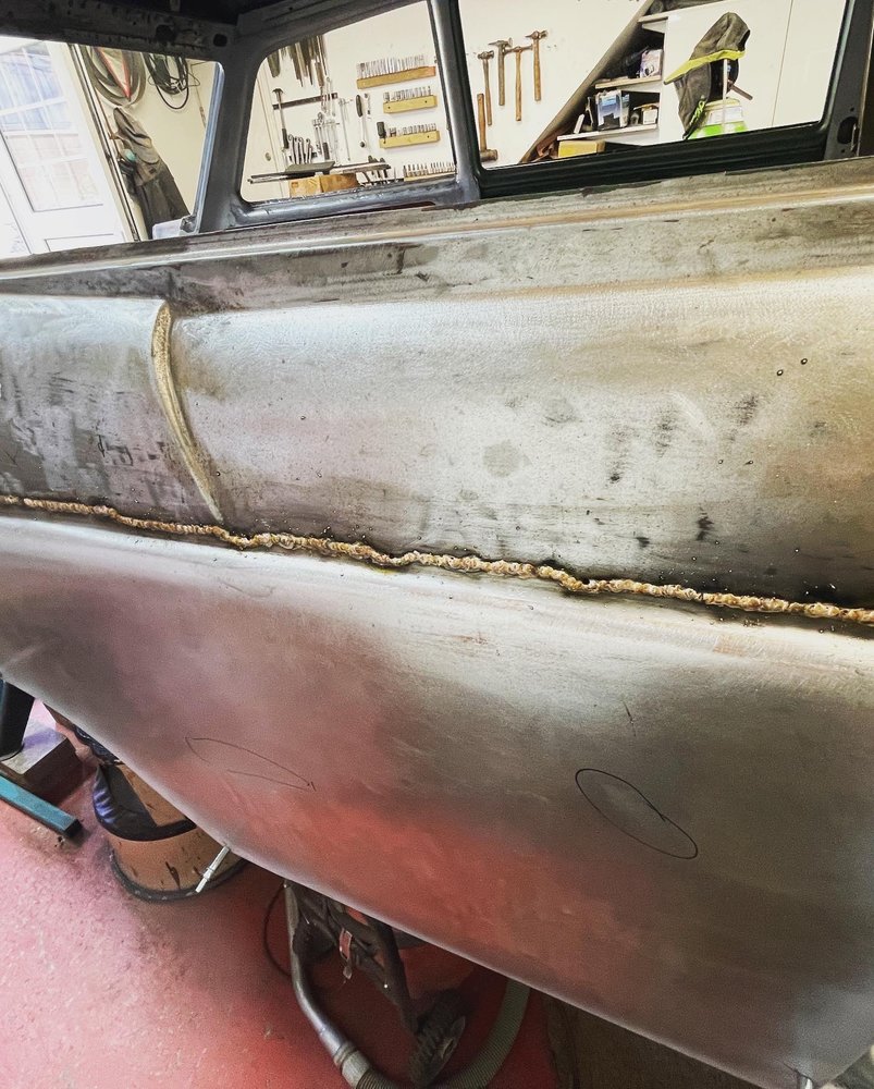

Will TIG do.48 posts so far and not one photo of what brazed mig welding looks like

Hugh can you hammer and dolly the braze ok? What amps do you use? I have a Portamig 215 and minimum amp are 15 so maybe on the high side? Would like to give it a go.

You sure can. You don’t need any special low minimum amps, I’ve run it successfully in all my various machines to date. Even ran it off my ranger with a spool gun.Hugh can you hammer and dolly the braze ok? What amps do you use? I have a Portamig 215 and minimum amp are 15 so maybe on the high side? Would like to give it a go.
