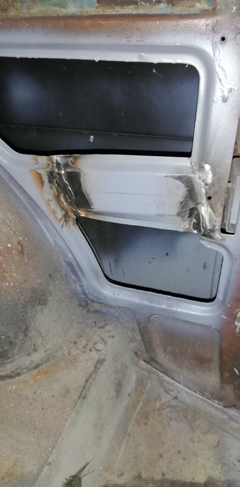

Repaired the inner panel behind the passenger side. The hole had been cut for speakers which took strength out of the door post. You could flex it.

I have started using weld through primer before I dress the welds. It shows up every gap, trough and pinhole
I won't lie since doing this I have looked at a few welds and thought I need to do better.its making jobs take longer but slowly the end result is getting there.
