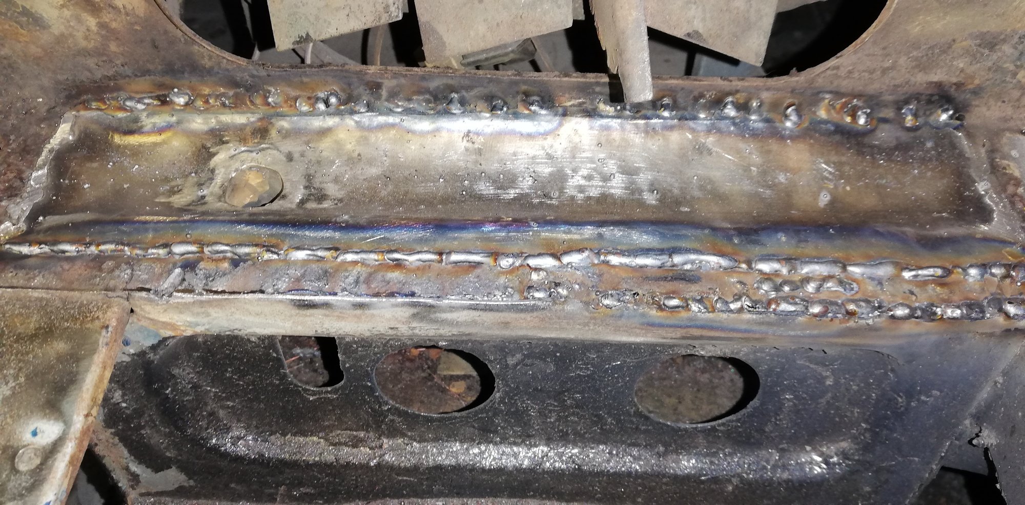

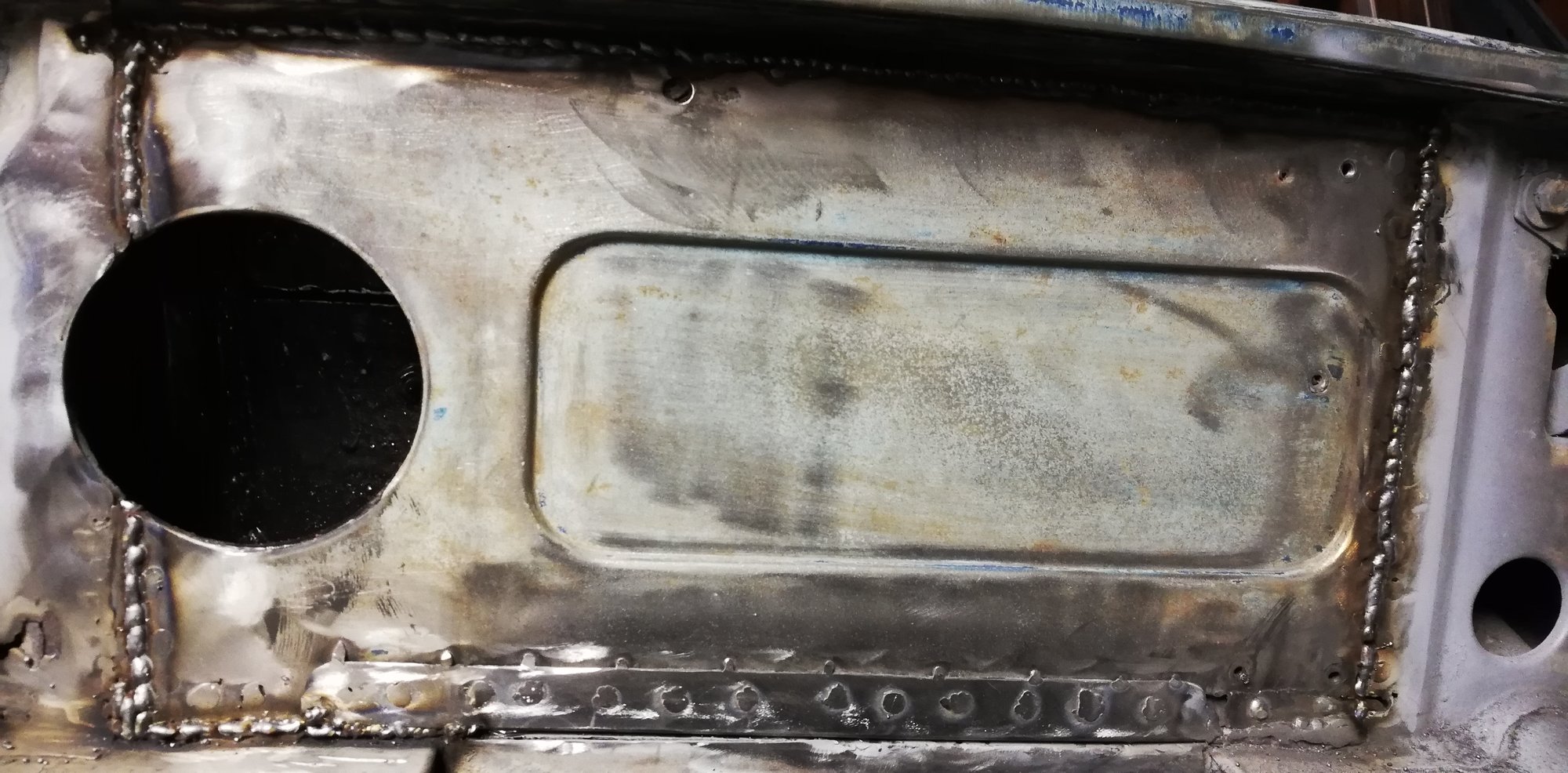

Easiest way I've found to dress welds flat on panels that are seen , is a piece of masking tape either side of the weld and a flap disk .
When the disk starts scuffing the masking tape ... time to take care as your nearly there .
