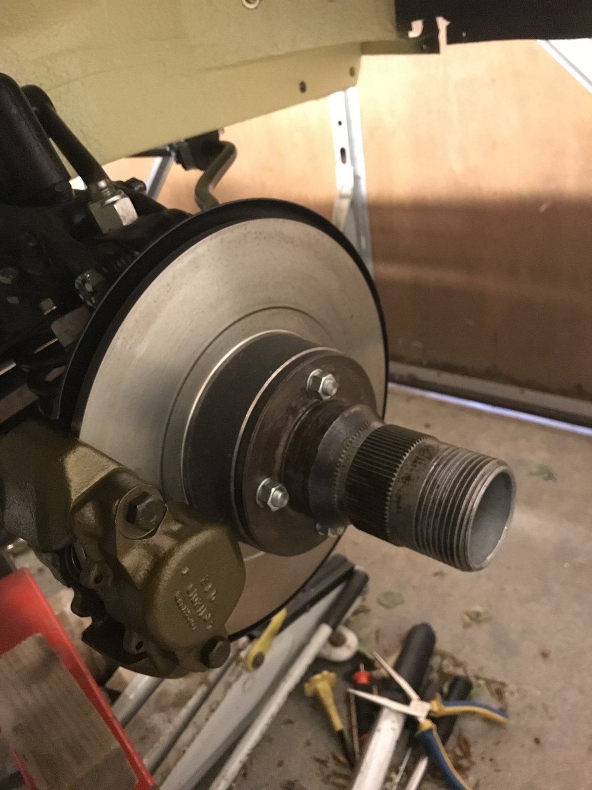

Thanks for putting up the details of how to rebuild the front hubs - better than any manual!
Eventually finished the off-side one today after faffing around for ages with the shims to get the correct end float and then having to disassemble the whole lot again because I didn’t realise the brake disc had to be bolted on the rear of the hub before fitting to the stub axle.

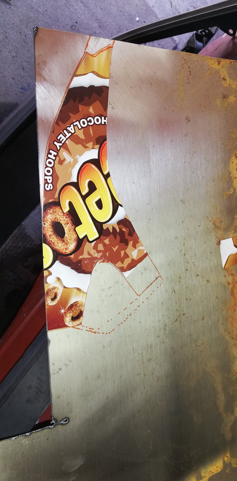

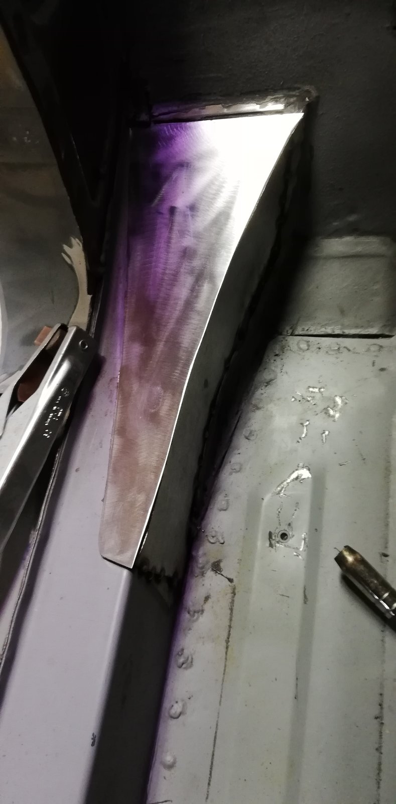

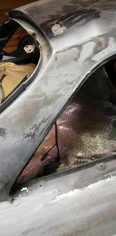

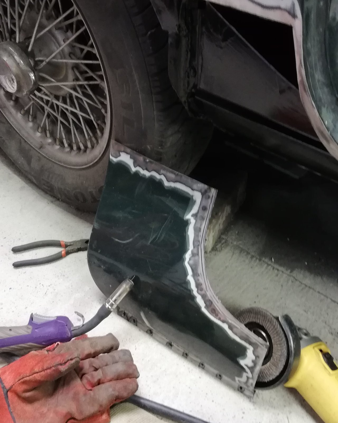

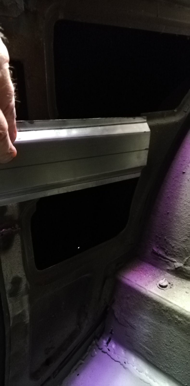

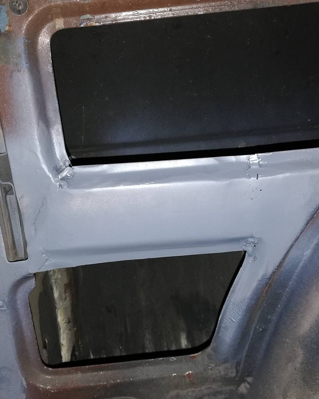

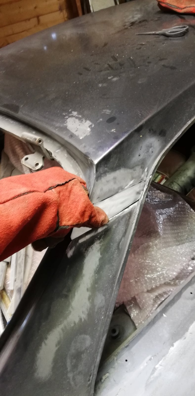

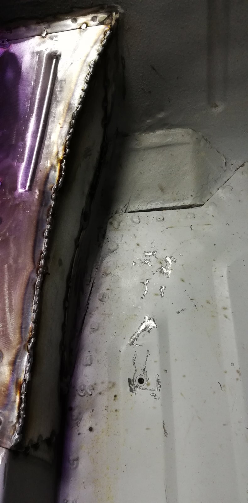

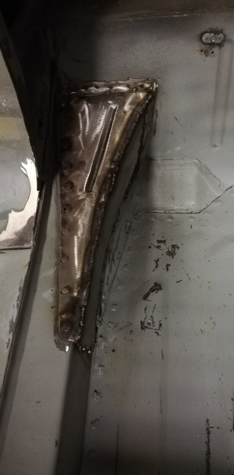

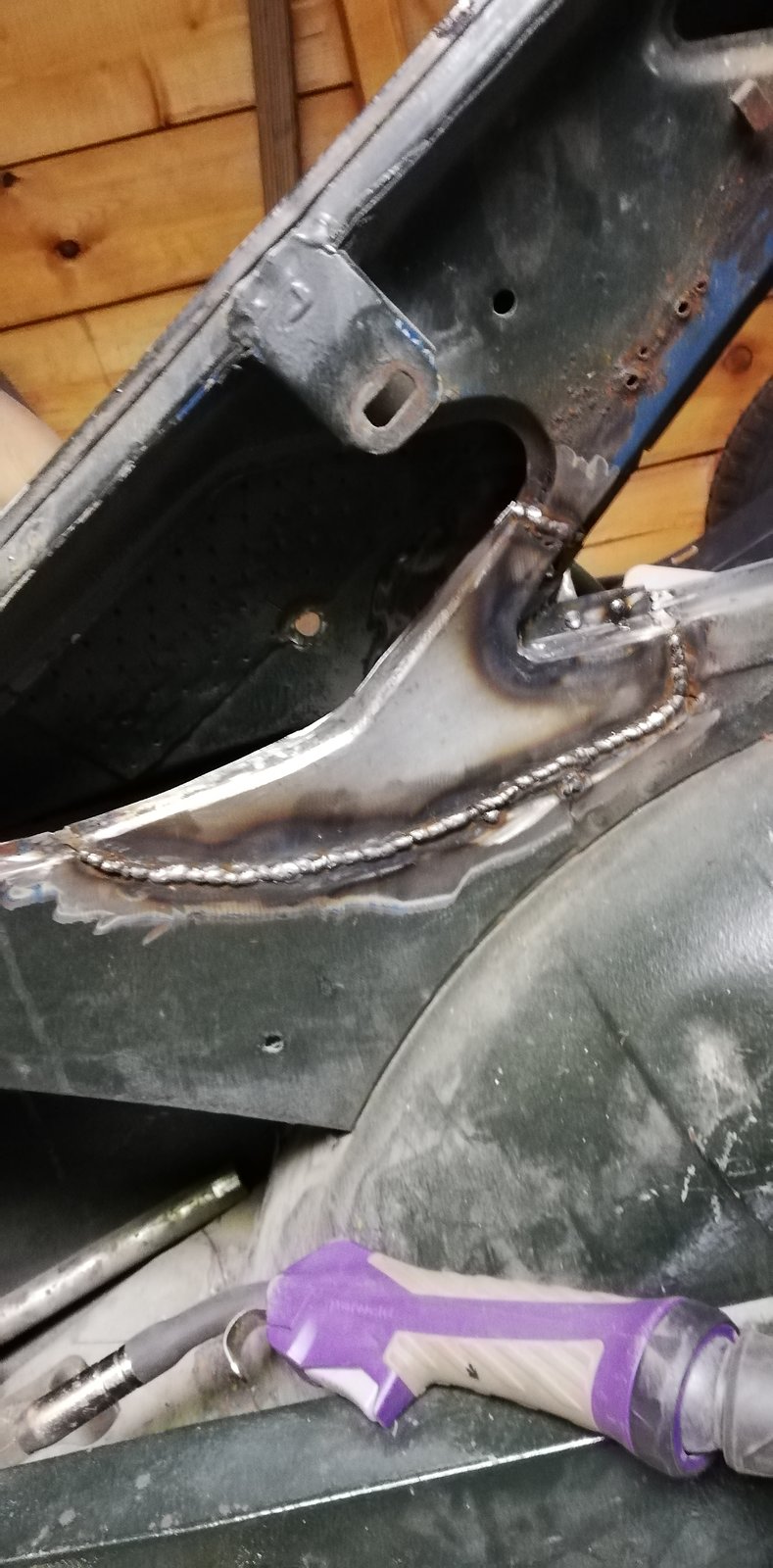

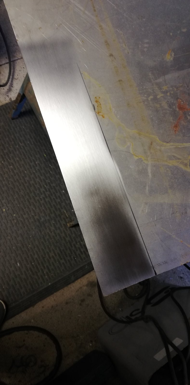

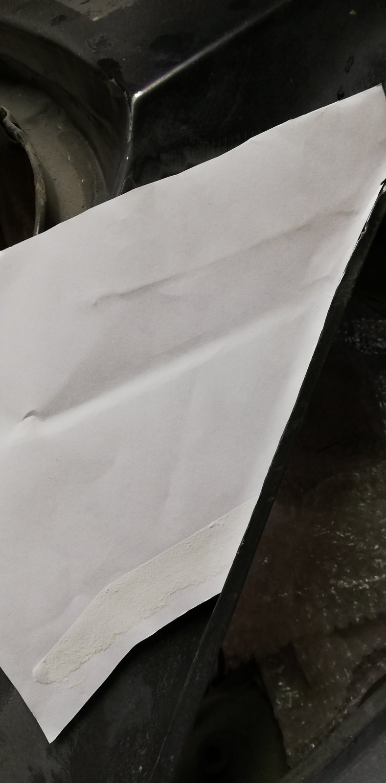

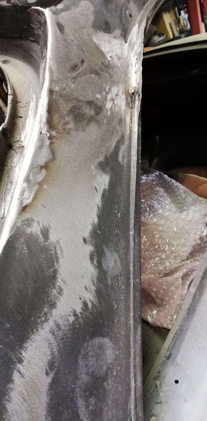

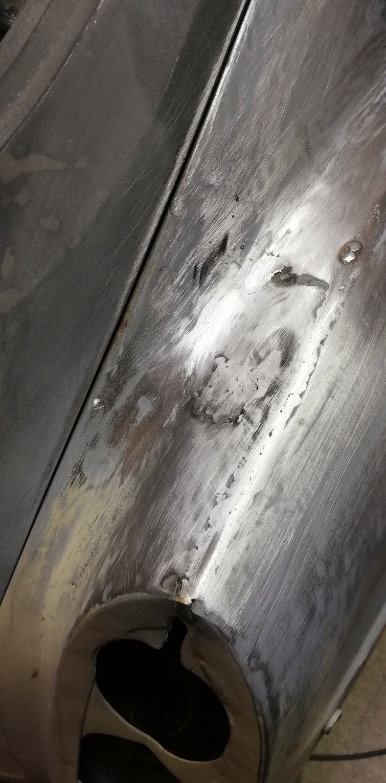

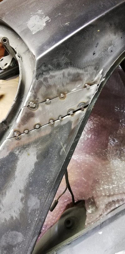

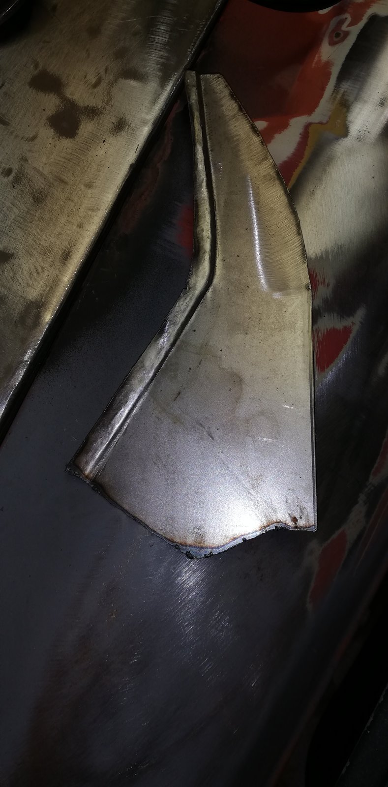

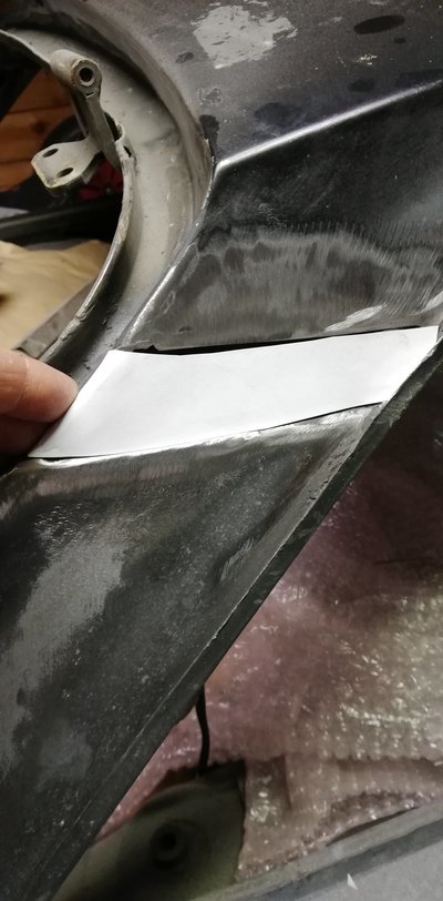

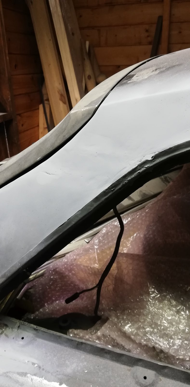

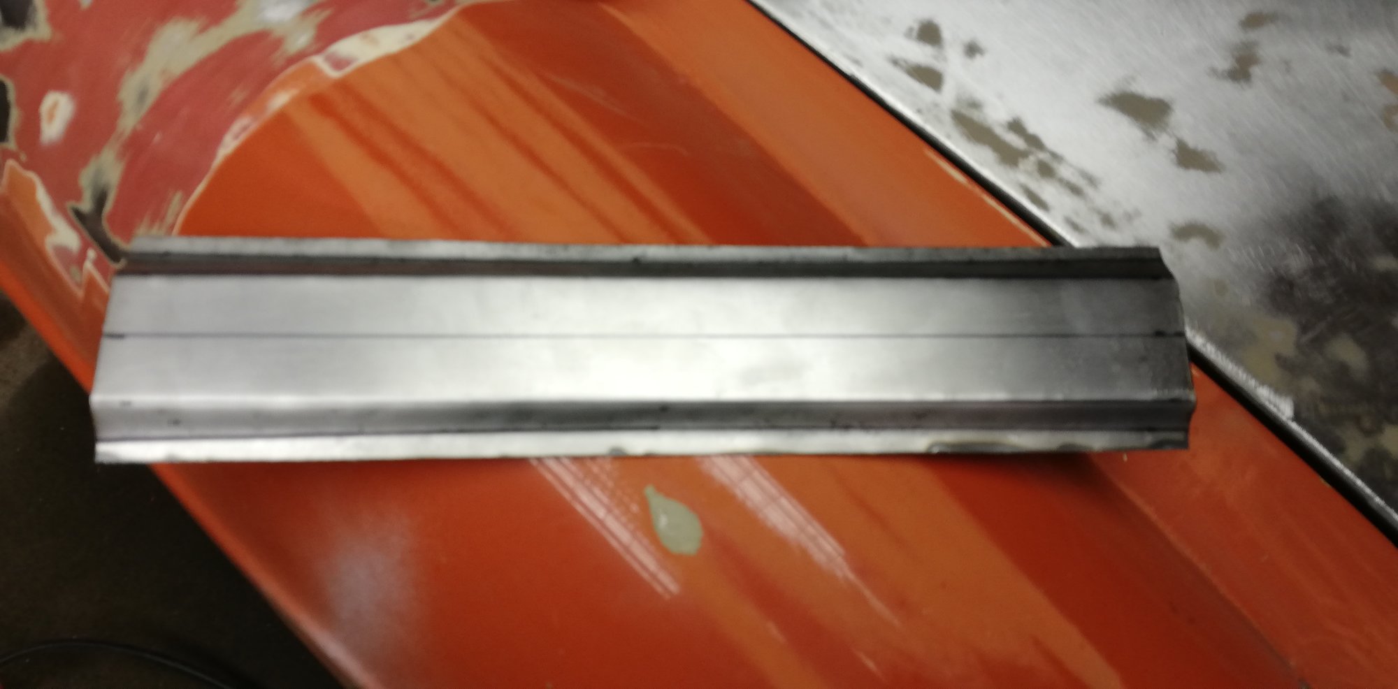

View attachment 232263 View attachment 232264 View attachment 232265 View attachment 232266 Started making the trumpet shaped cover that goes over the Sill near the rear bulkhead.
I have made it from two pieces as it curves in two directions.
Vertical curve first. Then used that to make a template of the top.
Not finished yet.
Appologies fit the purple lighting. I have a purple bulb in one of my lights in that part of the garage.

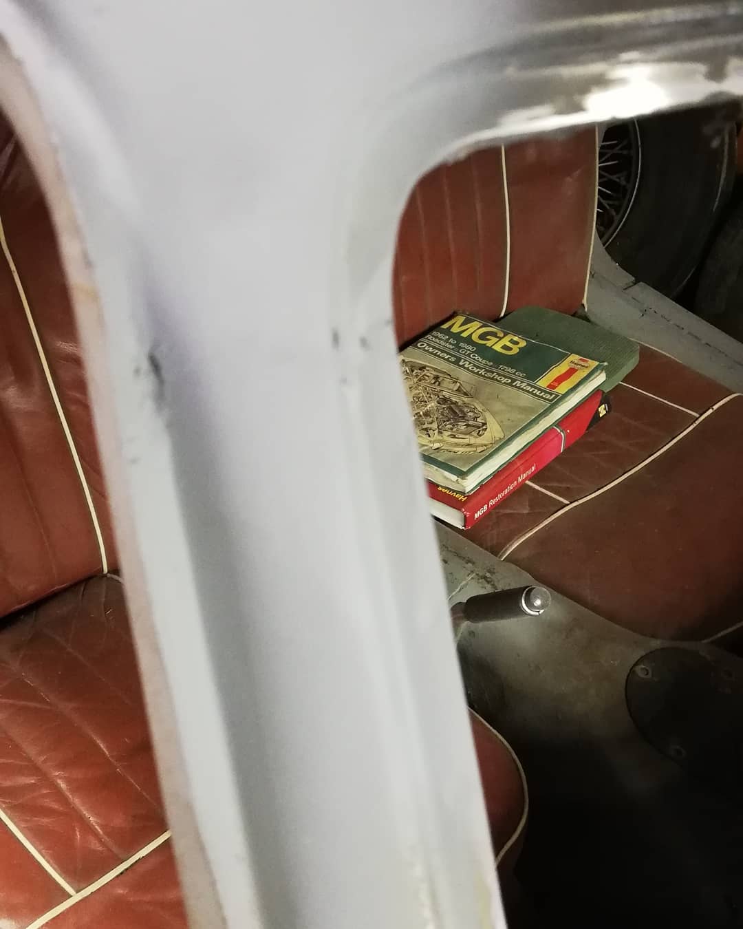

I think you're right. I have at least two copies of the Haynes restoration. One on the seat in the car.If you haven’t already discovered, this particular repair is covered in detail in some of the restoration guides.
Might give you some hints and tips, that’s all!![]()
Still forget to actually open it
