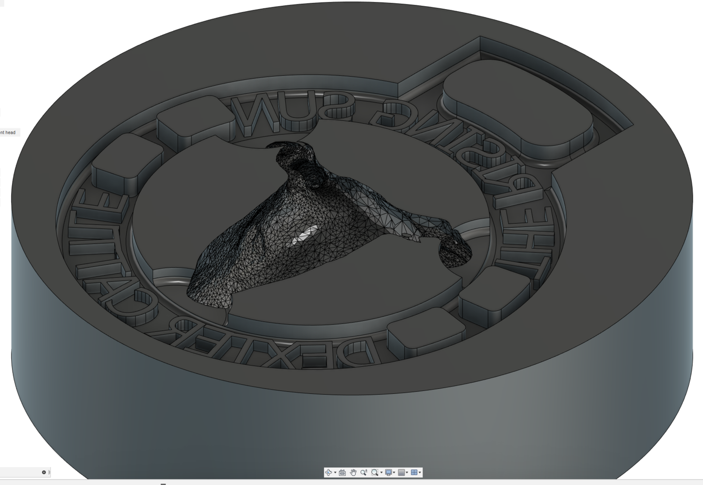

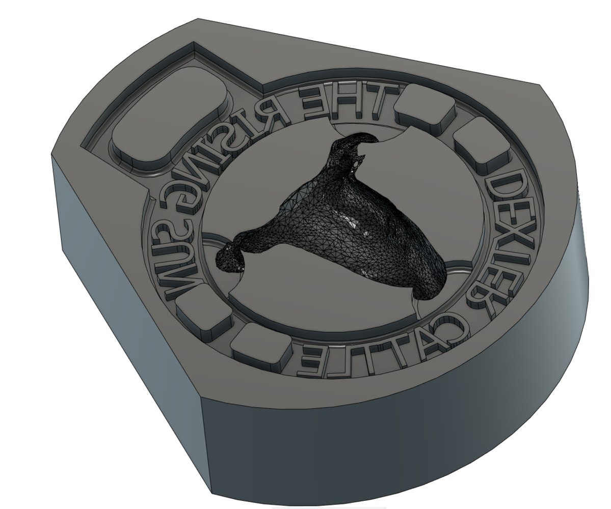

I've been touting round locally and even as far as Southend & Devon for brass casters and what they could offer as a quick service. No luck with what I want. Tbh I'm not really sure what I want, somebody to take our 3D printed models and do the investment then pour or we do the investment and give to them?
If we do the investment casting here then I think a vacuum chamber build is a must to get the air out. This investment powder I have here is supposedly air permeable hence suited to the vacuum process very well.
I think in reality I need to consider an electric furnace build. To then use as a burn out oven, my lad reckons he could use a Pi or similar to make a suitable, programmable controller instead of spending out £££ on a CAL 9500P.

.I think PLA is our best shot. If you send me a PLA print I'd firstly make up a sillicone mould and try wax, and then try burning out the PLA in plaster or sodium sillicate sand. I have some normal plaster to mix with sand or you could send a small amount, it wont need much.@Kram , seriously, how are you fixed for doing this pour? Would the investment survive posting or would I need to careful transport it and drop it to you?

I think PLA is our best shot. If you send me a PLA print I'd firstly make up a silicone mould and try wax, and then try burning out the PLA in plaster or sodium sillicate sand. I have some normal plaster to mix with sand or you could send a small amount, it wont need much.
I could use one of those test print bits you sent to test with before hand.
