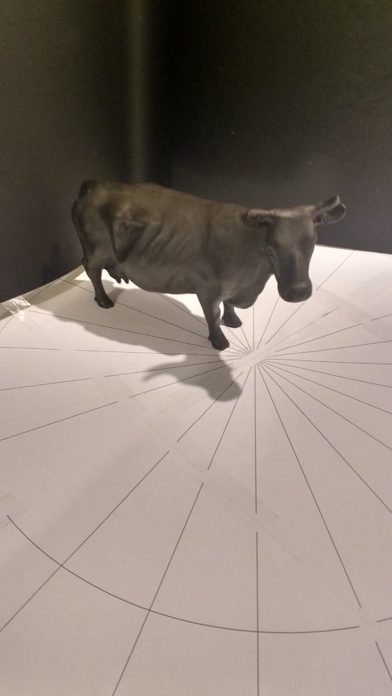

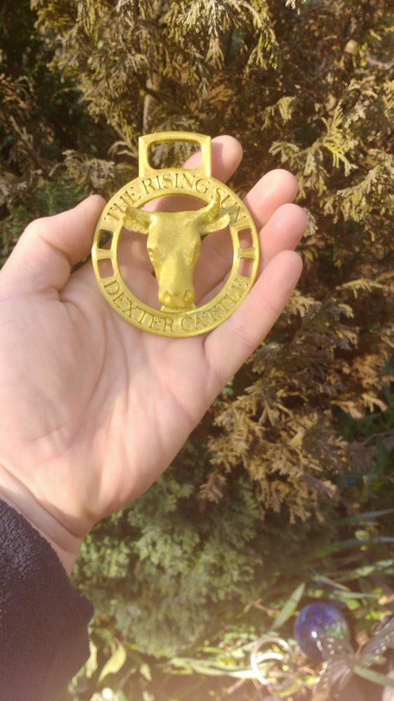

Shadow doesn't help you need diffuse lighting. Put sheet of white paper Infront of the light sources....Emboldened by two pints of Henry Weston's last night, my lad brought a cow home from the pub (he did ask nicely).

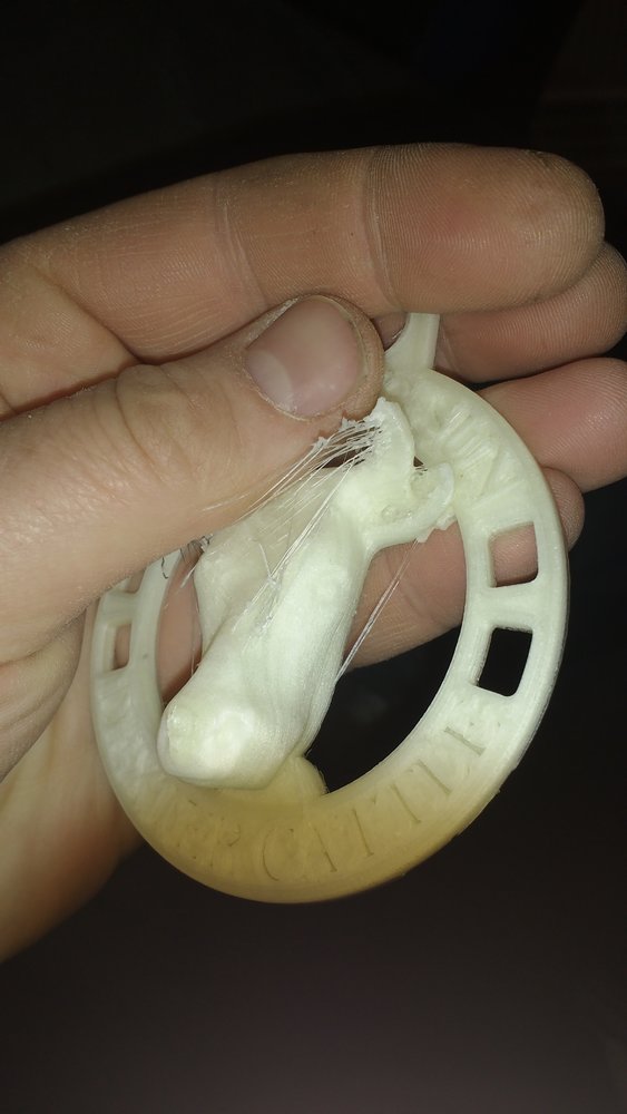

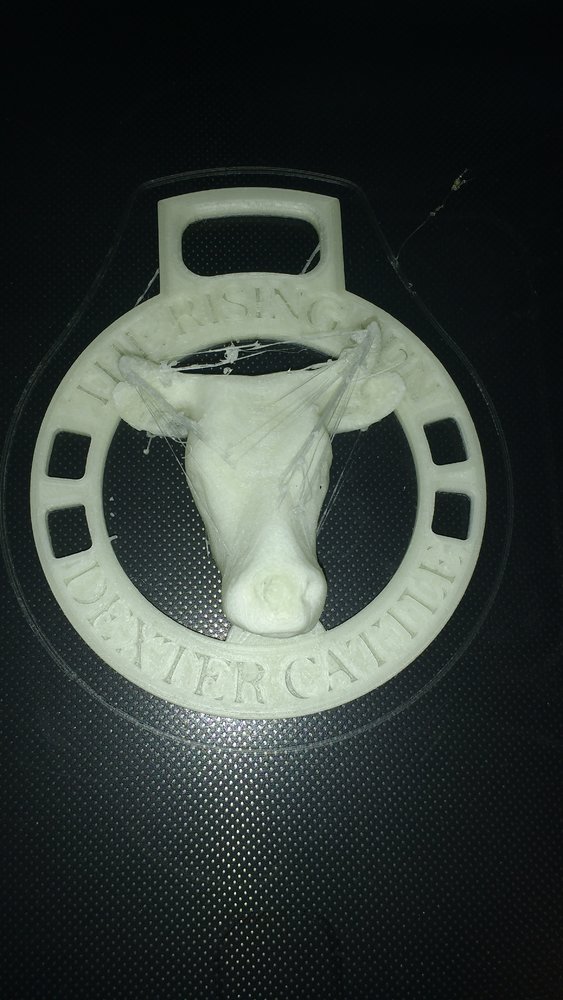

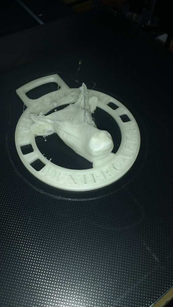

I quickly knocked up 6 sheets of A4, taped together, with segments marked at 15 degrees.
Took 24 photos around the perimeter, 12 from above and 12 from below.
Ran through Zephyr.
Didn't work!
The lines may be confusing things too as the algorithm can't differentiate between them. Try putting a different symbol on each line too. Or number them or something.
