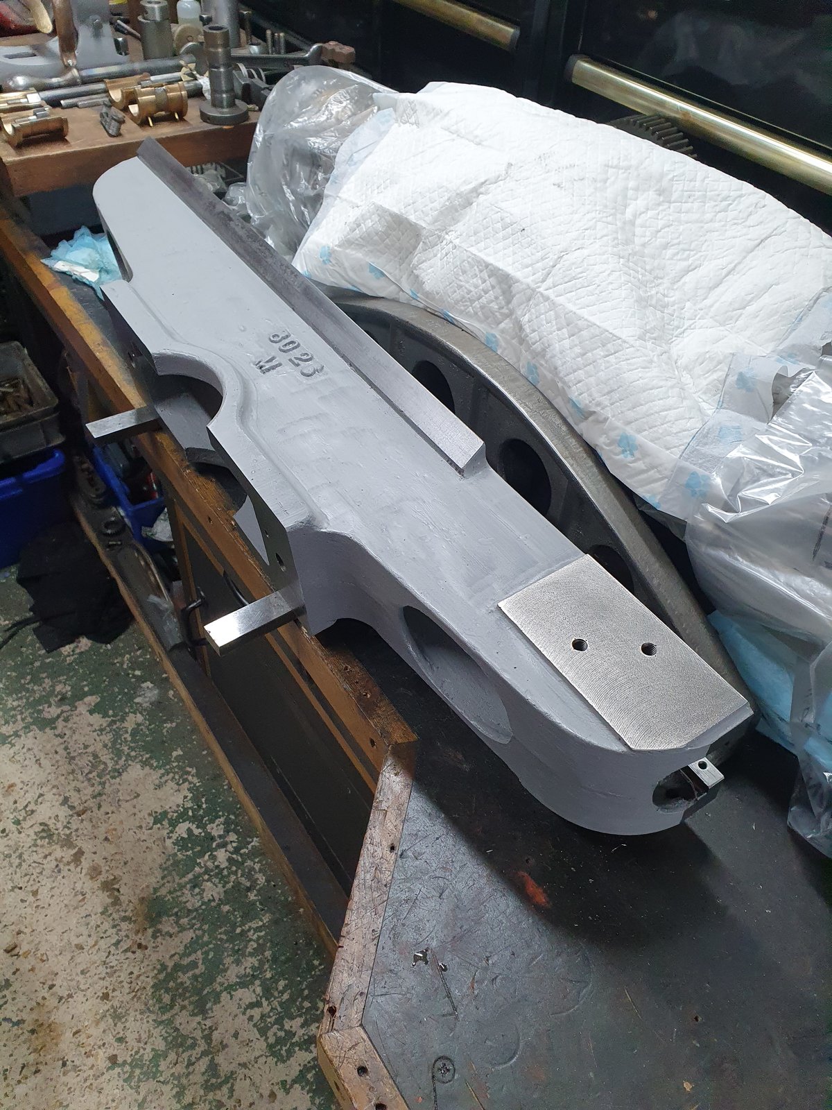

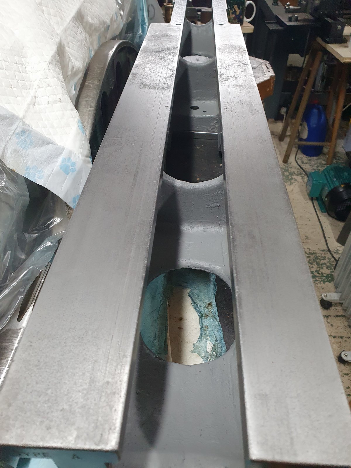

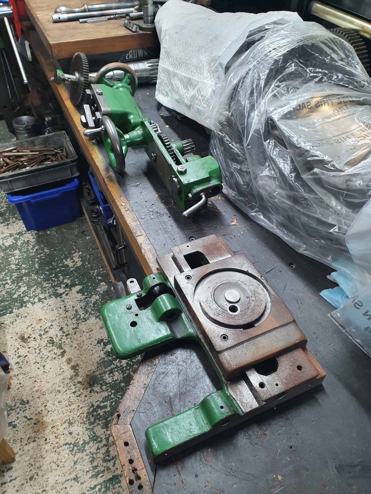

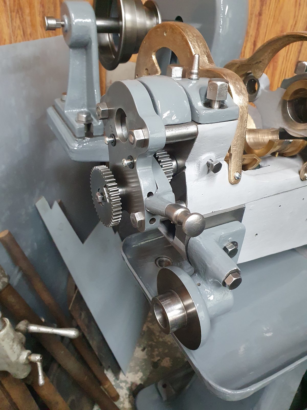

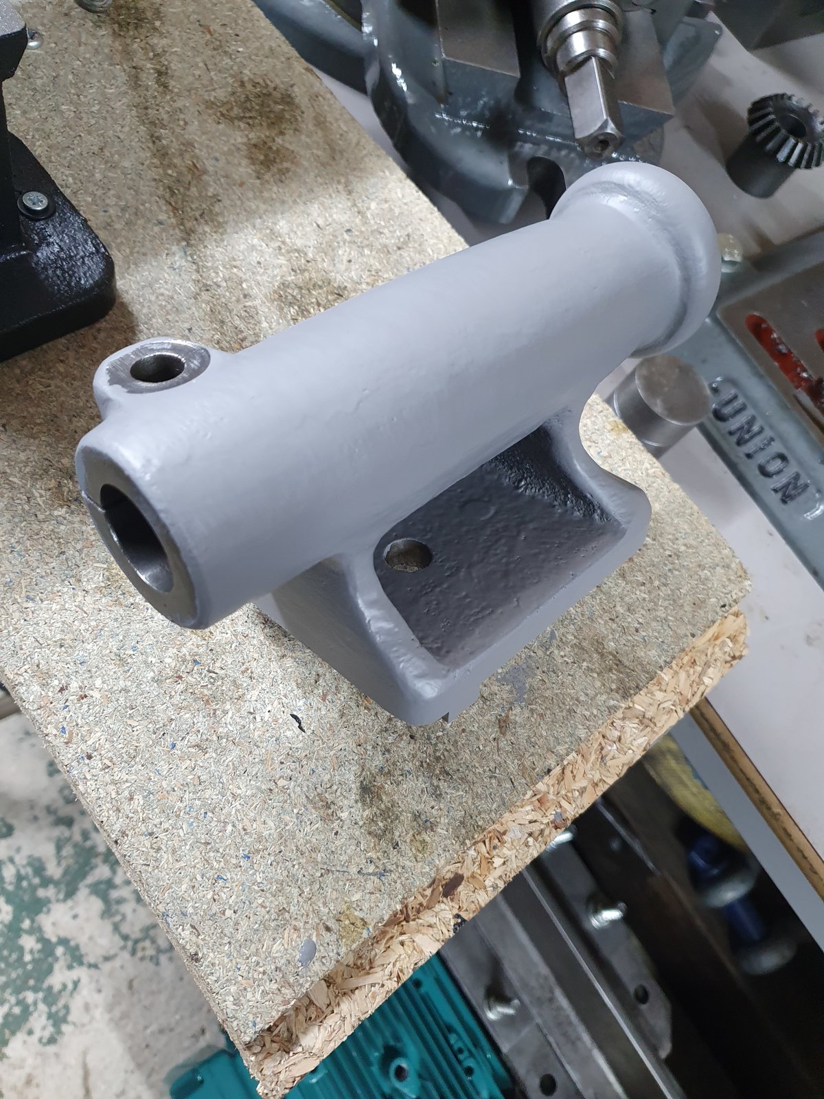

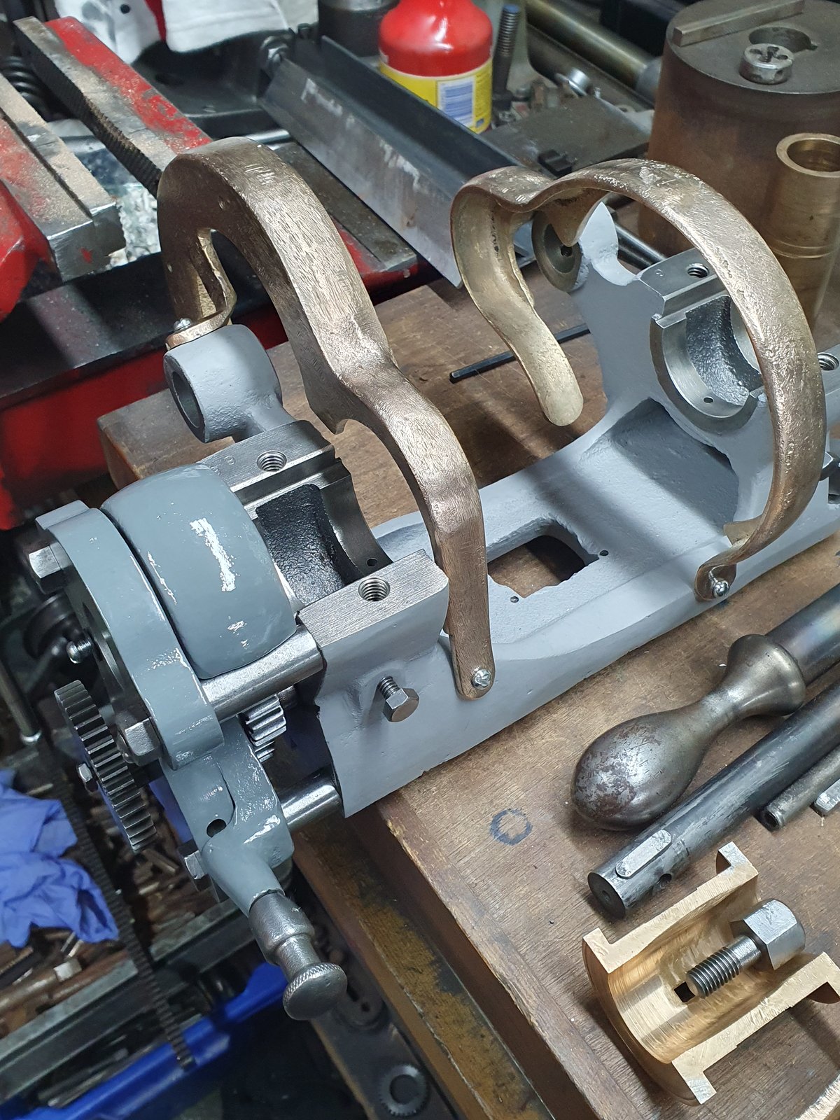

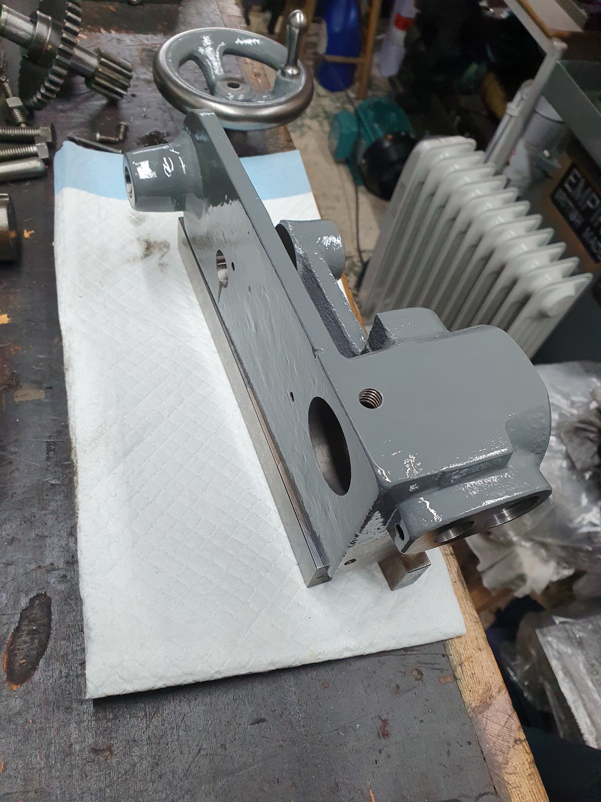

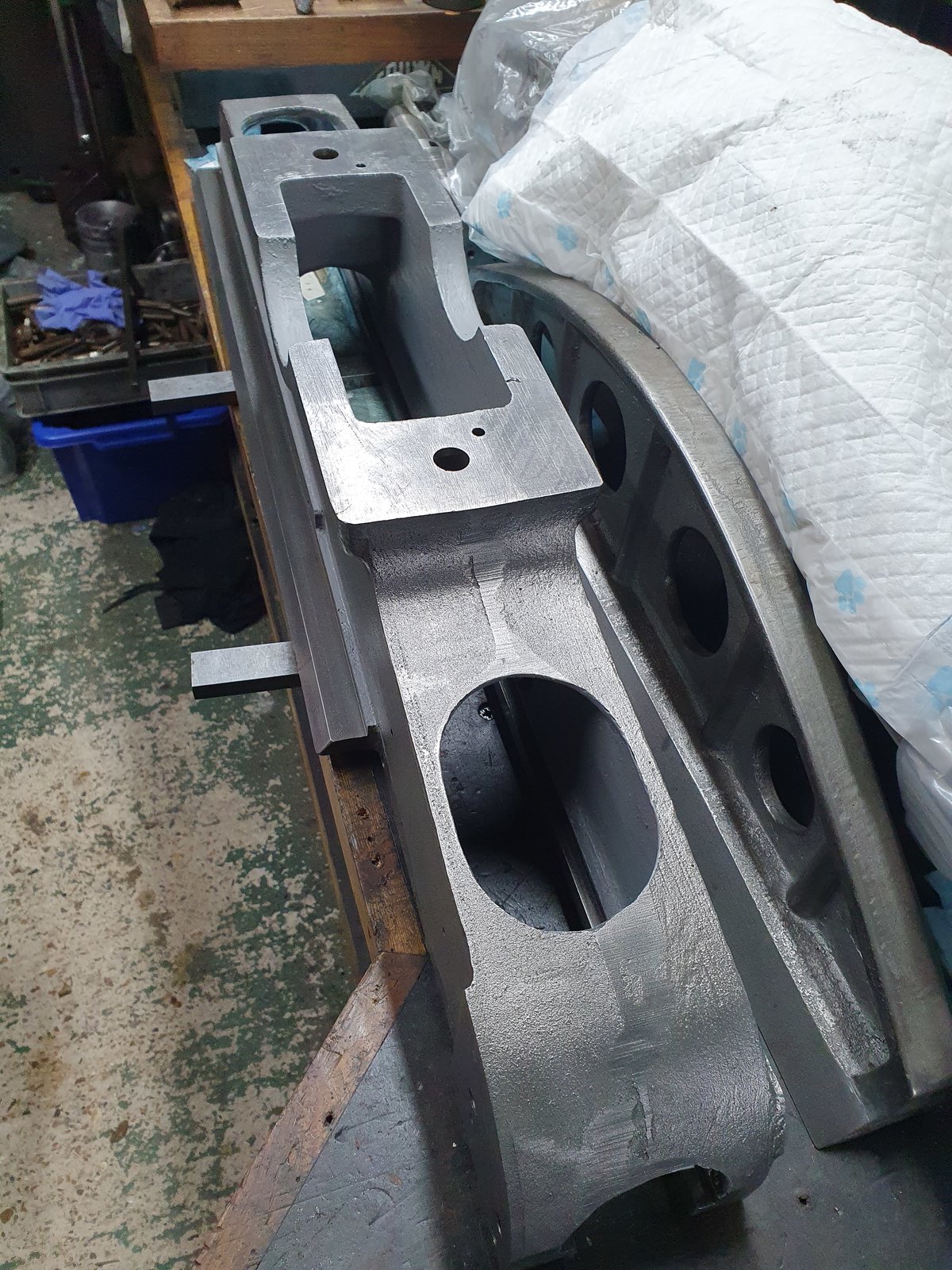

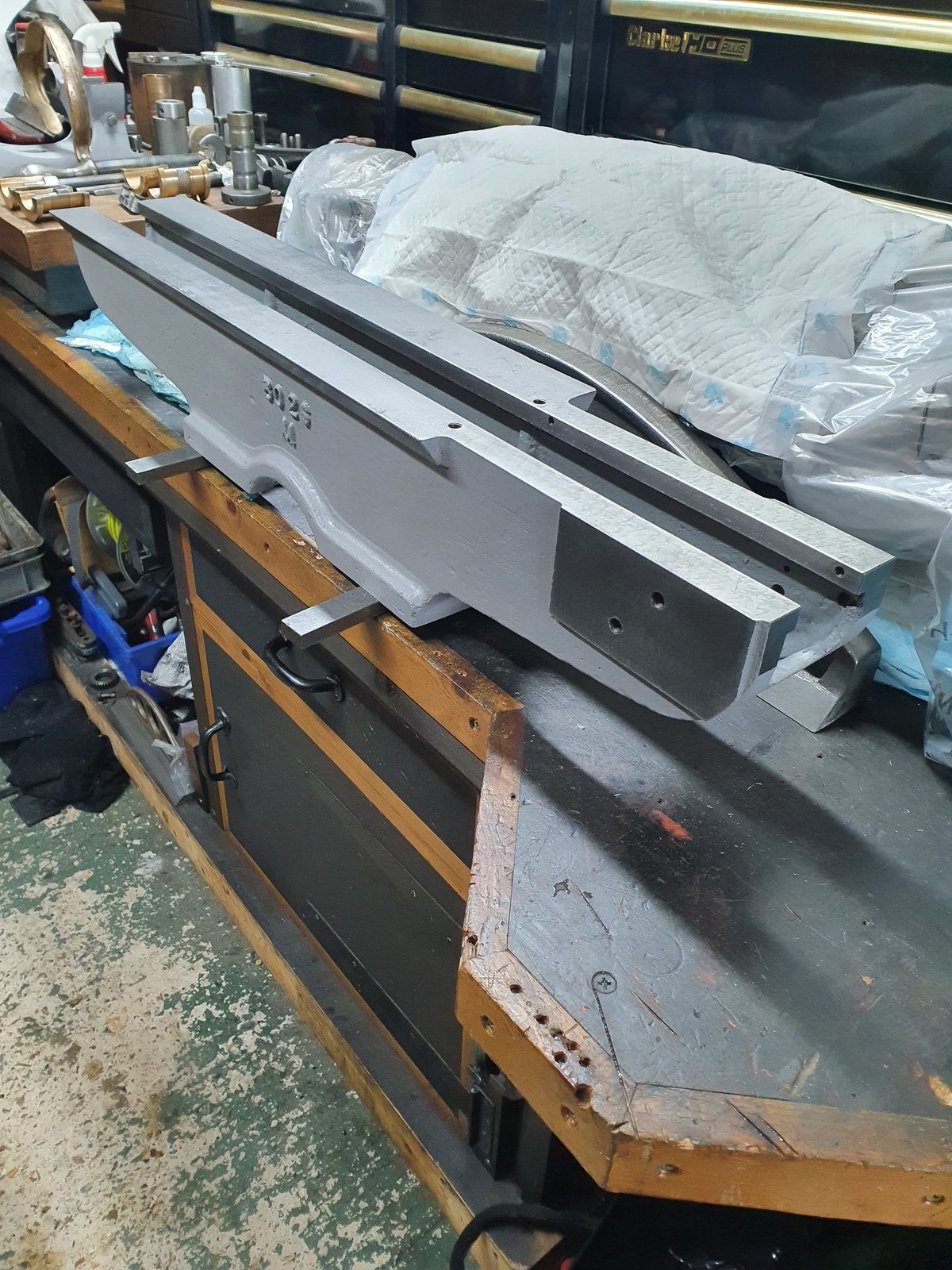

Inside primer sorted....

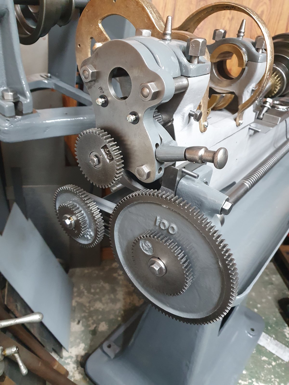

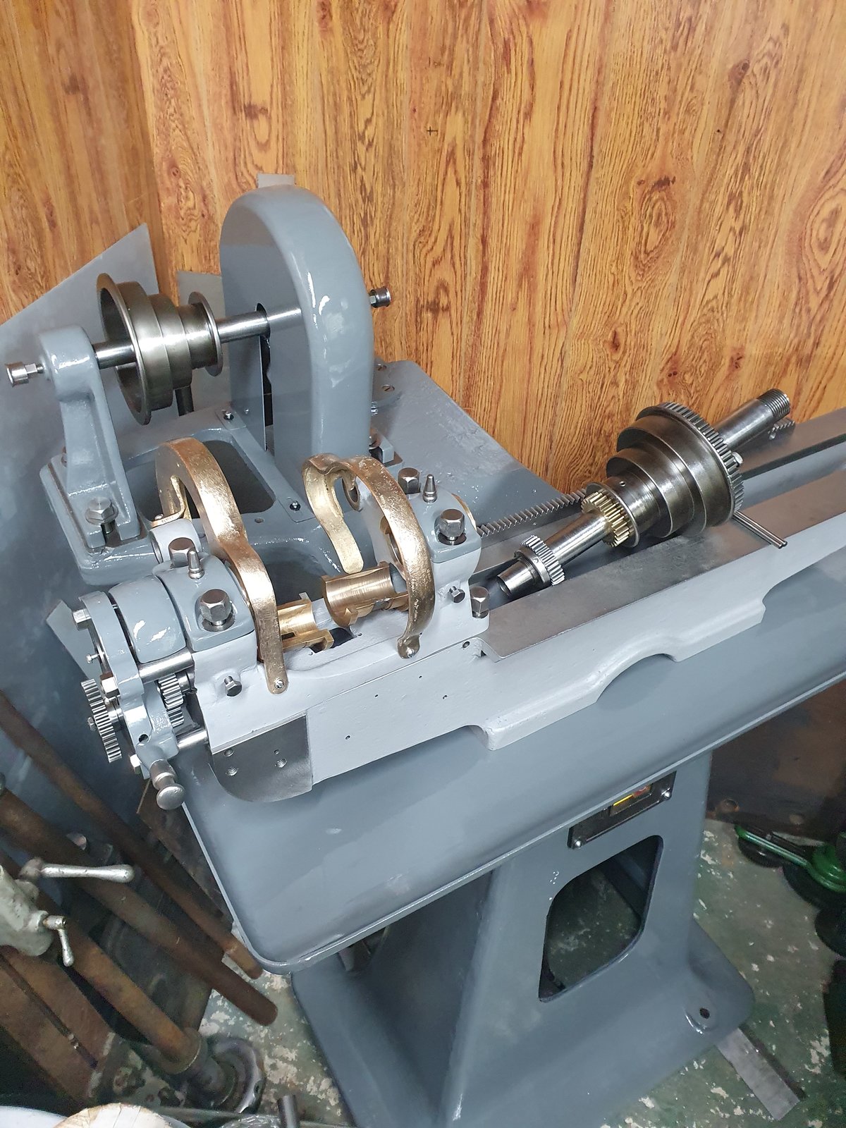

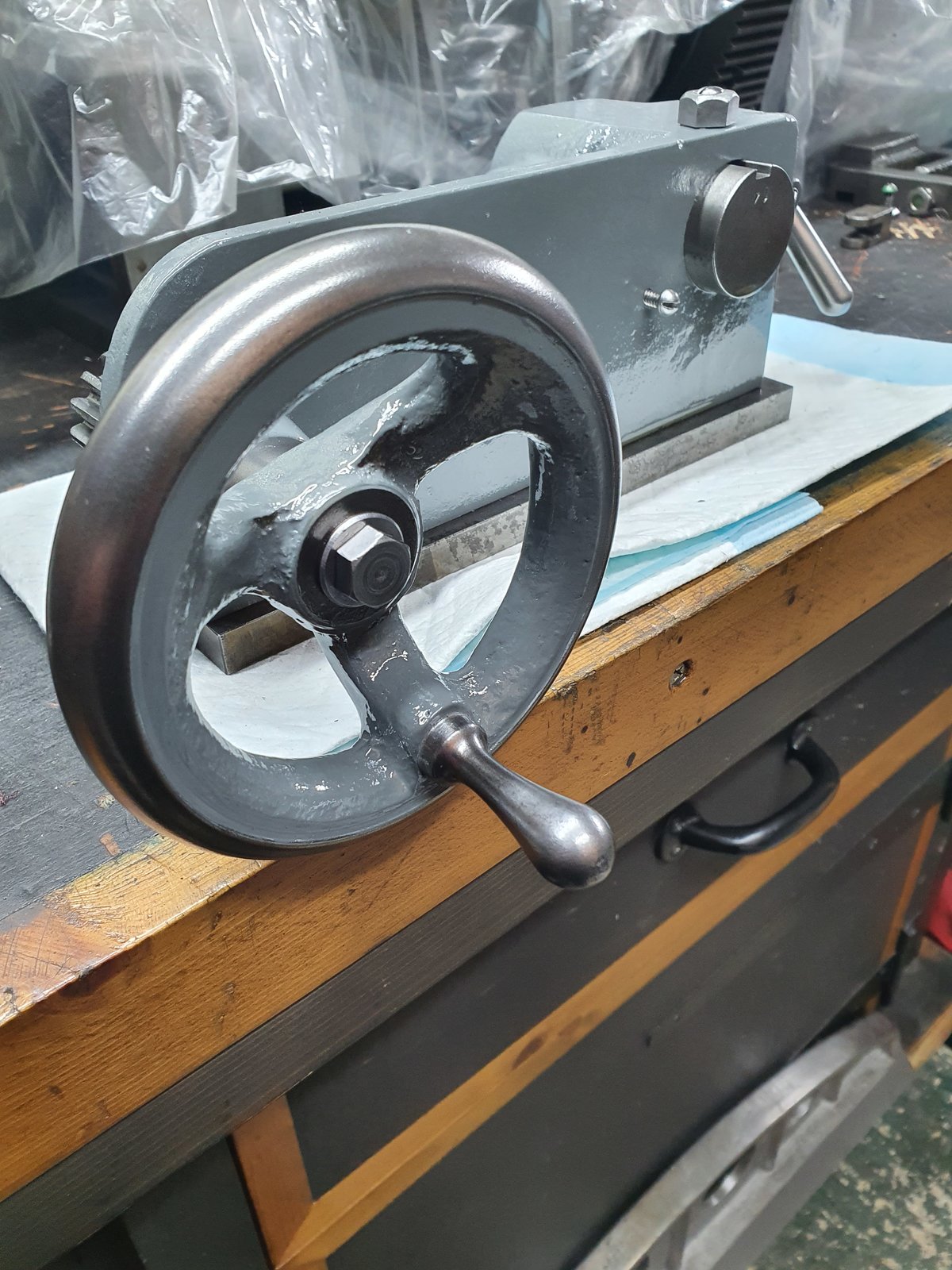

Thanks Colin. ..getting them scratched is part of it . My empire lathe is full of scratches and still haven't finished it yet...it's an enamel top coat...all hand painted. ..I don't use a gun.Hi,
I'm mightily impressed so far with your restoration spencer it's coming along a treat and will be a wonderful lathe and friend once completed.
I love old machines that Whitworth spanners are used on; these machines generally were made to a very high standard lasting many life times unlike many modern machines computer controlled which cost a fortune if the electronics die. You'll be scared of scratching it once it's fully completed. Top class work; well done.
What paint are you using and what type of spray gun?
Kind regards, Colin.

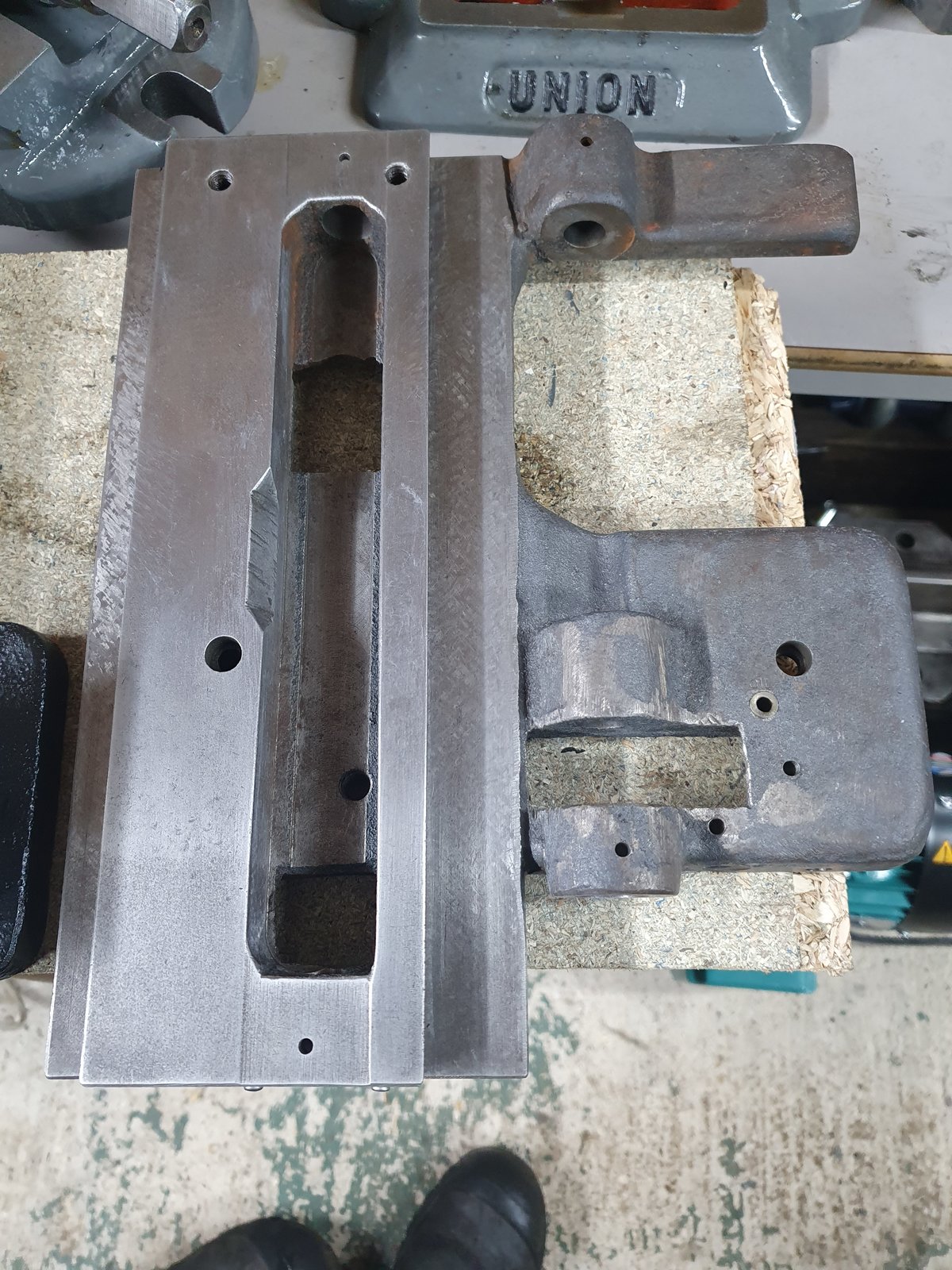

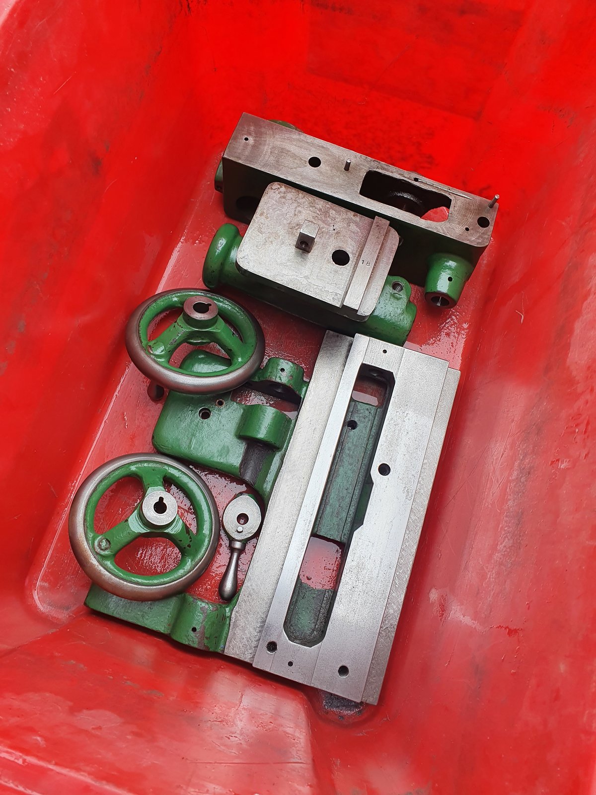

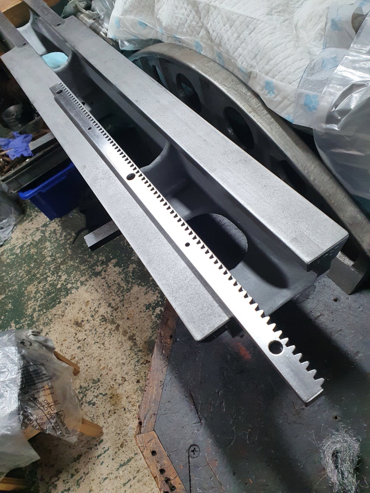

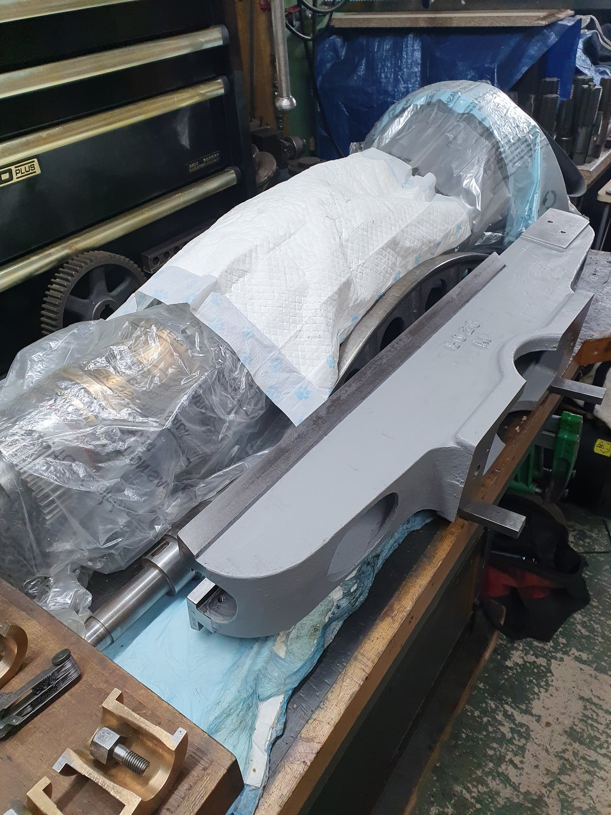

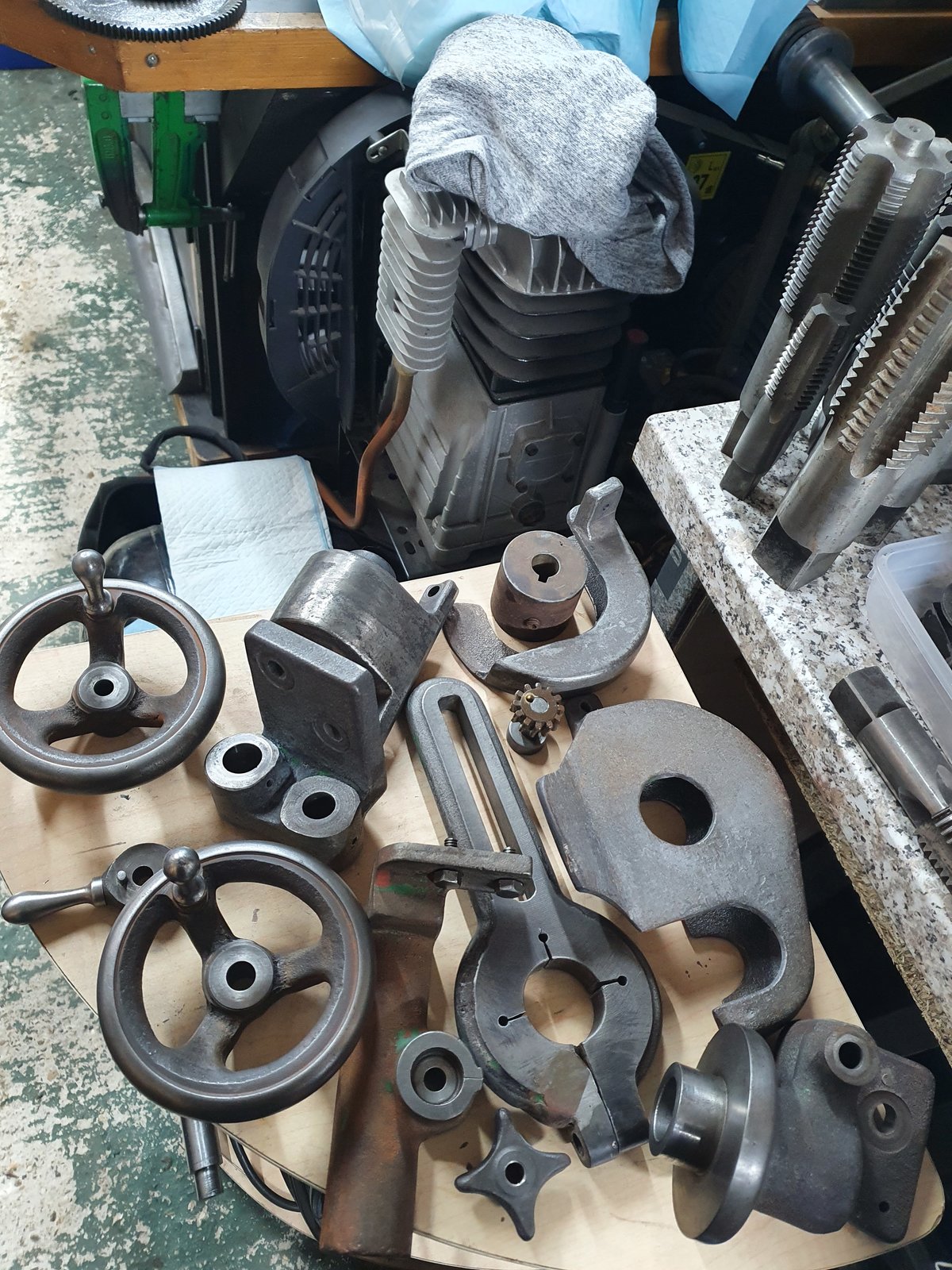

It could be be done on a rockford. But I have other bits to do so it's just as easy for me to do it here.@spencer 427 surely this is a candidate for the "Rockford" or is it that close that a hand scrape is easier ?

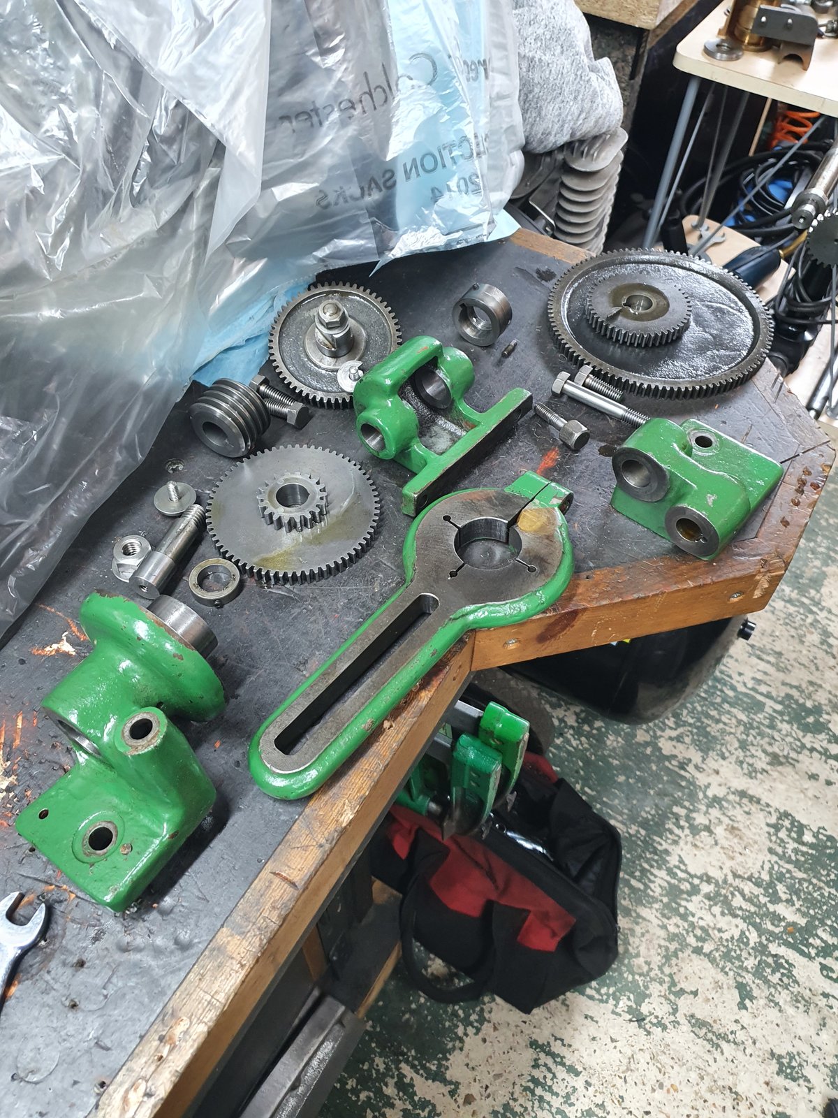

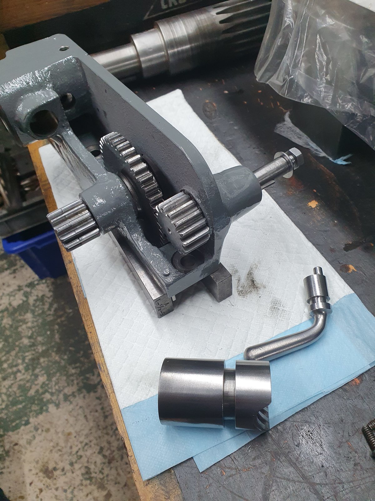

Yes. It's a 47 percent mix of caustic. ...Absolutely stunning job as always
Do you put them in caustic or something to strip them of paint ?

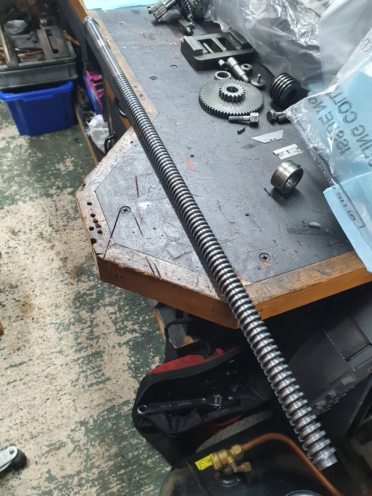

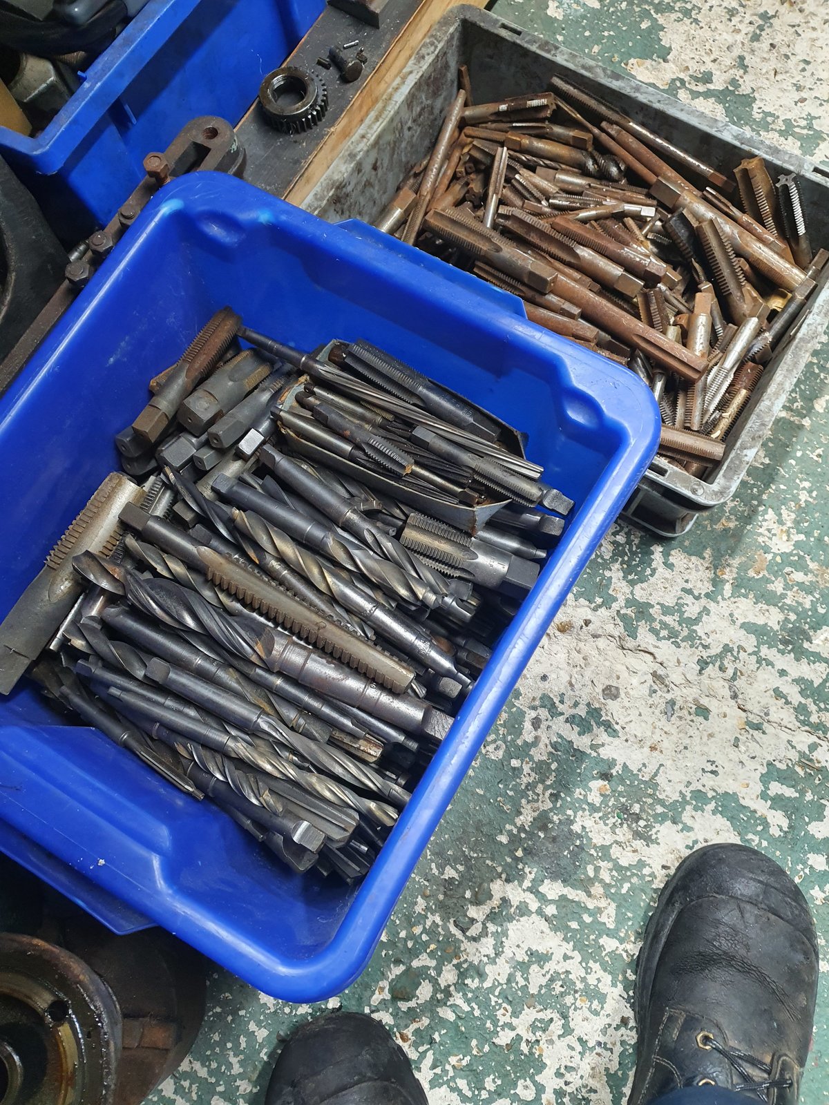

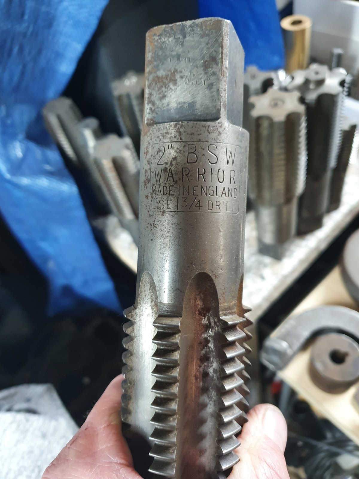

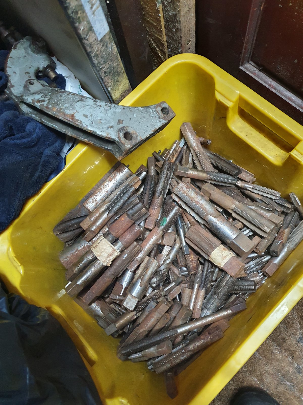

Those are bsw and bsf. There is some big ones amongst this lot I got sort out.Curious as to the thread sizes of the mahooosive taps on the bench?
I recognise those!Those are bsw and bsf. There is some big ones amongst this lot I got sort out.View attachment 263498 View attachment 263499 View attachment 263500
