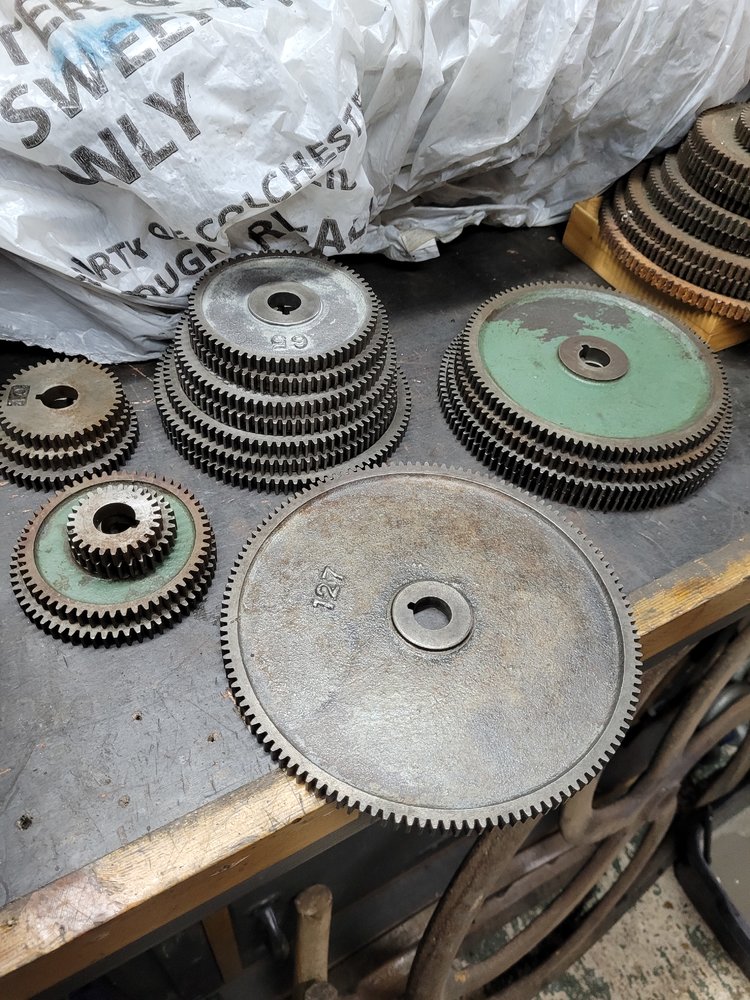

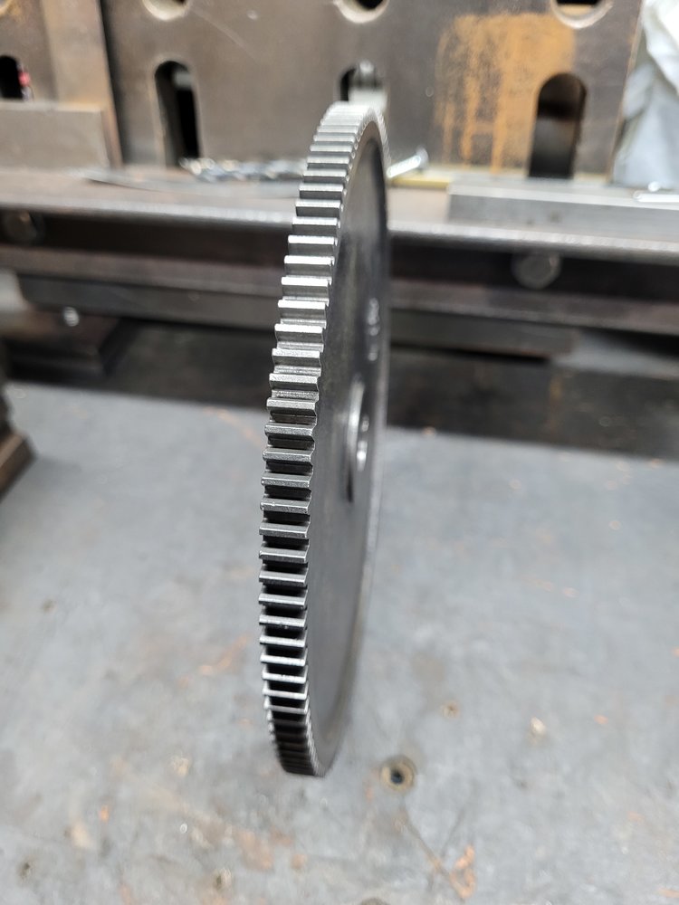

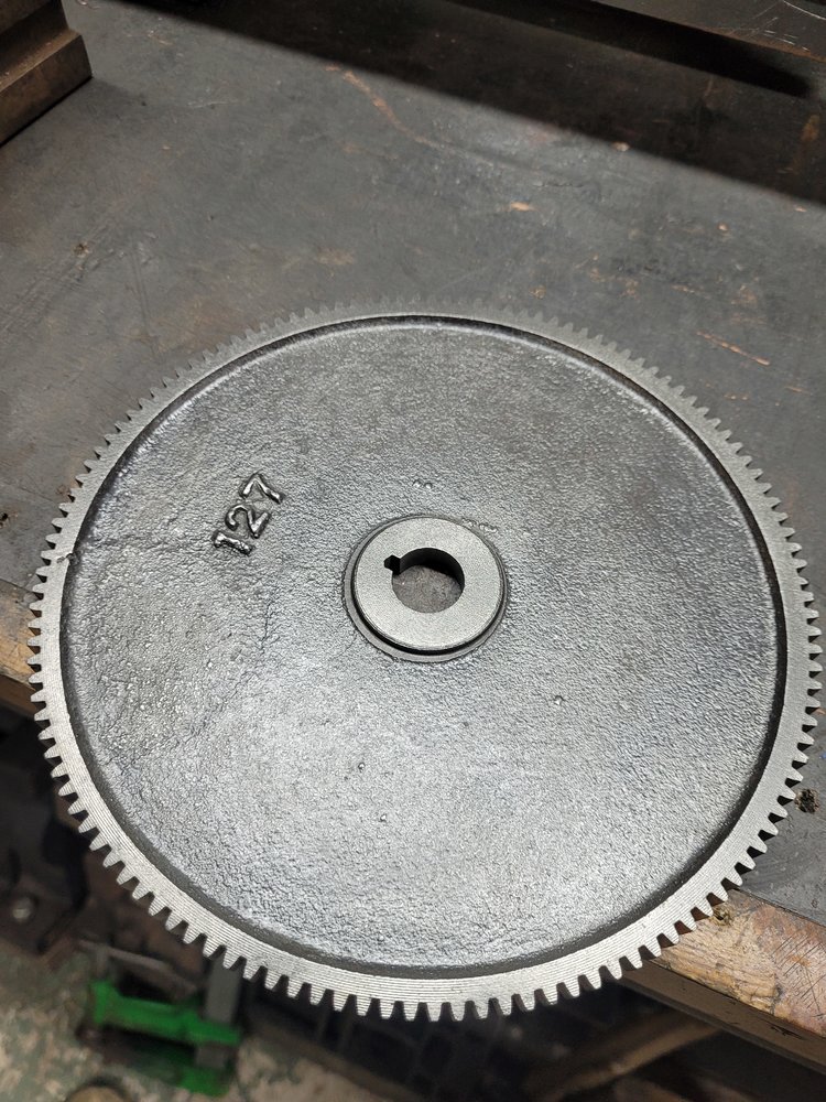

Today. Made a start on clearing the mellor lathe gears and prep for primer
View attachment 440255 View attachment 440256 View attachment 440257
Yes mate . Metric conversionIs the 127T a metric conversion gear ?
Very nice restoration by the way
