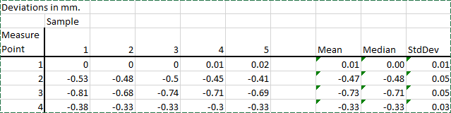

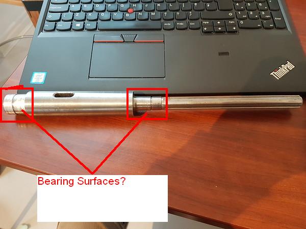

I have found that the quill has been bent in use at some point. There is about a 0.95mm deviation from one side of the tip to the other when rotated 180 on a flat surface (photo to follow). Any ideas for straightening?
I'm thinking about mounting it back in the shaft to hold it and then applying a gentle whack or two with a mallet. Unfortunately I don't have a lathe (or drill press yet) to hold it in to apply a more exact method.
