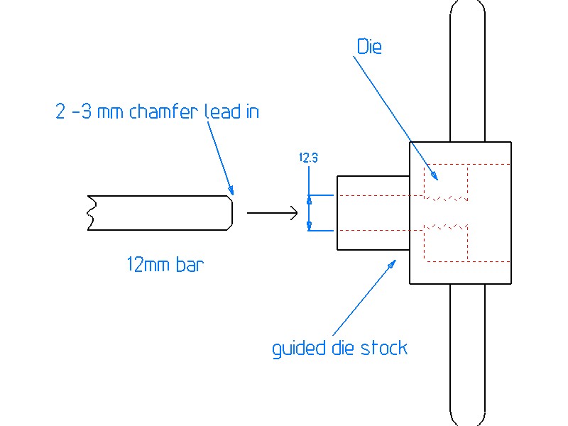

good idea but it would pull the guts out of a cordlessId make a die holder up to fit in a cordless drill.
I use a cordless for tapping M12 all the time. Its a decent one, in low gear mind.
They're cheap..........I just tried manually running a 1/4" BSP die down a piece of 12Ø MS round bar, and it barely scratched the surface let alone cut a decent thread.
Those die holders pictured above look the business ............ would anyone care to turn me one up? ...... beer tokens are awaiting
25mm internal depth clearance from the back of the die, 3 grubscrews for the die, 3 side slots to clear swarf and a 12m hex shank (with one end turned down to say 10Ø and then welded into place from the inside of the adaptor).

This second die will be my M12 X 1.75 X 1½” in a suitable handle: alas the 1½” die holder that also arrived this morning has a 16Ø hollow shank and although it allows 12Ø bar to fit through it will not fit into the 13mm chuck of my cordless drill.
