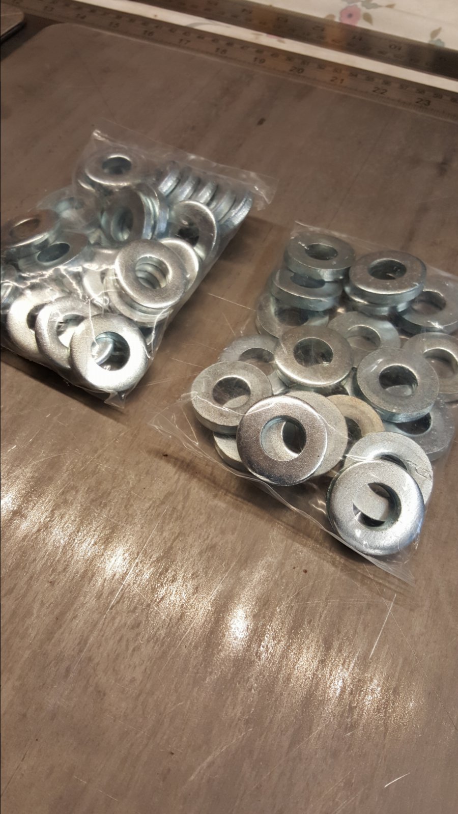

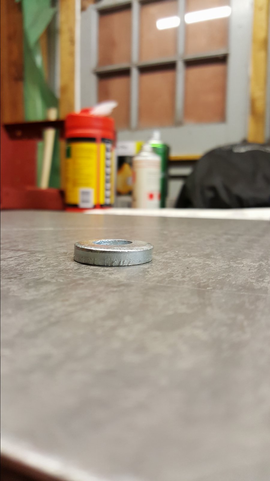

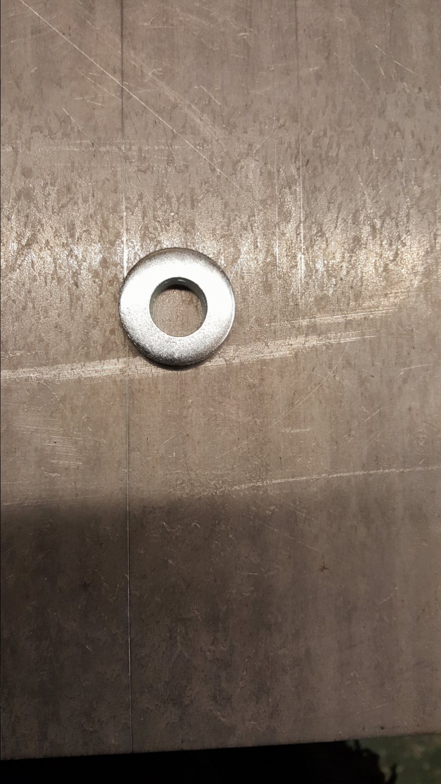

So if anyone would like to machine me 10 washers. M12. 50mm OD . 5mm thick. I would be very happy. Cash waiting of course.I no this sounds picky to some but the washers I oredered ain't what I would call quality. They are slightly off centre and have no uniform at all. View attachment 92569 View attachment 92570
Not exactly a precission product are they, at 5mm thick I would have expected them to have parallel faces. I suppose the hardened washers you find behind cylinder head bolts would be too expensive ?Sometimes if anyone would like to machine me 10 washers. M12. 50mm OD . 5mm thick. I would be very happy. Cash waiting of course.
