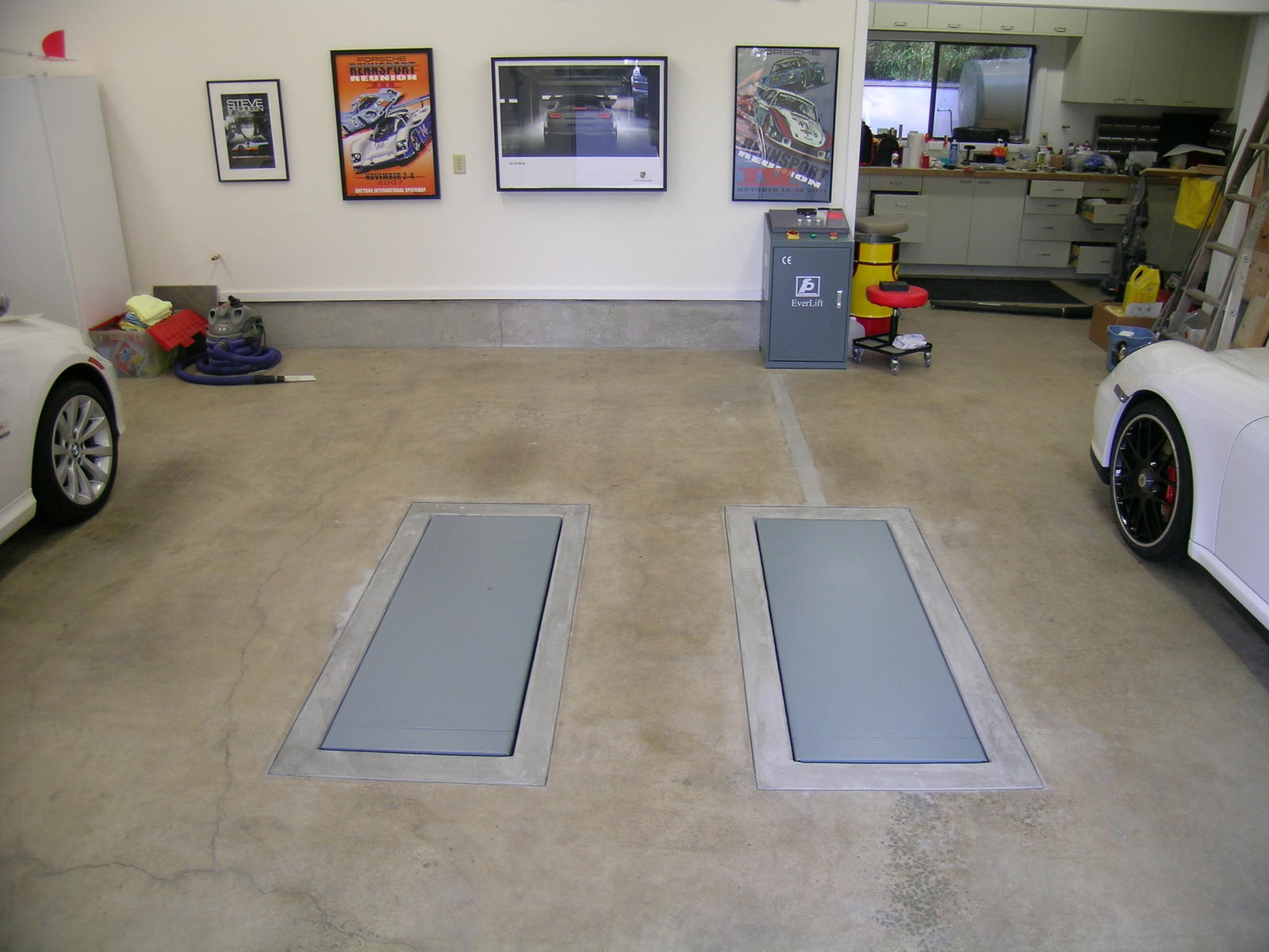

I blew mine out with the airline on my mobile comp or you could use a desk fan or similarGenuine question, once a pit had filled with propane/fuel vapour/whatever other nasties, how would you empty it? I can think of a way with a fast set of running legs and a match but how would you safely do it?
That's a good idea. Thanks for that. I was working on the assumption of them being filled for good, if they were filled at all. I could get a truck with a hiab to pretty much put a few bulk bags down right next to them.if you want to keep them, but still make them safe, you could fill them with building sand and board across them now, it's cheap enough, that way you close them up, so they're safe, but you'll still have the option to reopen them easily at a later date should you change your mind..
Filling would be really quick. If I can get the bags close enough, a Stanley knife will be pretty much all I need. Agreed, digging them out would be a bit more of a chore. Still a great idea though. Building sand is a good call too. Imagine trying to dig out ballast, sub-base or anything stoney with a shovel once it's sat there compacting itself for a few years.filling will be easier than emptying, but a few mates, a few shovels and a few crates of beer (encouragement) should get them empty pretty quick too....
Or x amount of cans of expanding foam.scrounge a load of polystyrene blocks or sheets and fit them in
Displace it with something. Water would do, as long as it would have somewhere lower to go once it was displaced. You could chuck half a dozen health and safety consultants in the hole at a push.![]()
