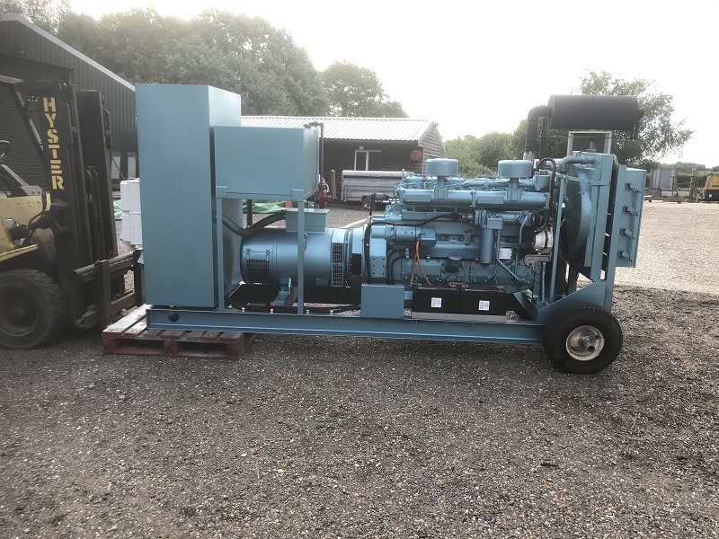

You can always make a construction like the attached picture where I am pushing a few tons of generator into an awkward corner
