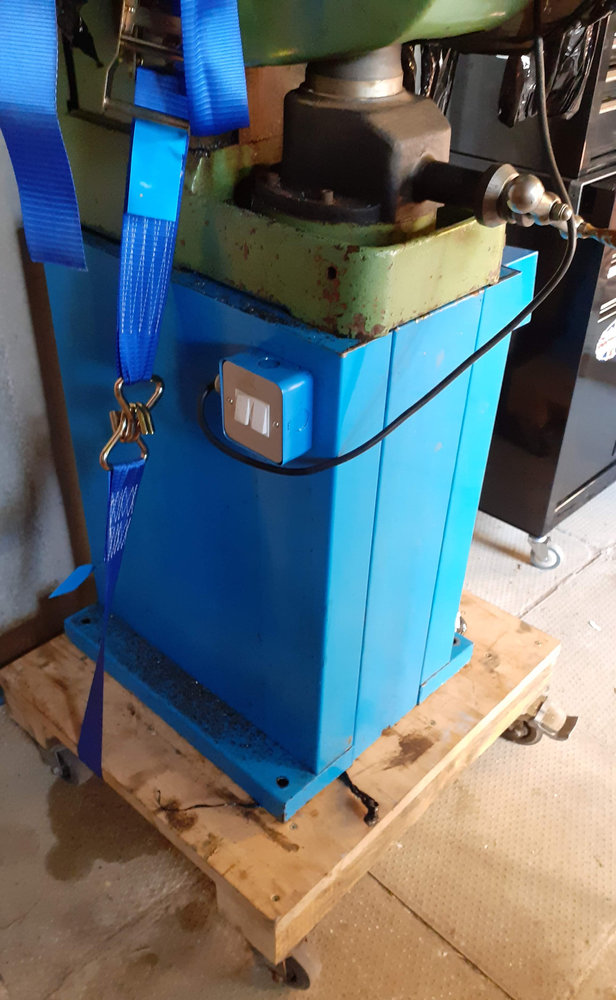

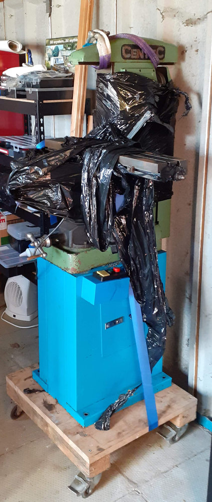

My Center is the smaller version of this, 2a not 2b, I stripped the large pieces off and then it was relatively easy to move about on my own. There are some pics in one of the threads.You mention a Centec, they are easy to move. My wife and I moved this one on our own with an engine crane and strapped to a home made dolly. Note the position of the purple lifting strap as that is recommended in the manual.
View attachment 318367View attachment 318366

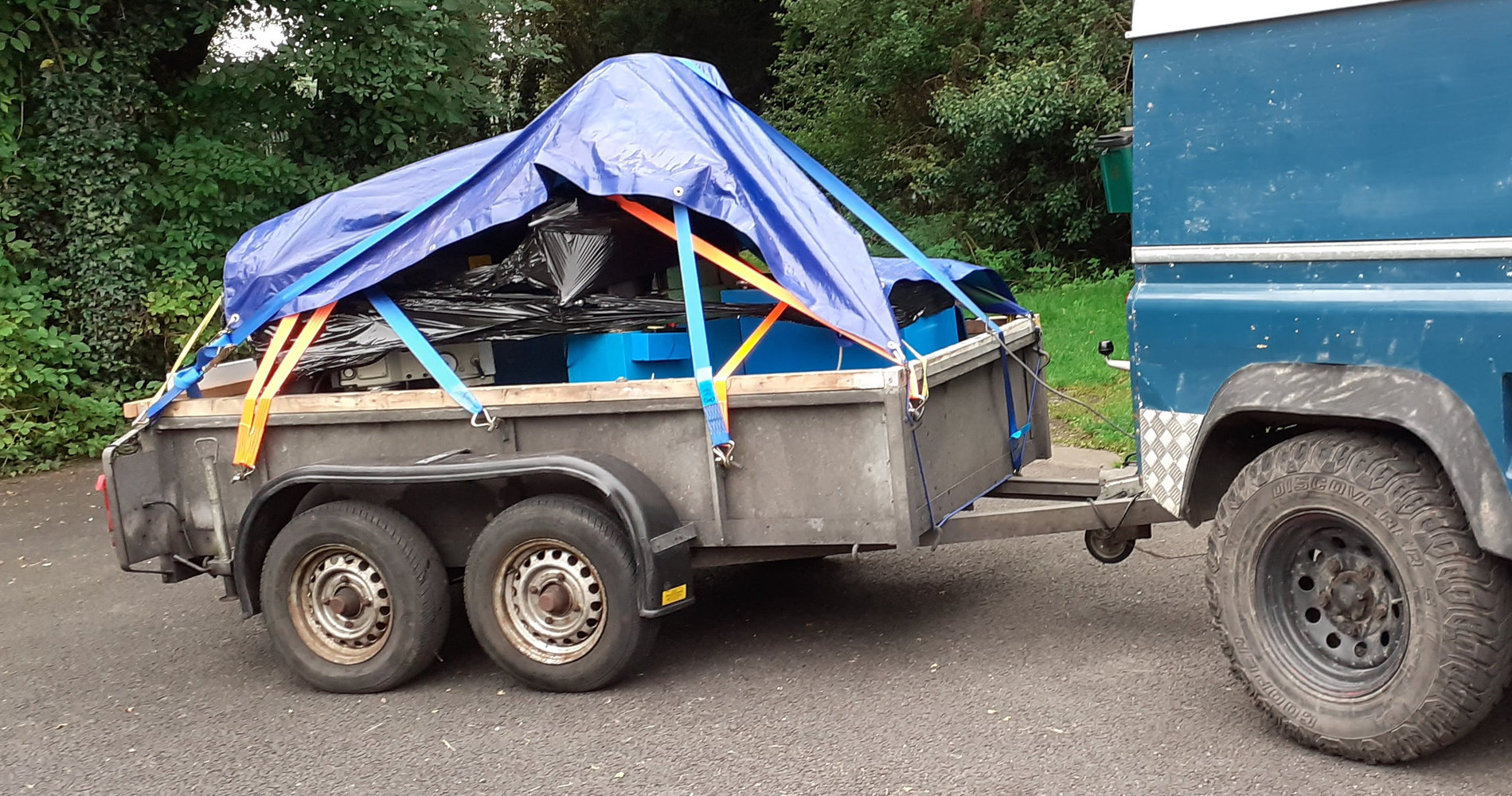

I did see yours. You got a fantastic deal with all the ancillary stuff and the vertical head too. Fully loaded as in my pic the 2b weighs 208 kgs! The lathe weighs 435 kgs so I just went for itMy Center is the smaller version of this, 2a not 2b, I stripped the large pieces off and then it was relatively easy to move about on my own. There are some pics in one of the threads.
My other mill weighs 250 kgs so the trailer was full (but still within its legal limits). Gratuitous trailer pic

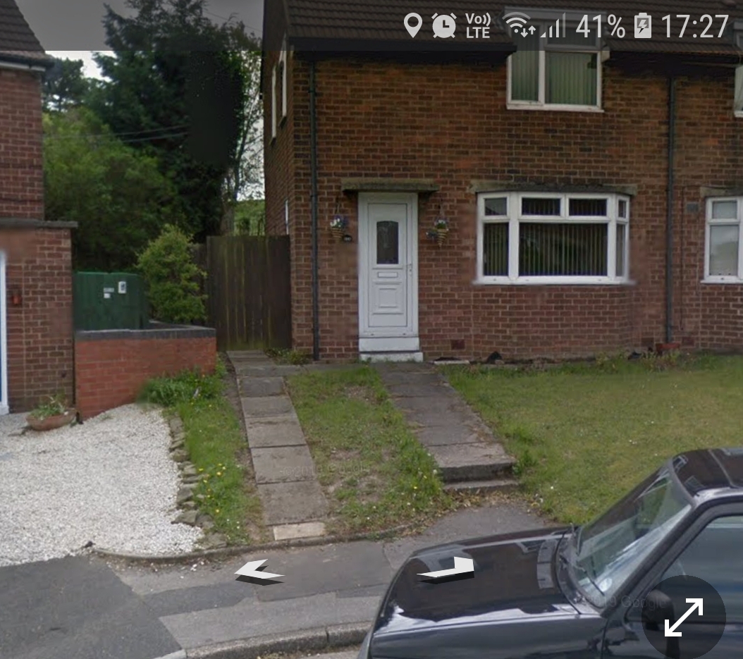

I did think you would be one of the best people to ask!!Scaffold boards and poles. That's how I move all my stuff about
the best point to roll anything is your doorway steps
get the tail lift driver to reverse up and block the road and drop the tail lift onto the flags of the doorway path
roll it towards the door spin it and spin it again just lay extra flags for spin round
Have you considered moving house?....What are my options?
