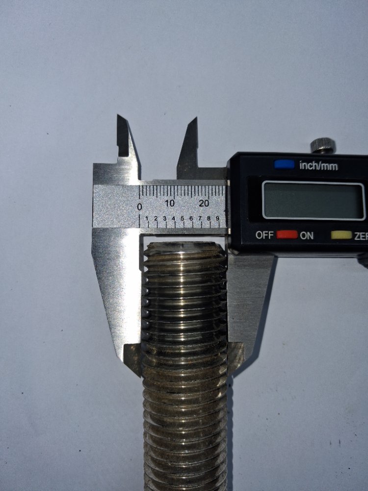

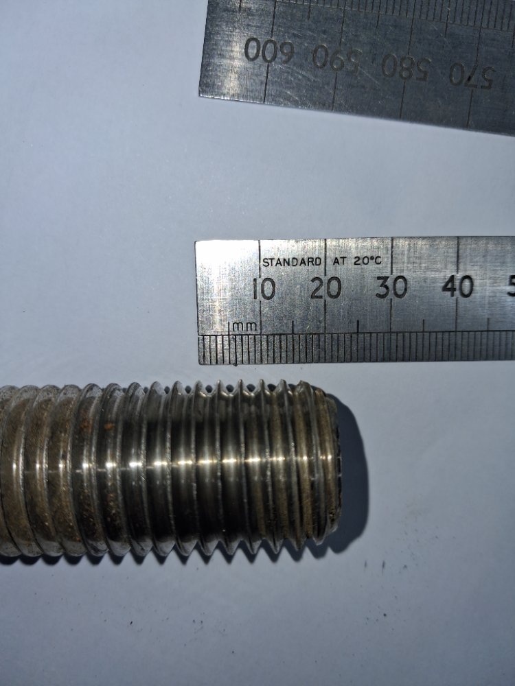

you sure its 1.75? my usual goto above for oddball thread size shows 1.5 and 2.0 in the range of fine threads...
whats the size across the flats of the original nut?

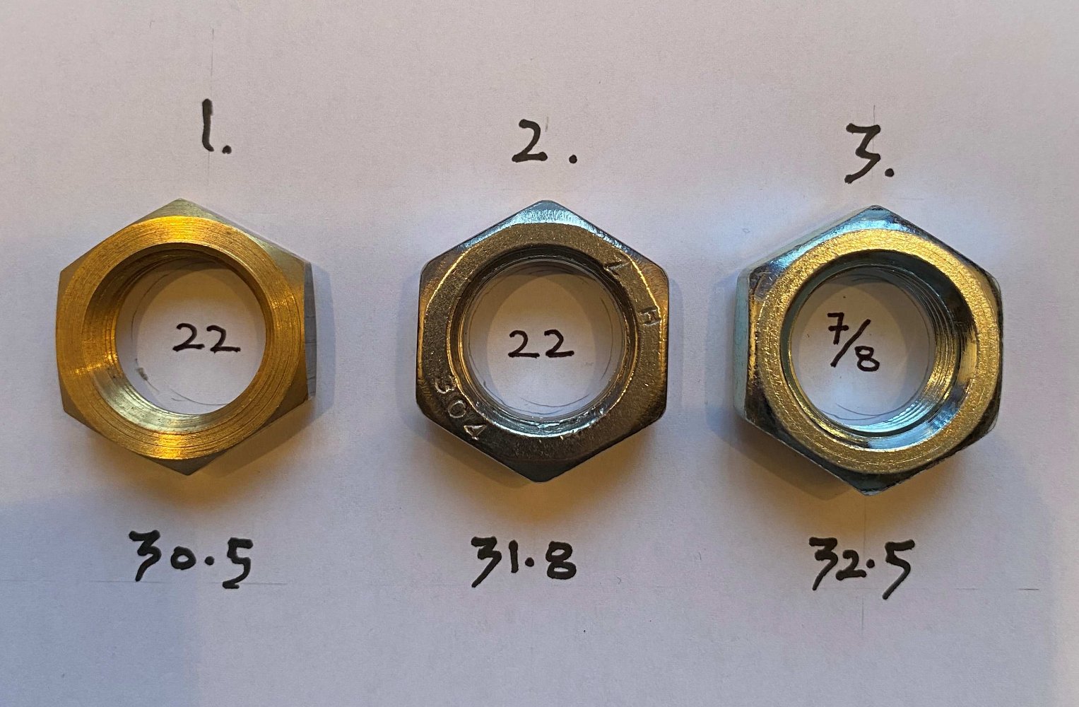

i was more wondering if i had any brass large enough to make one, but i fear i may not as it is likely 32mm AF, so larger across the points and my largest stock is currently 30mm...only stuff i have larger than 30mm is a 60mm bit of en8 thats waiting to be turned into a collet chuckYea, if you can find that and measure across the flats then we can help you find a replacement for it![]()

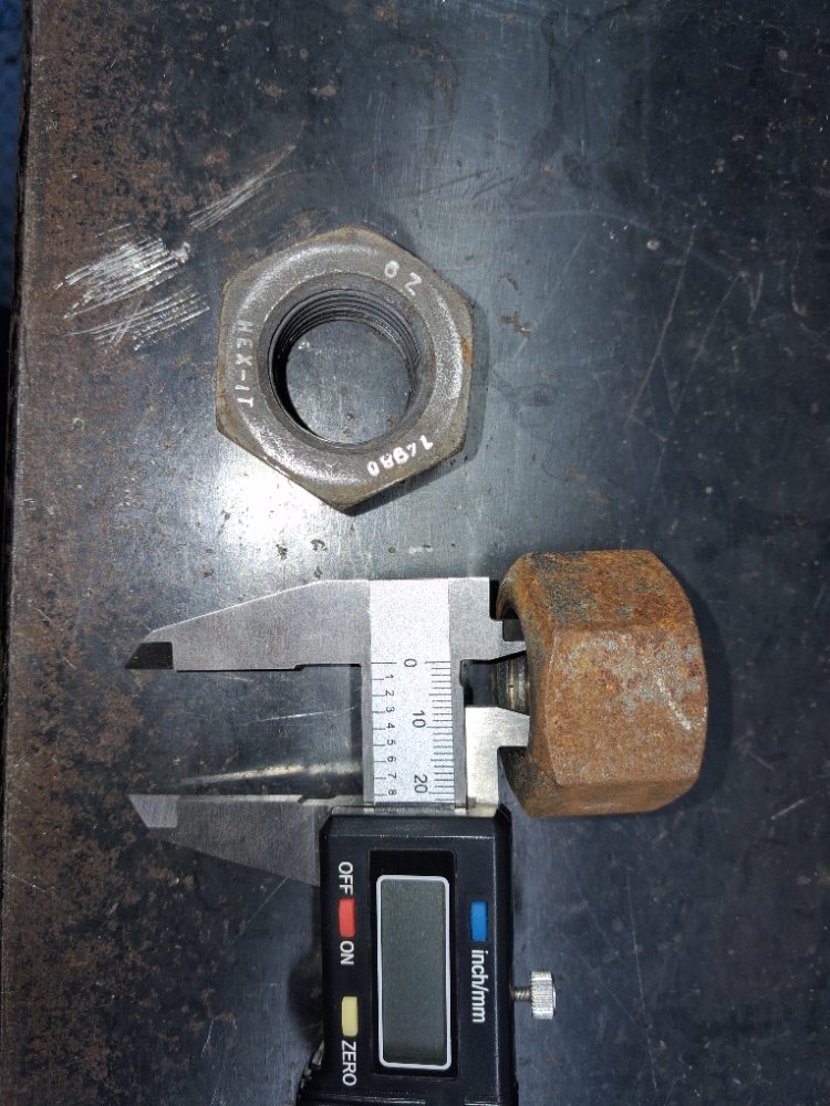

I don't know how to individually quote comments from various people on one post - so this is a reply to "qwakers" - "BrokenBiker" - "hotponyshoes" and "droopshoot.Are these different to the nut you're trying to replace?
