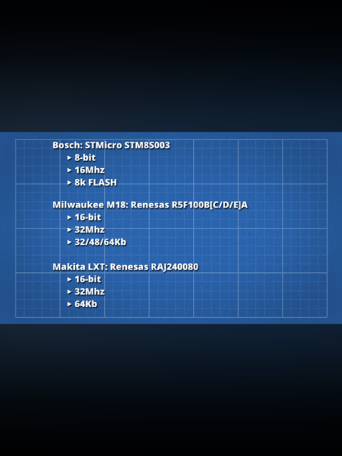

but there's a bunch of people on Youtube taking them apart saying the bms is there but it's dissabled
They've proven so, rather than merely speculating?

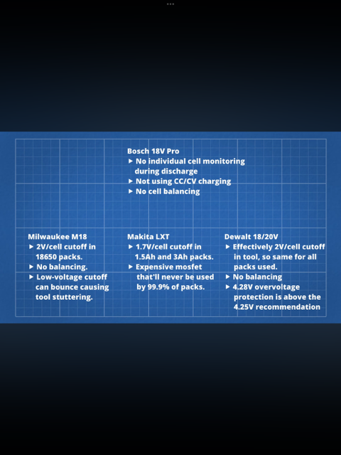

Interesting stuff, any details on the Makita XGT? I was initially using the batteries down to the cutoff but now try to swap them out as they hit 1 bar left. I could drain one and measure it.Milwaukee don’t balance, like most tool manufacturers, it’s only Makita and that’s why they are generally a bit more £ per Ah.
View attachment 510439View attachment 510440View attachment 510441
The XGT uses a far more complex BMS, I think it will take a while for the community to catch up with these. I think it’s safe to assume that individual cell balancing is certain. They may well use dynamic LVP dependent on load.Interesting stuff, any details on the Makita XGT? I was initially using the batteries down to the cutoff but now try to swap them out as they hit 1 bar left. I could drain one and measure it.
I suppose that means the chinese fakita batteries are less likely to catch fire than the originals?

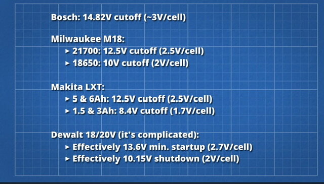

Where did this info come from?
The Makita info is completely wrong. All the LXT batteries from 3Ah to 6Ah use 18650 cells in a 5s 2p configuration.
They are different capacities to give you different overall battery outputs.
But the minimum voltage of all of them when fully discharged is limited by the BMS board to 3.4 volts per cell. Once it hits this figure the BMS cuts power to the tool to protect the cells.
I don't know where their figures of 1.7 and 2.5v come from.
The absolute minimum of a 18650 cell is 2.5v, anything below this and you will damage the cell. Quality protected cells will cut output to the terminals if you try to discharge them further.
Wrong? You’ve lost me there fella, I certainly haven’t claimed the LXT packs have currently used anything other than 18650. The 1.5 and 2Ah batteries use a single string of 5 cells but yes the others are parallel.Where did this info come from?

Interesting, 3.4V still has significant charge remaining, even at no load. If a loaded tool was to cut at 3.4V you would get almost no runtime.But the minimum voltage of all of them when fully discharged is limited by the BMS board to 3.4 volts per cell. Once it hits this figure the BMS cuts power to the tool to protect the cells.

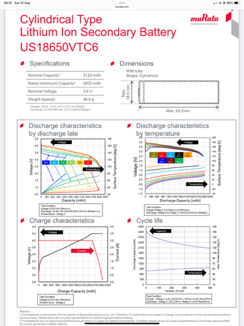

Which manufacturers data sheet are you referring to? 2.5V is stated on the Murata sheets I can see. The decision by Makita to use 1.7 on the lower capacity cells does raise eyebrows, it’s likely to stop high load tools tripping early but it is beyond design specs and not advised. This is why most people buy the 5Ah batteries for professional work (lower output impedance than all, even the 6Ahs).I don't know where their figures of 1.7 and 2.5v come from.
No tool manufacturers use protected cells.Quality protected cells will cut output to the terminals if you try to discharge them further.
