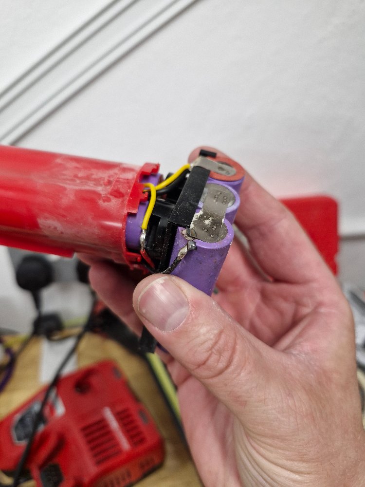

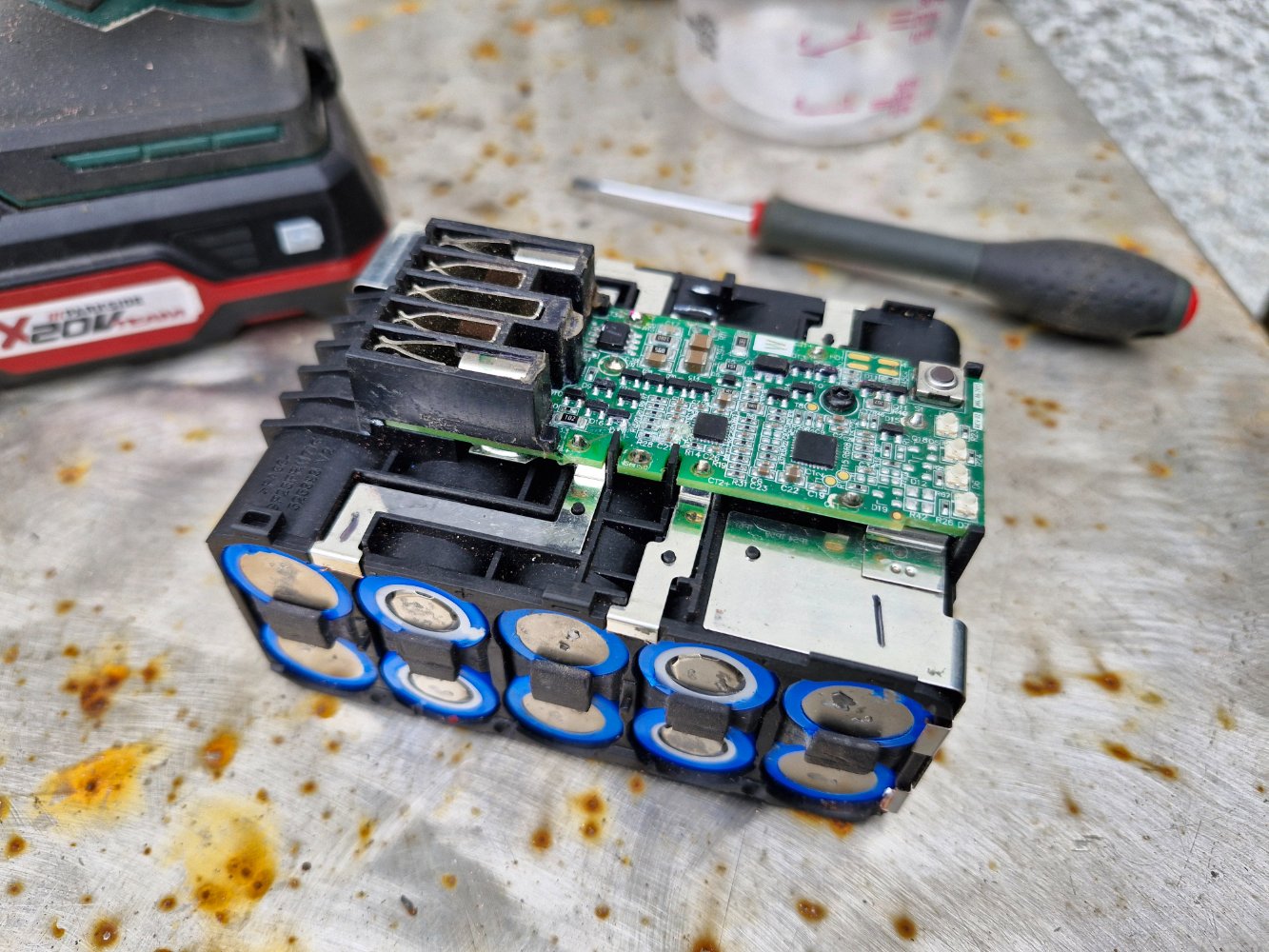

Thanks for that- I used my M12 die grinder to grind the strips a touch then peel them off. I did still damage 2x of the cells but doesn't really matter as I have a large supply of unused parkside batteries.

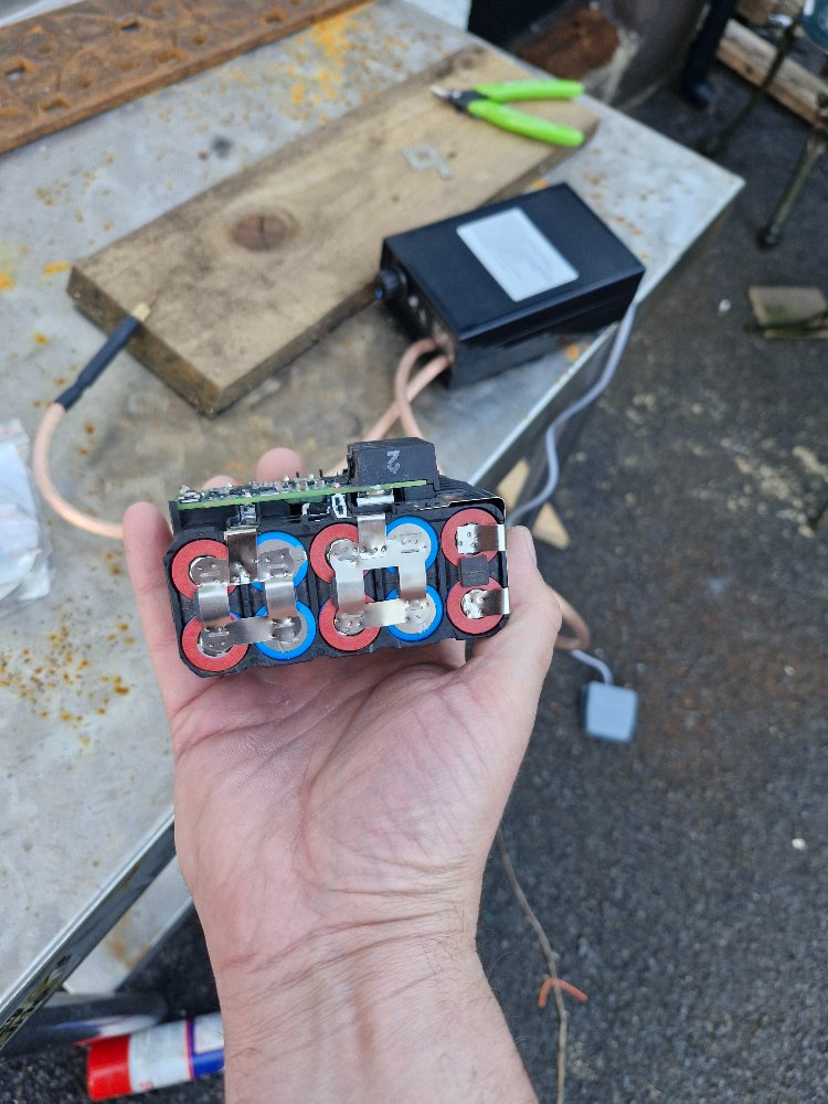

For the m18 battery cell removal it was faster to cut all the connections with a cut off wheel.

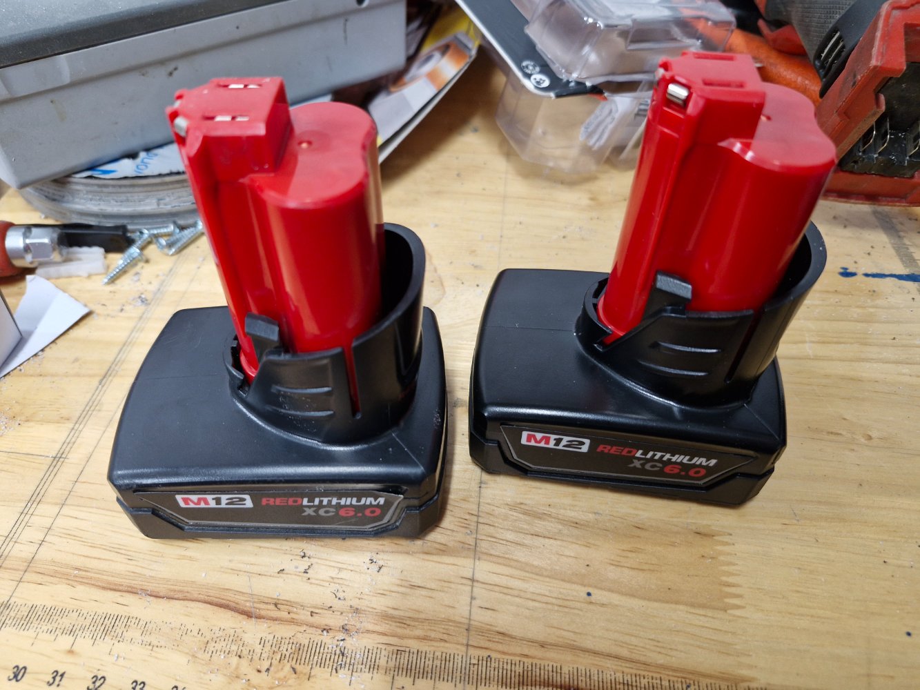

I present the Milside battery
So all thats left is to await the Nickel strips and spot welder to arrive in a couple of weeks time and ill see how this Parkside cell Milwaukee battery performs. Better than a dead Milwaukee battery thats for sure.
Get a supply of insulating ring thingys.
They go on the end of the cells to prevent the strips shorting on the battery casing.
https://www.amazon.co.uk/Bluelover-...battery+insulators+ring&qid=1754143880&sr=8-4
They also help you id the positive end of the cell when welding them up.
That's some level of mixed up.
