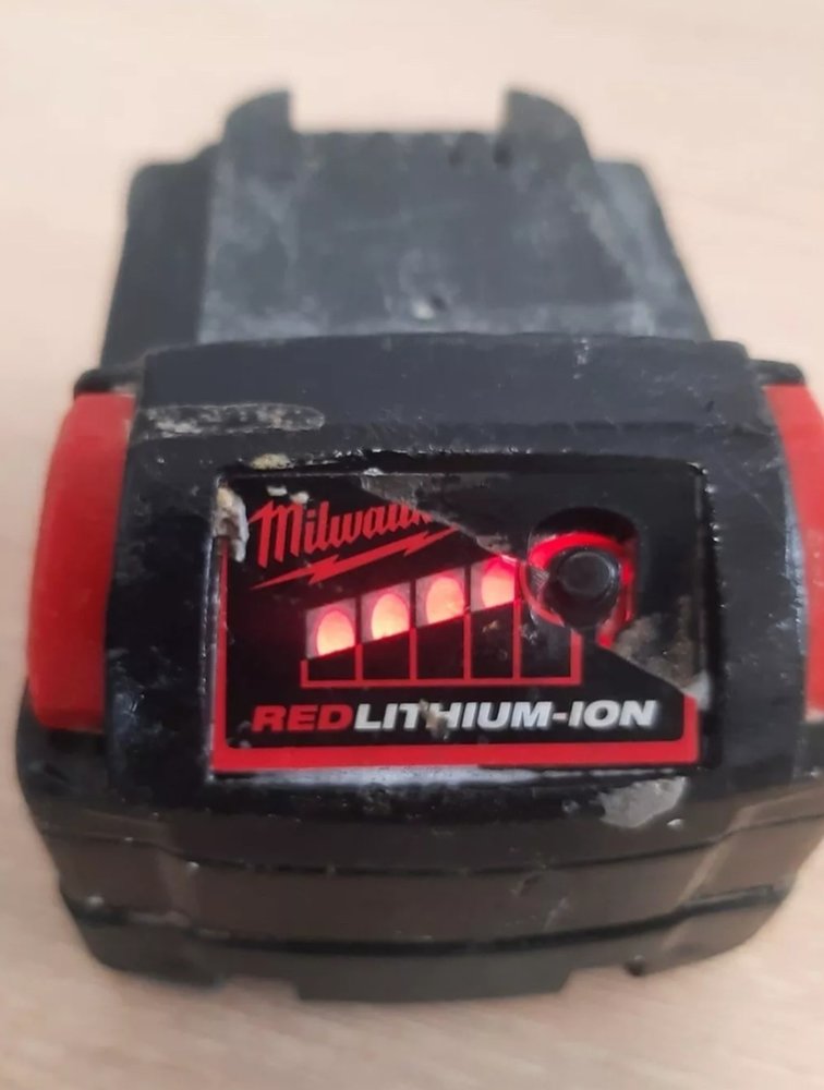

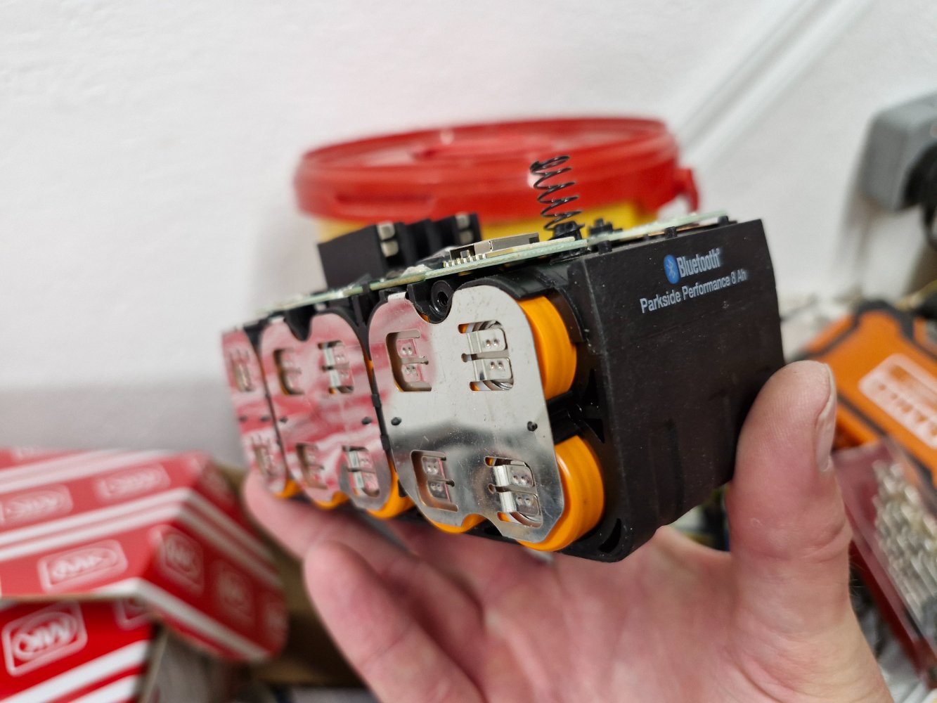

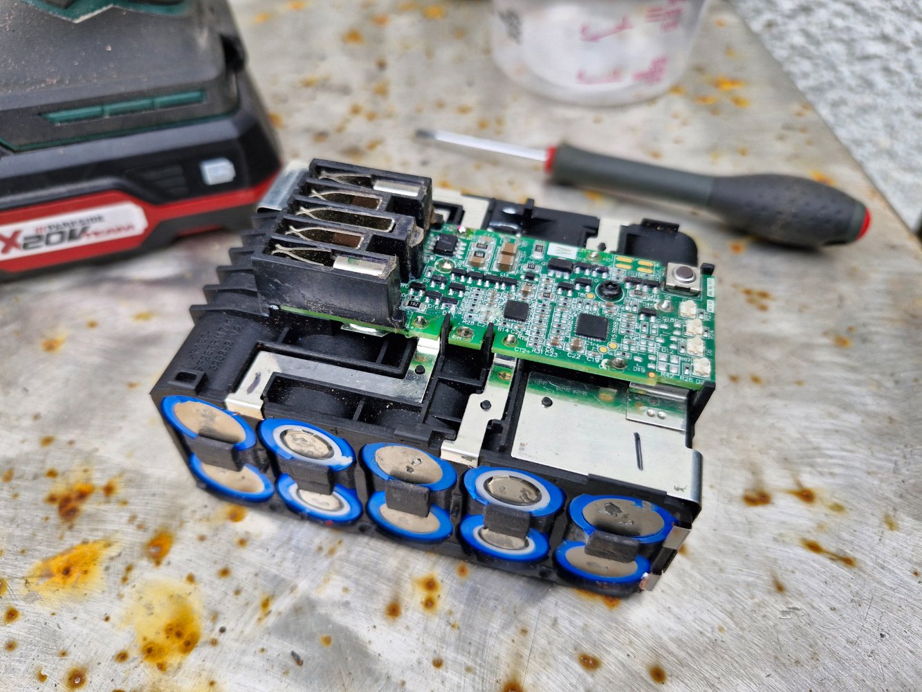

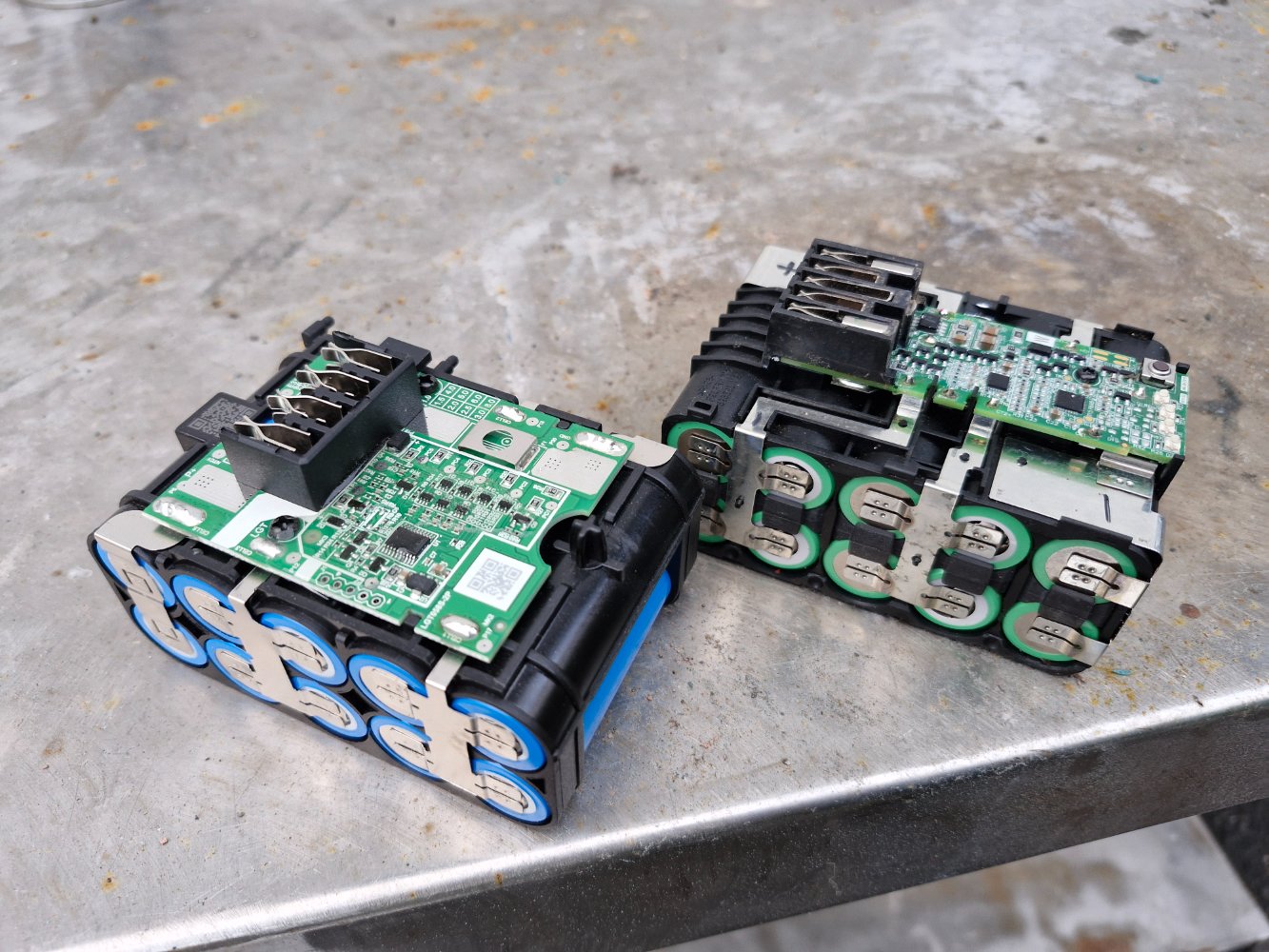

JOEPRO. Just a bit of information from my experience. From time to time I have been presented with power tool batteries that show 0ve output. It seems the battery failure happens when it is used to drill "just that last hole" when the user is at the top of a ladder with an almost discharged battery. Examination of the battery shows that a thermal fuse on the battery control board had correctly failed. Repairs put things right.
