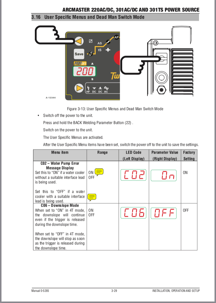

I’m pretty sure it’s there as I had a look at yours. May be wrong.Not on the tweco there isn’t
You can connect any torch or pedal to it
The lorch is different

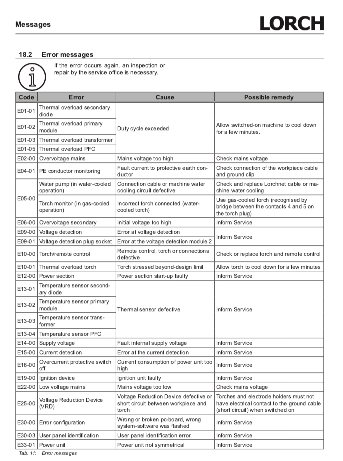

Ah ok yes well I knew that was there I have mine set up to work with the cooler.That’s the kiddo
The E25 code usually appears when the tig torch is earthing against the bench etc when the machine is turned on.
Make sure your tungsten or torch is NOT touching the Bench when turning the machine on.
