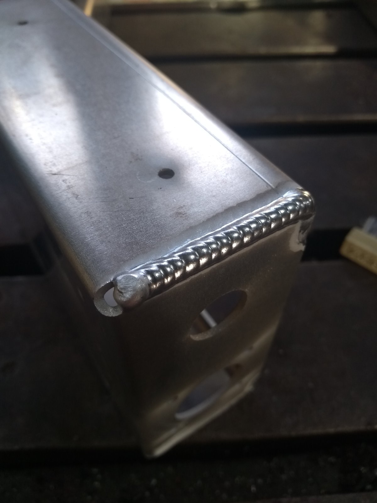

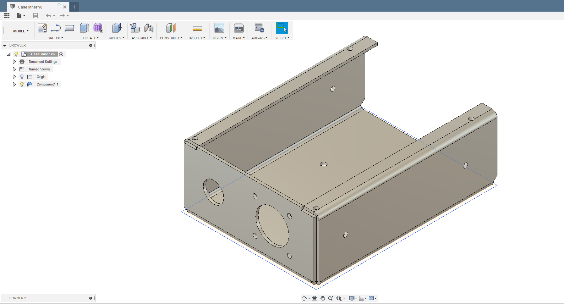

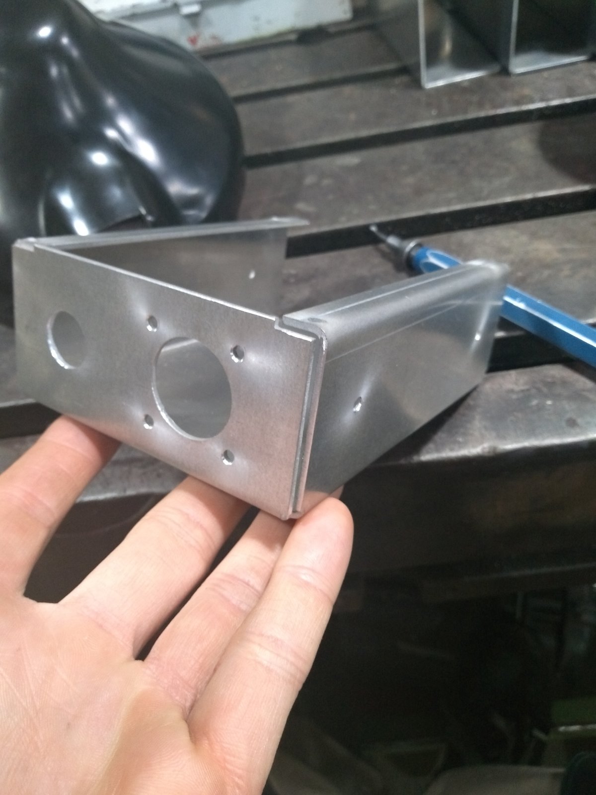

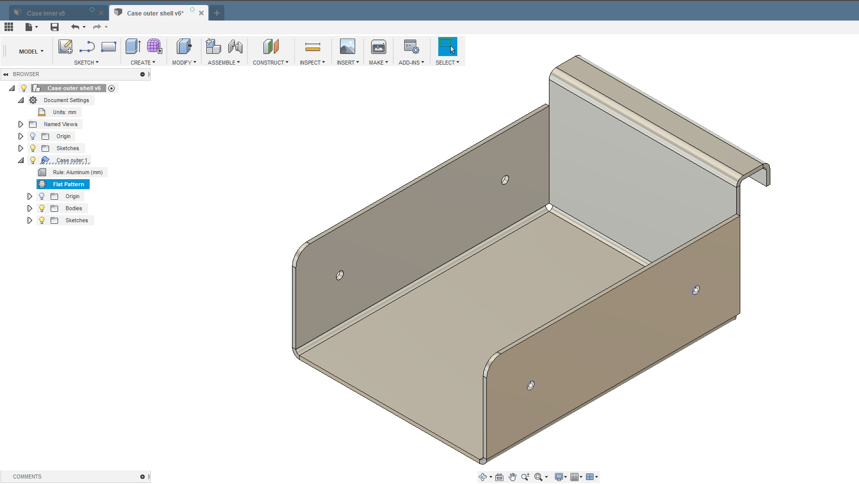

How’s the one I made.I'll get a screenshot from my cad package and upload it tomorrow. It's basically a 2 parts case with minimal welding.

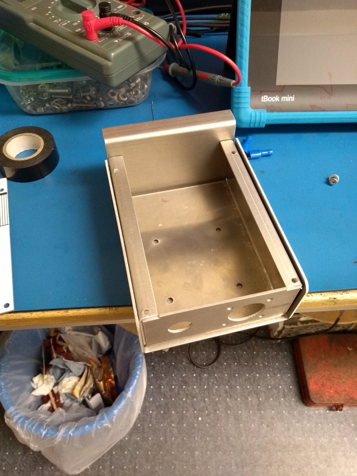

I did mate, it has my remote in it.How’s the one I made.
Did you use it in the end mate.
Fitted okI did mate, it has my remote in it.![]()
Yep, all went together sweetly mate. I'm hoping my sheet metal flat pattern ends up being correct, first time I've done any sheet metal stuff in Fusion 360Fitted ok

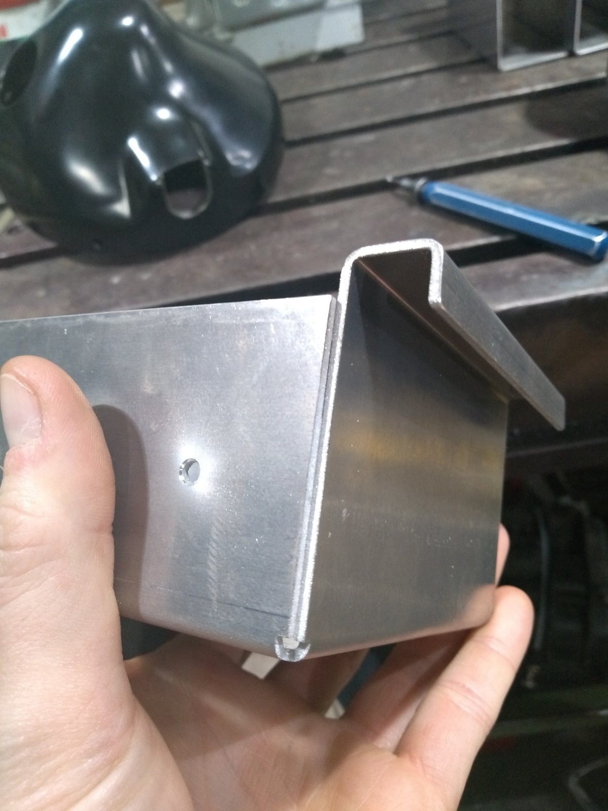

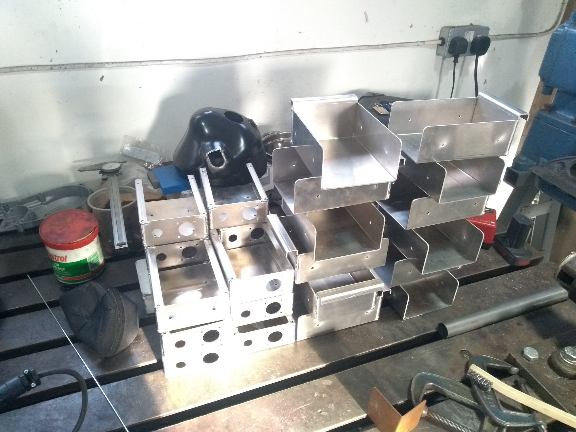

That one was the prototype Richard, the production ones extend further out the front and up the sides...I’m not sure I would weld them Hugh unless you have to.
Looking at them they will hold together nicely with a couple of self tappers on each side.
I still don’t think the sides are deep enough either personally. Those pots are gonna be quite vulnerable to a good knock. I’d of had more height round the sides.

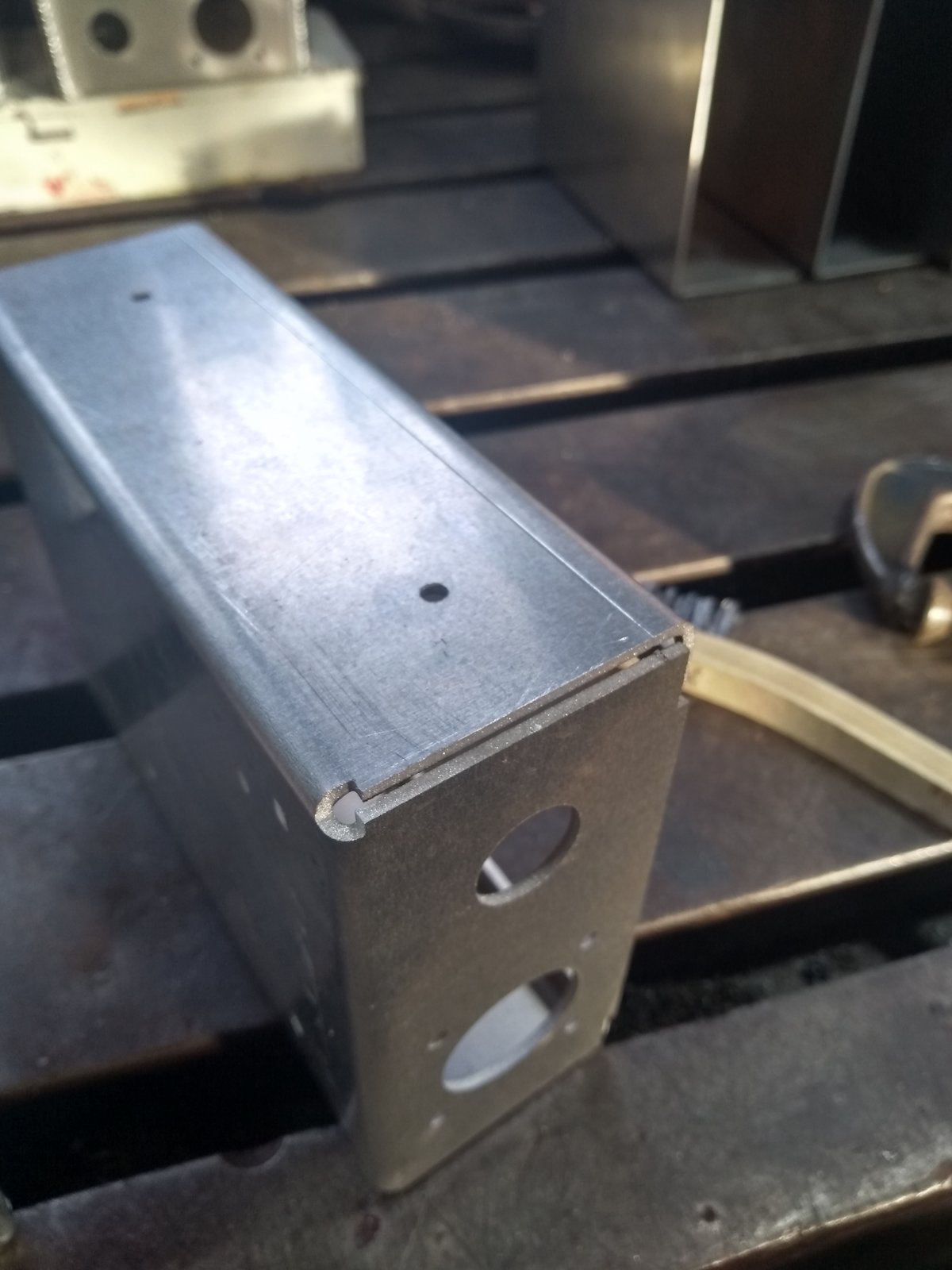

This first batch of 5 will be wet sprayed because:Do you powder coat them?
Very tidy

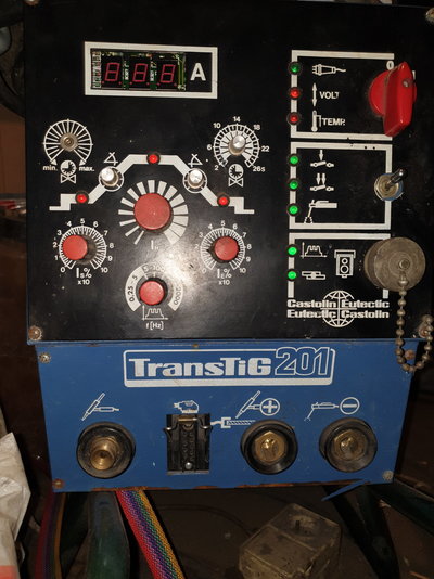

Felt like a day back at my first employment, knocking up panel doors with outside corners. Except this time I have an inverter instead of a noisy old syncrowave 300Very tidy![]()
Does the machine have the function to do pulse though hugh?Hi Damian, yes it will fit straight onto that machine . I will send you a pm with details...
