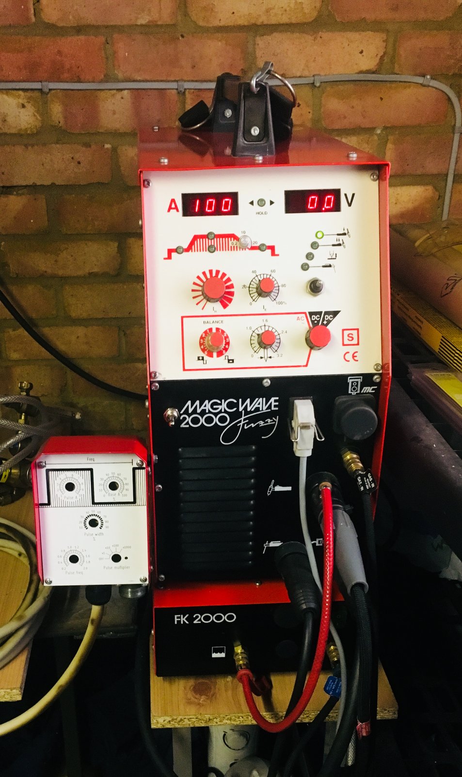

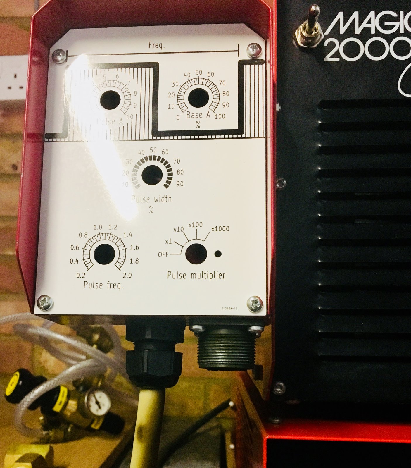

Very tidy job mike. Looks much better having the sockets on the machine rather than cluttering the remote.Hello All.

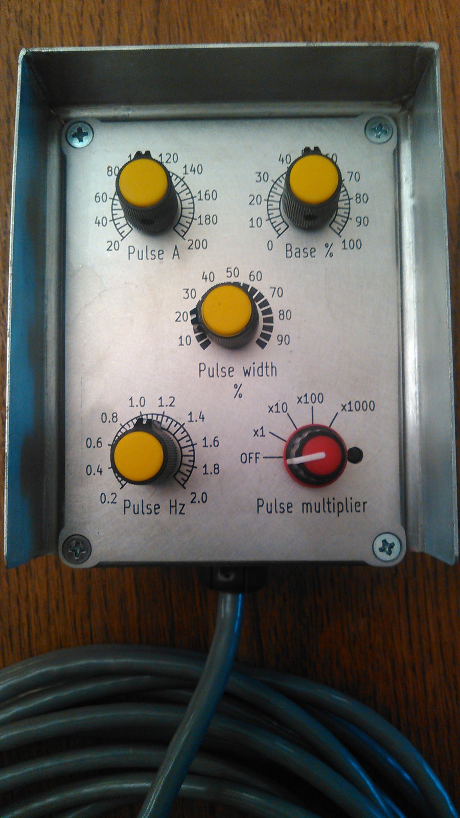

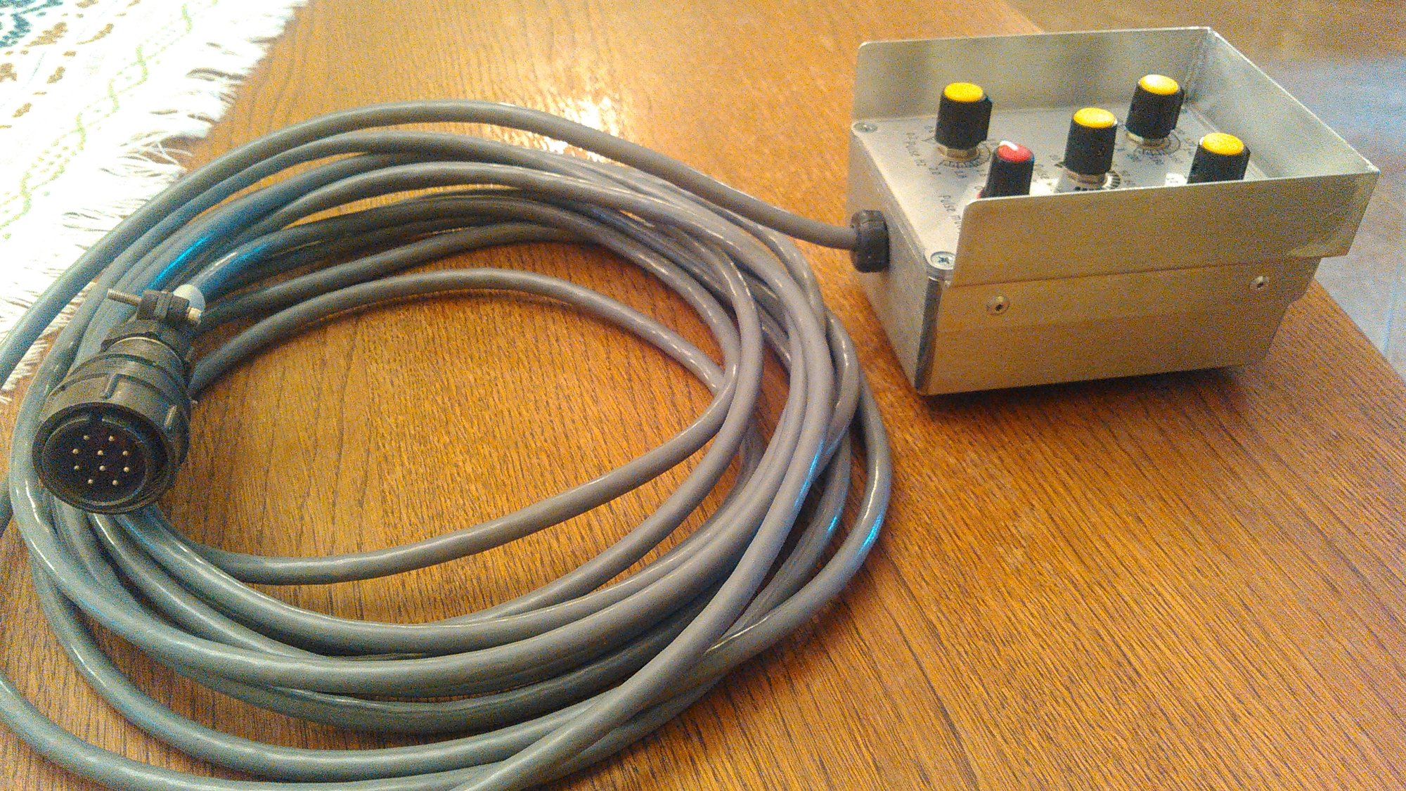

I've finished my tr50.

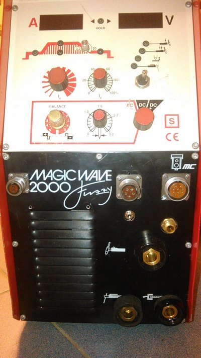

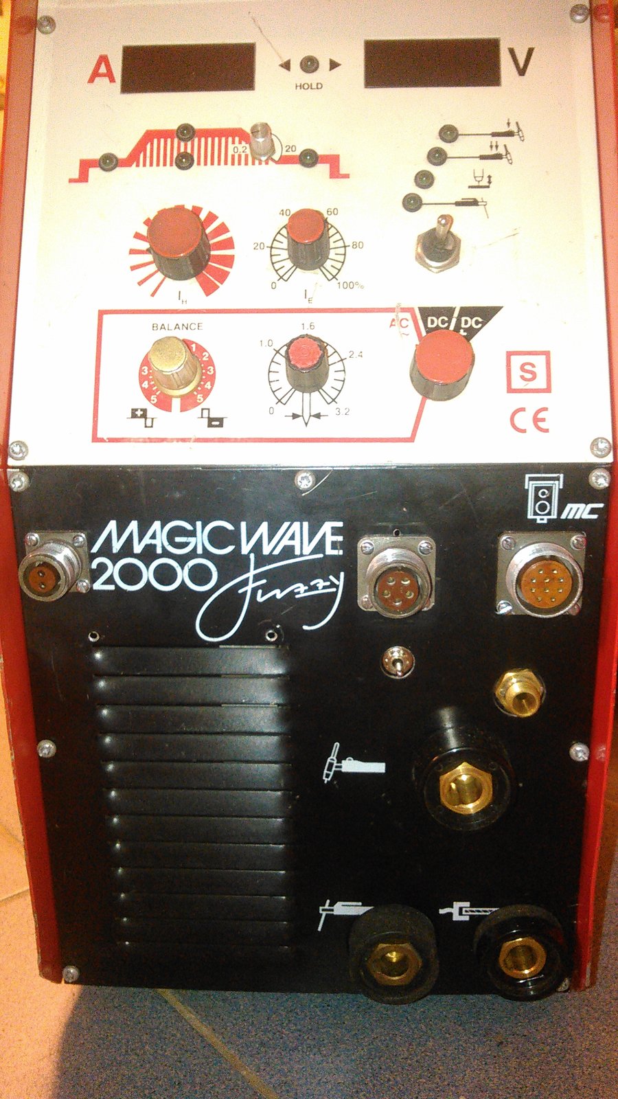

The machine's front plugs are: torch control, pedal control, pulse control and menu switch.
View attachment 142854 View attachment 142855 View attachment 142856

Excellent demonstration Hugh
Thanks MikeCongratulate on successful completion of the project
Have you used yours yet mike. Be nice to see some welding resultsCongratulate on successful completion of the project
I will try this and report backYeah it’s gonna be nice to get some pulsed stainless out of it.
I’ve forgot Hugh, with the pulse selector in the off position can you still Change main current via the remote? It would be lovely to keep that remote plugged in all the time even on aluminium and just use it at the bench as a current controller even when not pulsing. Does it work like that.
