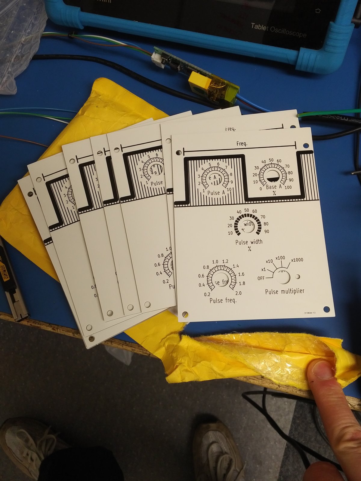

I'm waiting on the mating 10 way connectors for the cable connection. Should be here this week then I can test it. The boards for the front panel are in production at the momentHow’s it going Hugh.
Have you got anywhere nearer to testing the board. Can’t wait to hear the results
Richard, green led below main current blinks up.The green led below the “hold” led is illuminated I believe.
Sounds like it’s working just like the originalRichard, green led below main current blinks up.
Can you post me one please bud. I’ll get it cut to size.I've been flat out busy this last week, but I can now assemble one of these front panels and test the setup...
Certainly Richard, I'll get this and the original front panel for your case sent off tomorrow...Can you post me one please bud. I’ll get it cut to size.
Mike, sure I can. Or you can have a complete panel if you think postage/customs won't be a problem? They weren't expensive.Hugh, good job!
Is it possible to share a front panel's file?
Cheers mate. Let me know what I owe youCertainly Richard, I'll get this and the original front panel for your case sent off tomorrow...
Thanks a lot Hugh.Mike, sure I can. Or you can have a complete panel if you think postage/customs won't be a problem? They weren't expensive.
105.2mm x 141.8mmThanks a lot Hugh.
Could you tell me panel's size?
Unfortunately my housing is smaller.105.2mm x 141.8mm
I will send the gerber files... do you have any experience with using KiCad? If so you could resize the circuit to fit your housing...Unfortunately my housing is smaller.
It will be very useful if the file is in vector format.
I'm sure that I can.I will send the gerber files... do you have any experience with using KiCad? If so you could resize the circuit to fit your housing...

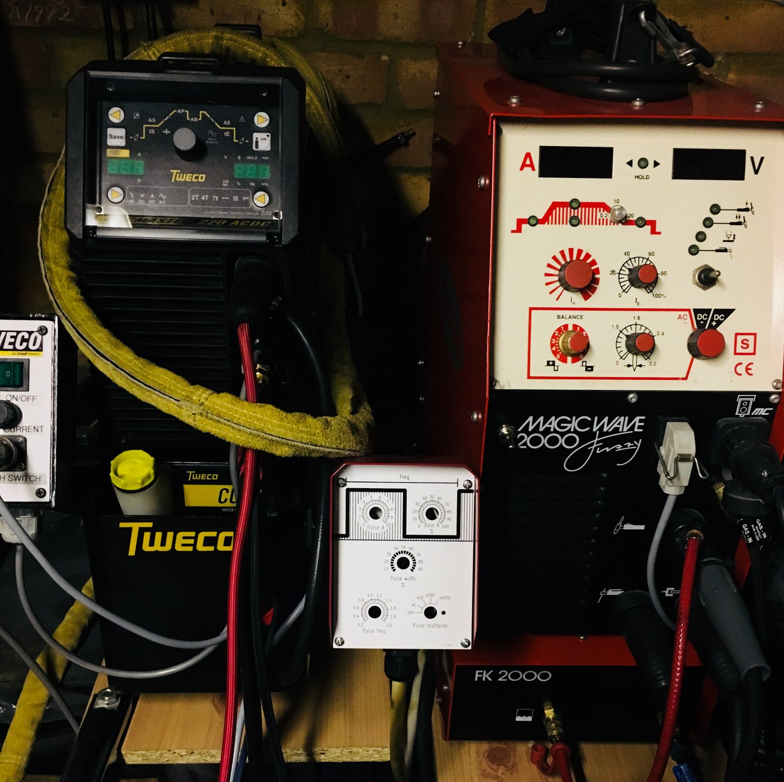

Is that a new cooler under your twecoHugh’s pannel sits in there like a glove.
Just needs filling with some organs now![]()
Not new I found it second hand.Is that a new cooler under your tweco
