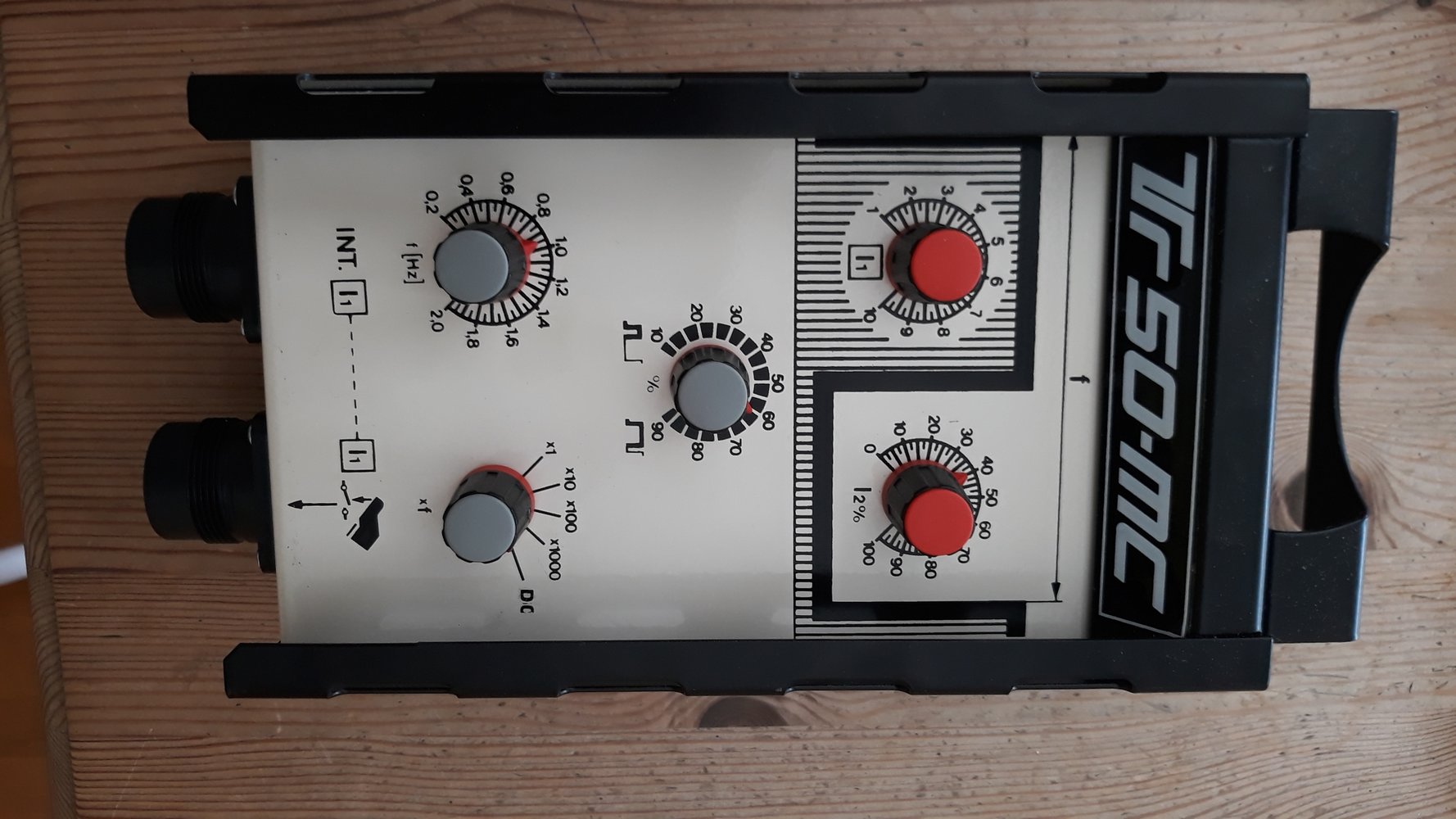

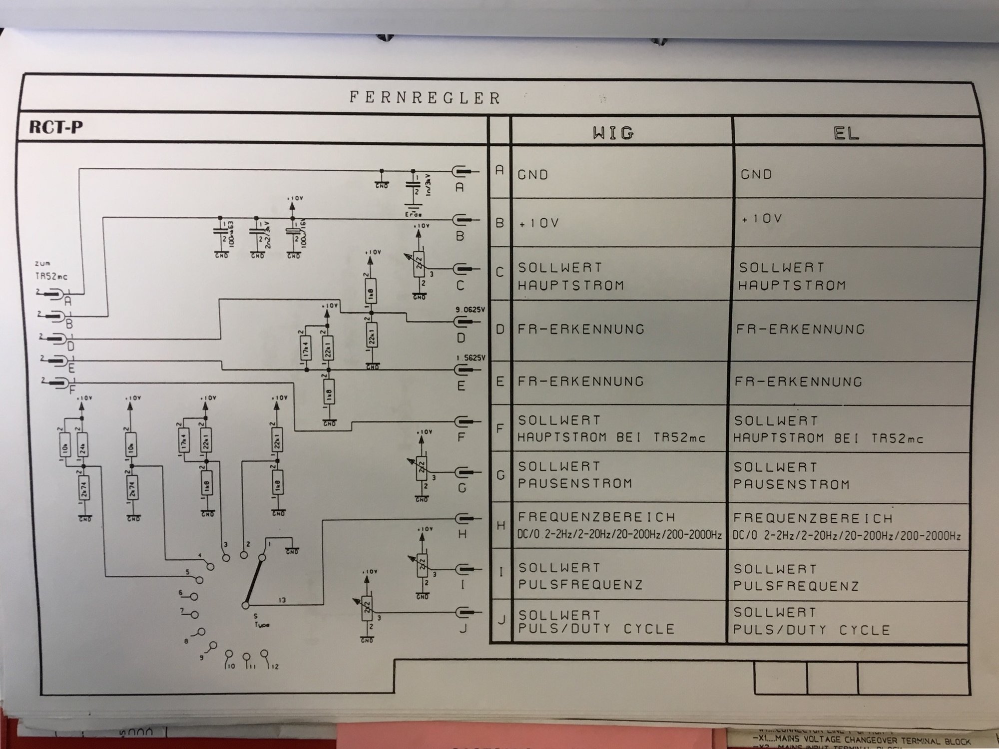

One Question regarding the TR50MC.
If you connect it to the machine, is there allways pulse? There is no switsch to activate it.
Or do you just have to turm both currents to 100% to have it not pulsing??
