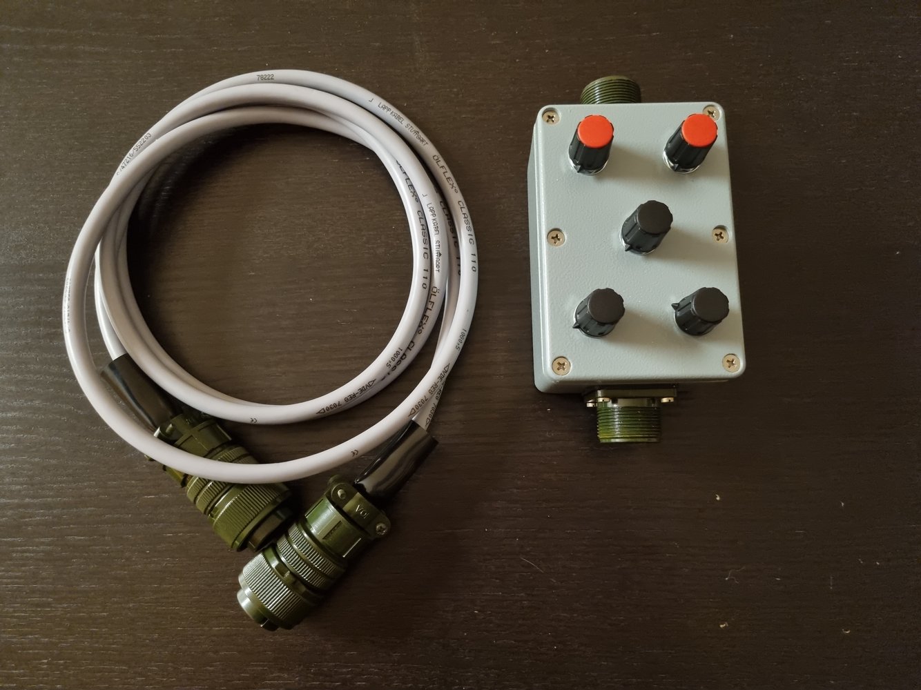

That's exactly where mine came from. There was an issue with the cable mount connector though, it didn't fit the original threaded connector on the front of the machine. The threaded locking ring was marginally too small in diameter. I ended up with another brand from RS that did fit, and was around £10 each.I posted this already, but it fits also into this thread...
For those who are still looking for the Amphnol-Connectors, there is a much cheaper variant from aliexpress available. At RS and all this distris you pay 25+ € for one, at Ali I payed 25€ for 2 sets of connectors, cable-, box, male and female.
I don´t know if they are made from plastic or casted metall, will see in a few weeks. I just ordered some.

Did you use my PCB design?Just build up an electric prototype and what can I say, it´s working perfect with the Magic Wave 2600. You can set the max current with I1, up to machines maximum. Current setting wheel on the machine is totally ignored. But that´s nice as it is a remote control, also with switched off pulse. You do not need to go to the machine to set the max current anymore.
Now I am waiting for the connectors and then a housing will be built.
Thanks a lot for sharing the schematic. TR 52 MC was nowhere available and even if, it saved me a lot of money.
