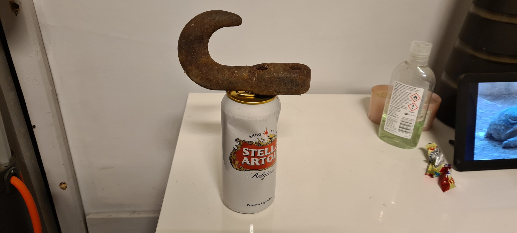

That’d do it.just use some sleeve bolts and a U plate from screwfix. hell a decent eye bolt may do the job in that thick concrete
The body shop jobbies i was on about are flush so they can stay in situ and you won’t trip over them.

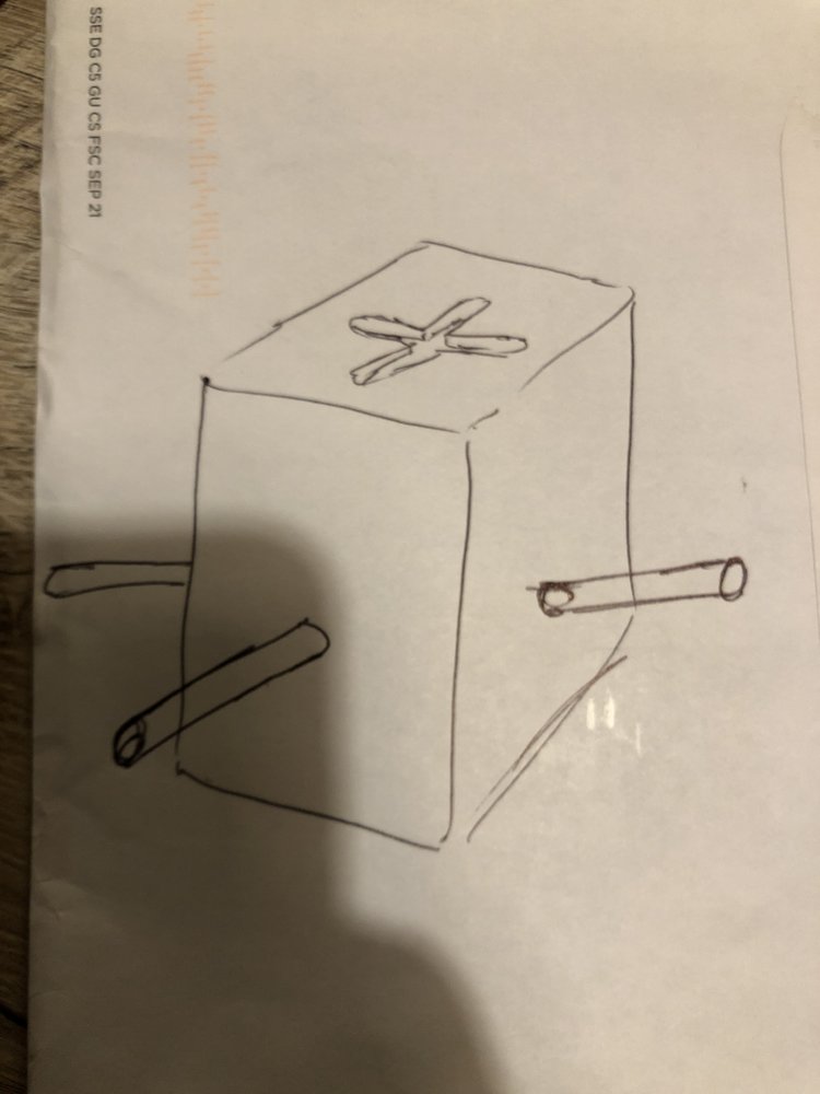

Id make one like this. It’s on my list for here. The bar at 90 is just to sit it into the concrete better but it’s essentially flat plate on a bit of box
