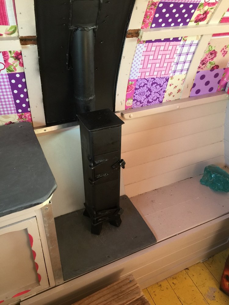

actualy you could just by adding a stainless steel tube within the stove itself and it becomes a rocket stoveWhat if you sell them as an ornament only?
I doubt you can build a decent rocket stove with the same material?
I wish my visualisation was better.actualy you could just by adding a stainless steel tube within the stove itself and it becomes a rocket stove
the gypsey stove is just the external side of it 5mm thick with a 6/10 mm top plate ( heat exchanger ) with an internal vortex or a straight up 2/3mm box inside of it
then a firebox on front with either a vortex tube or straight up tube in firebricks connected to it
exhaust is at bottom instead of at the top
and thats your rocket stove
stick a box infront of this picture as this will become your firebox whilst the stove becomes the heat exchanger built out of 2/3mm steel
Ah Ah Those use Box section.stick a box infront of this picture as this will become your firebox whilst the stove becomes the heat exchanger built out of 2/3mm steel

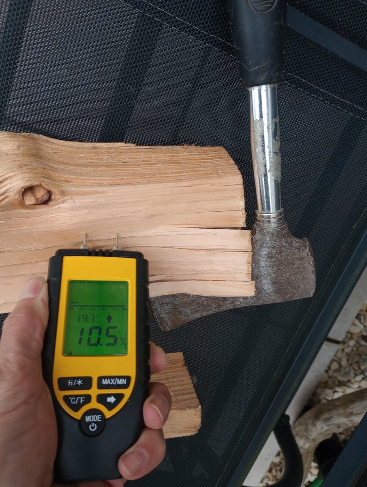

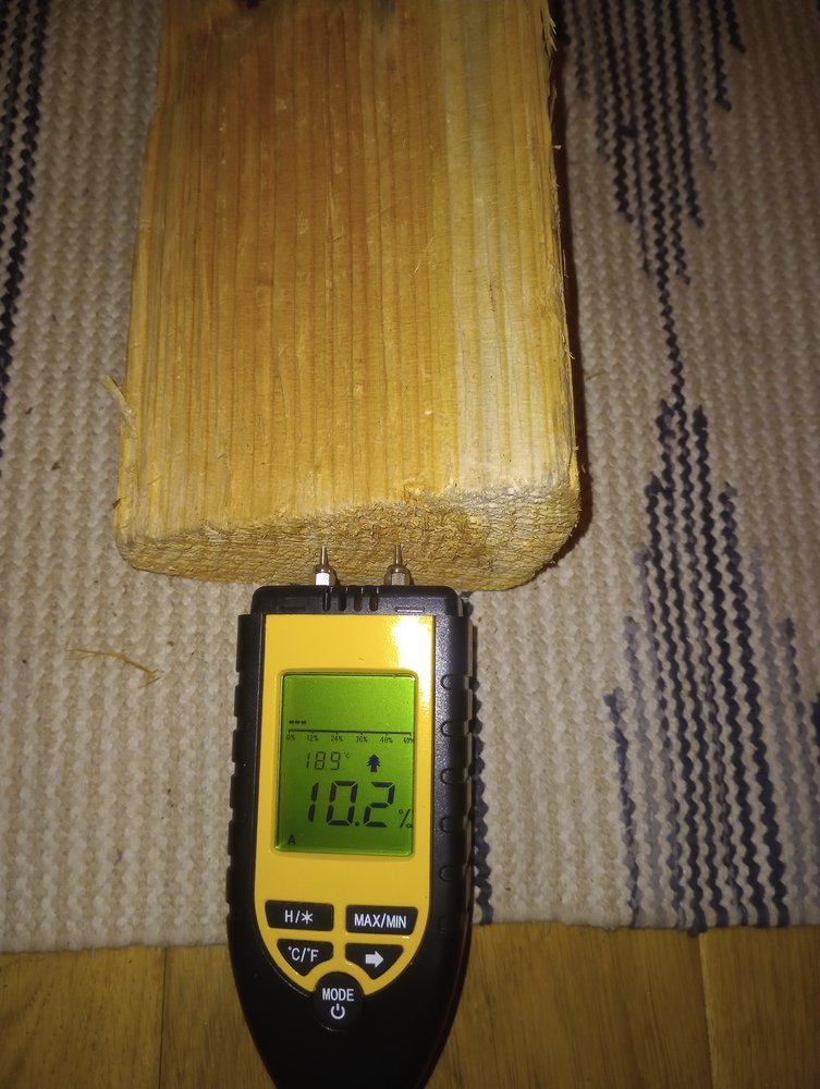

Larch is the best softwood for energy value per kg. Burns hot. It was virtually all I used and sold last year. If I could buy more by the lorry load in lengths I would. Are you sure its proper dry?Started burning the larch a few days ago, it burns very clean, no smoke and little ash, but it doesn't burn that hot. Early days but don't think I would use it again given a choice.
Have you split it & then tested the fresh exposed face?
Made no difference. Larch may be the best softwood to burn but not a patch on the harwood I've been burning for the last two years.Have you split it & then tested the fresh exposed face?
Testing the end gives a false reading.
Larch also feels very light when dry.
