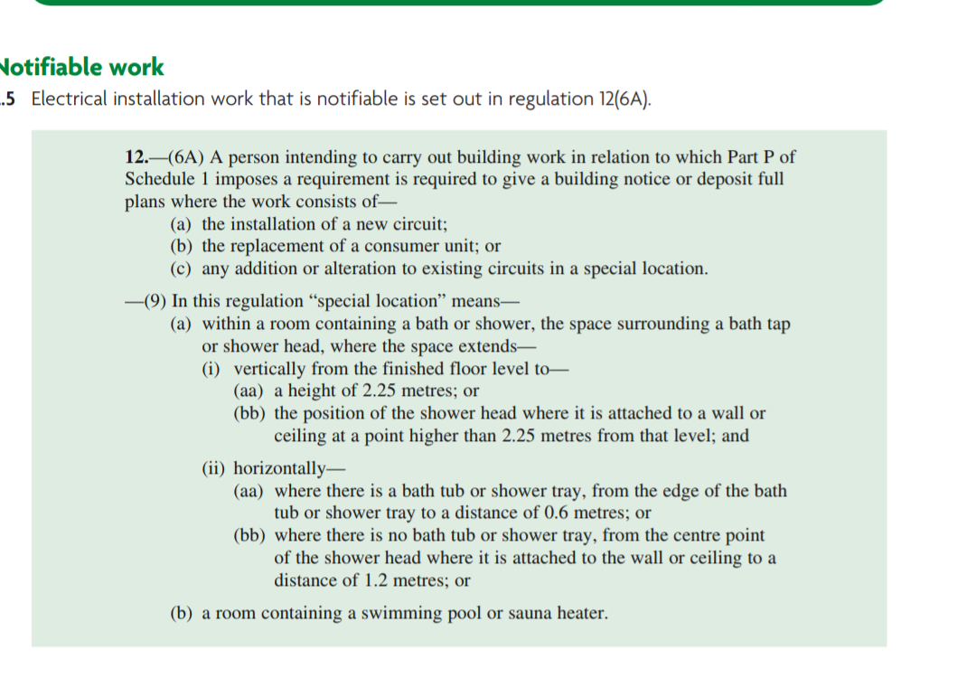

Getting away from the question, and still without a definitive answer:
"Can a non-qualified, but otherwise competent, person, legally issue a minor works certificate for non-notifiable work?"
Doesn't that competent person thing now also include having to have passed the latest edition of the electrical regulation exams & hold a current certificate to that effect .?
I'd deffo use a wired up plugin RCD plug inside the dwelling and take the light feed cable out the wall inside of a plastic pipe then clip the cable in place to the lights . If you move homes it can be taken out and go with you .
If you can't certify or get it certified then you can't do it ...
the question is: "can *I* certify?".
i can do the work. i can do the tests. i understand the results.
but i have no qualifications.
40 years in construction, dealing with things like this dailyWhere did you find that, can you quantity that answer?
No you can't... if you are not registered with a professional body you can't self certifythe question is: "can *I* certify?".
Is it legal for me (a "competent" but unqualilfied person) to do a non-notifiable electrical job for someone, for money
Part p for openerscite?
