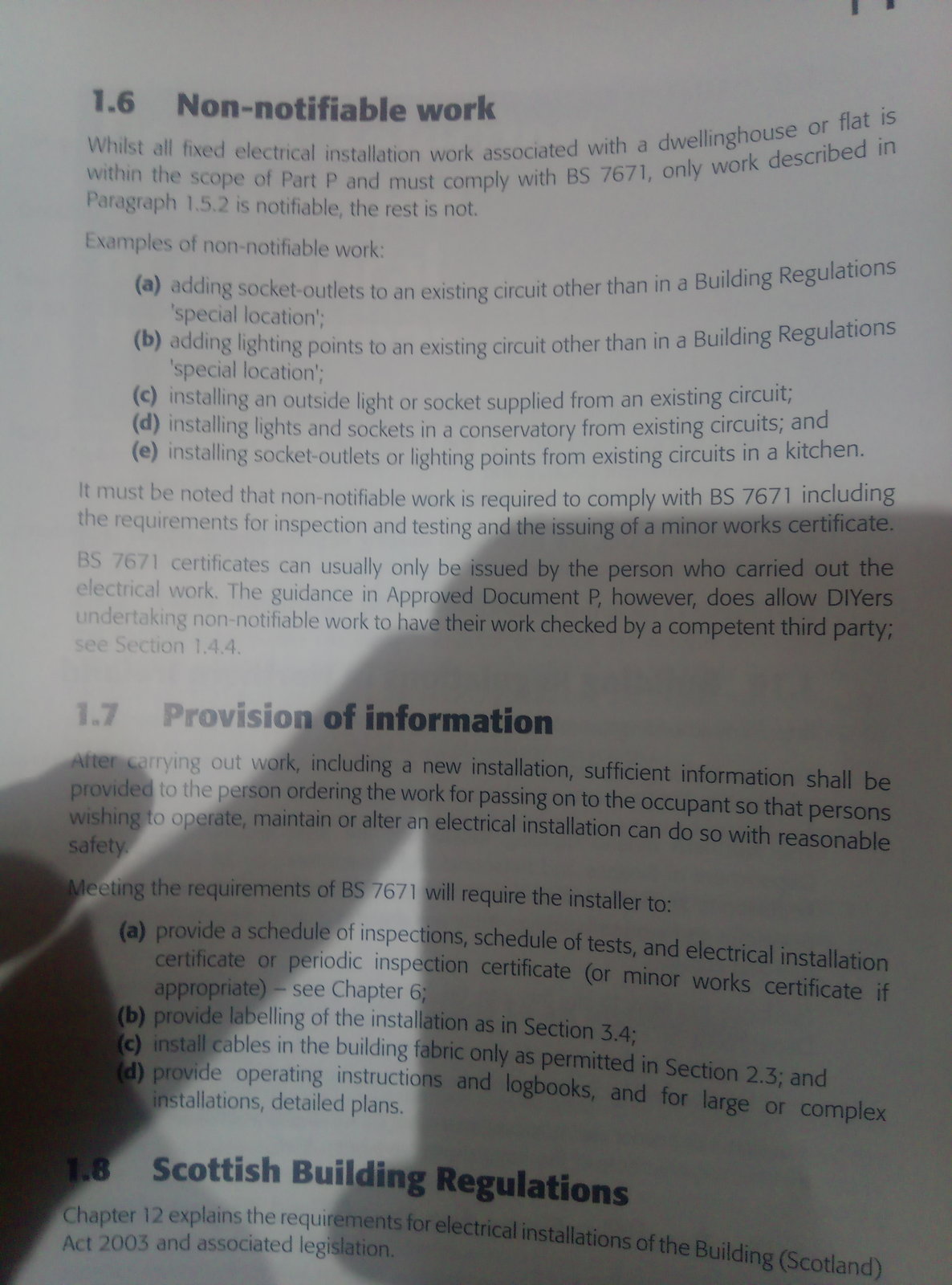

Reading from the on-site guide confirms, the person performing the work should be the person issuing the minor works cert, no mention of qualifications or schemes.Any reason why you overrule these guys?
