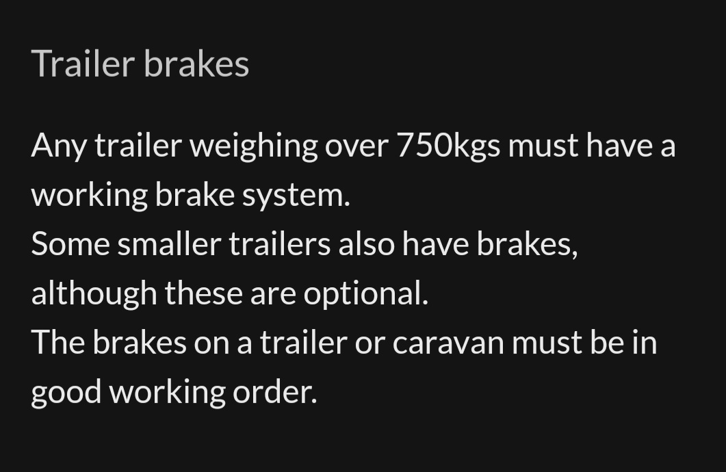

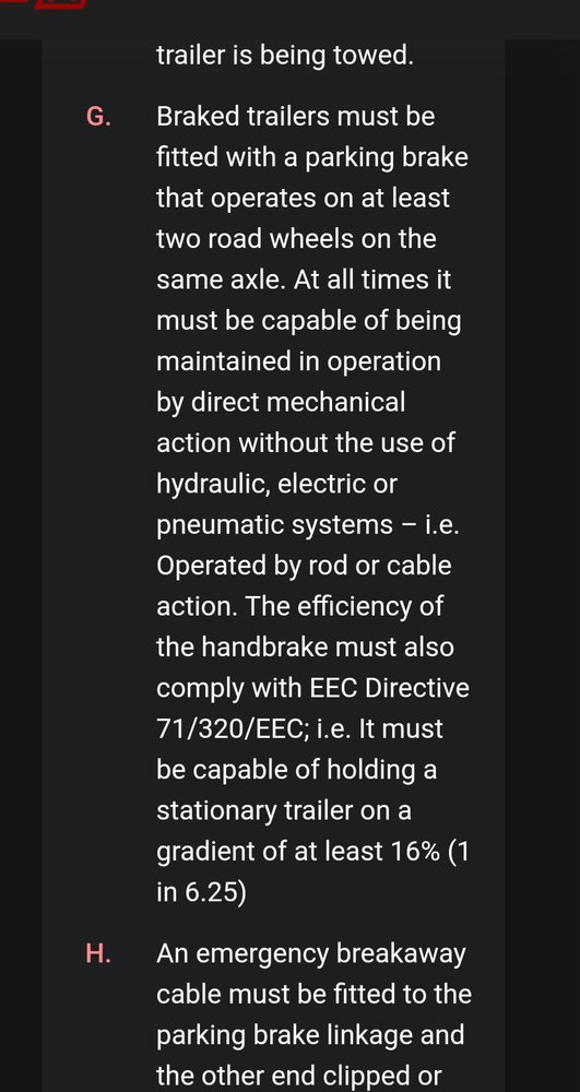

.I am also led to believe all wheels and axles must have brakes if any brakes fitted,I think this may be an alternative fact.
Some google results here:
On at least 2 Road wheels.
My twin axle trailer is about 5 years old and is a professional built trailer with chassis no and approvals etc fully road legal. It has brakes on one Axle.
Yeah i think his own youtube channel spoiled the saleits no longer listed for sale![]()
Look at C.I think this may be an alternative fact.
see info below,
