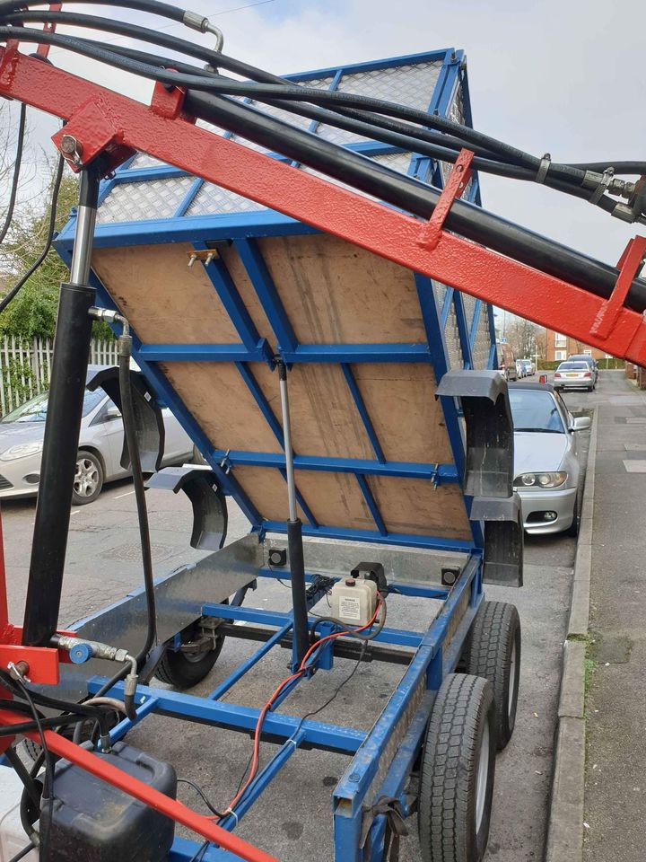

not exactly the best way to attach a shackle either ! 100% better if it was welded on 90 degrees from what it is
Improved in what way ?'I think he's seen this on ebay and 'improved' it and then got pulled for being overloaded, no docs etc as above. Idiot
the bar top and bottom of the tipper ram isnt solid across the chassis rails4.5k is miles out of bed for a home grown top heavy flimsy tipping trailer, its a nice idea poorly executed. Cant see for the life of me why he has built a doubledecker sub chassis as a base, its put all the load way too high.
would easily buckle under loadnot been critical it has a lot of weak points. i built a 7 hundred weight 2 wheel trailer and put a ton block of bricks in itLooks like the paint is doing some of the heavy lifting there!

I've not seen it "working"....Unless holding paint above ground level is a job.Looks like the paint is doing some of the heavy lifting there!

I don't think you can criticize the enthusiasm. But the price is way out. 500 quid would be to much. For that money you can get an ifor tipper and a proper monoboom hydraulic hiabLooks like the paint is doing some of the heavy lifting there!
