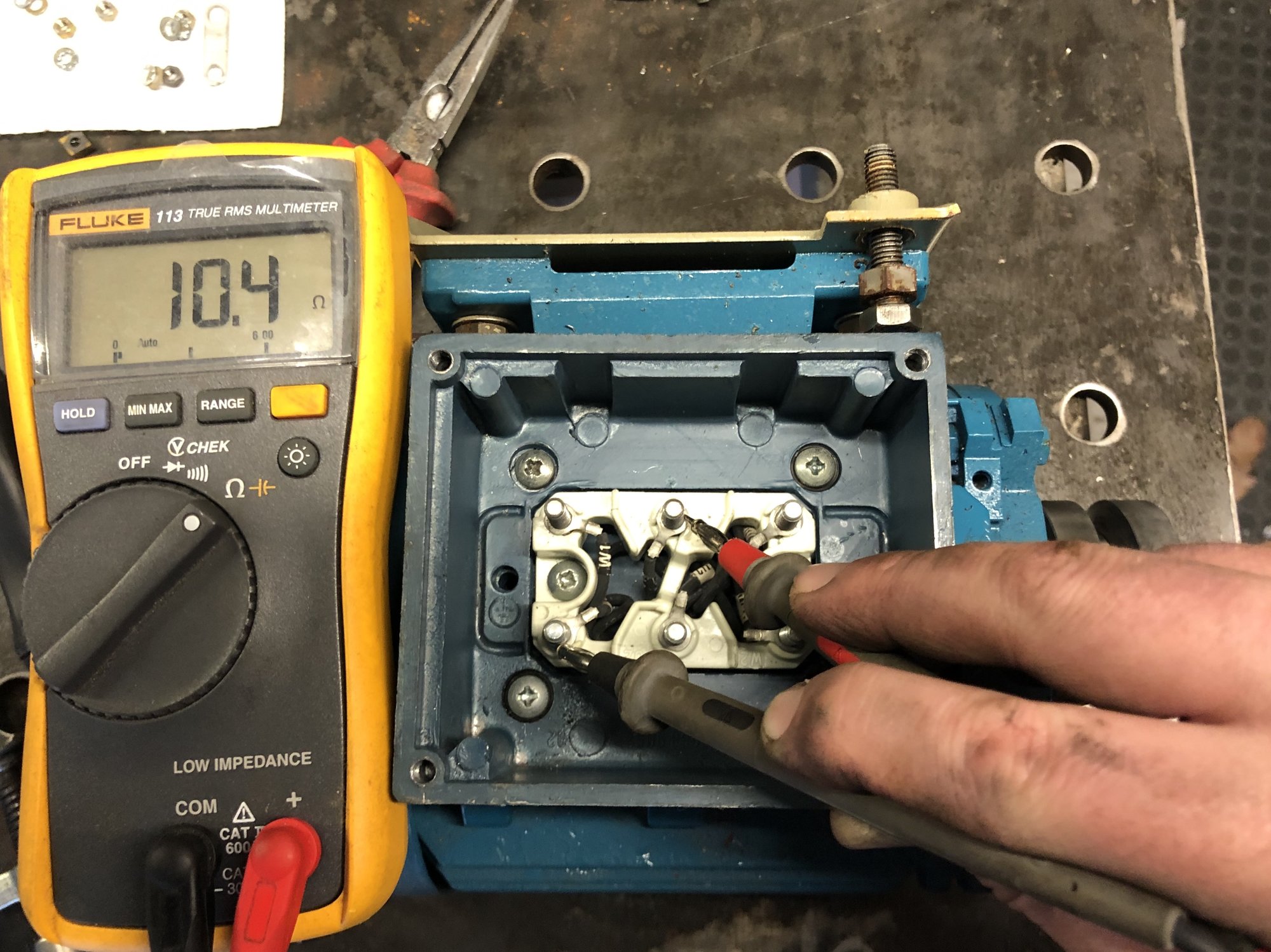

  19. R-D-R Forum Supporter
    Messages:
    1,017
    Location:
    Derbyshire - England
    Ok so pulled it out of the lathe and disconnected from the inverter I think that was throwing results but I still think I have a problem each phase is reading between 10.3 and 10.5 ohms that seems high?
  20. daleyd
    daleyd Member
    Messages:
    6,156
    Location:
    Wrexham, North Wales
    Should there be any link bars fitted?
