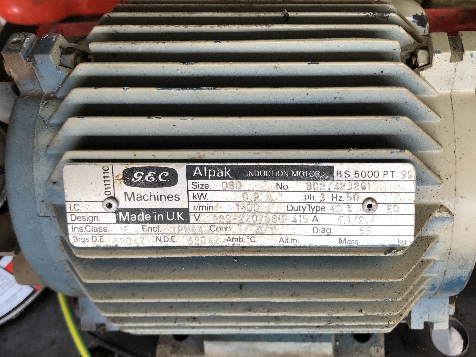

Here’s the motor plate View attachment 201531
0.9kw so not a biggy and 1400rpm.

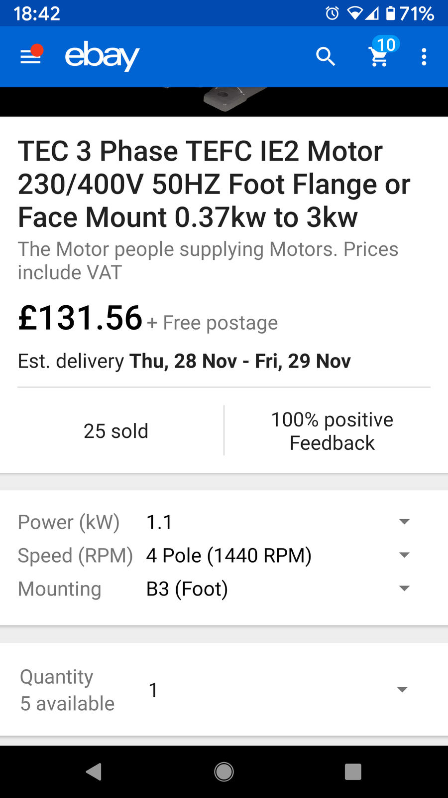

I’m thinking start the hunt for a replacement.

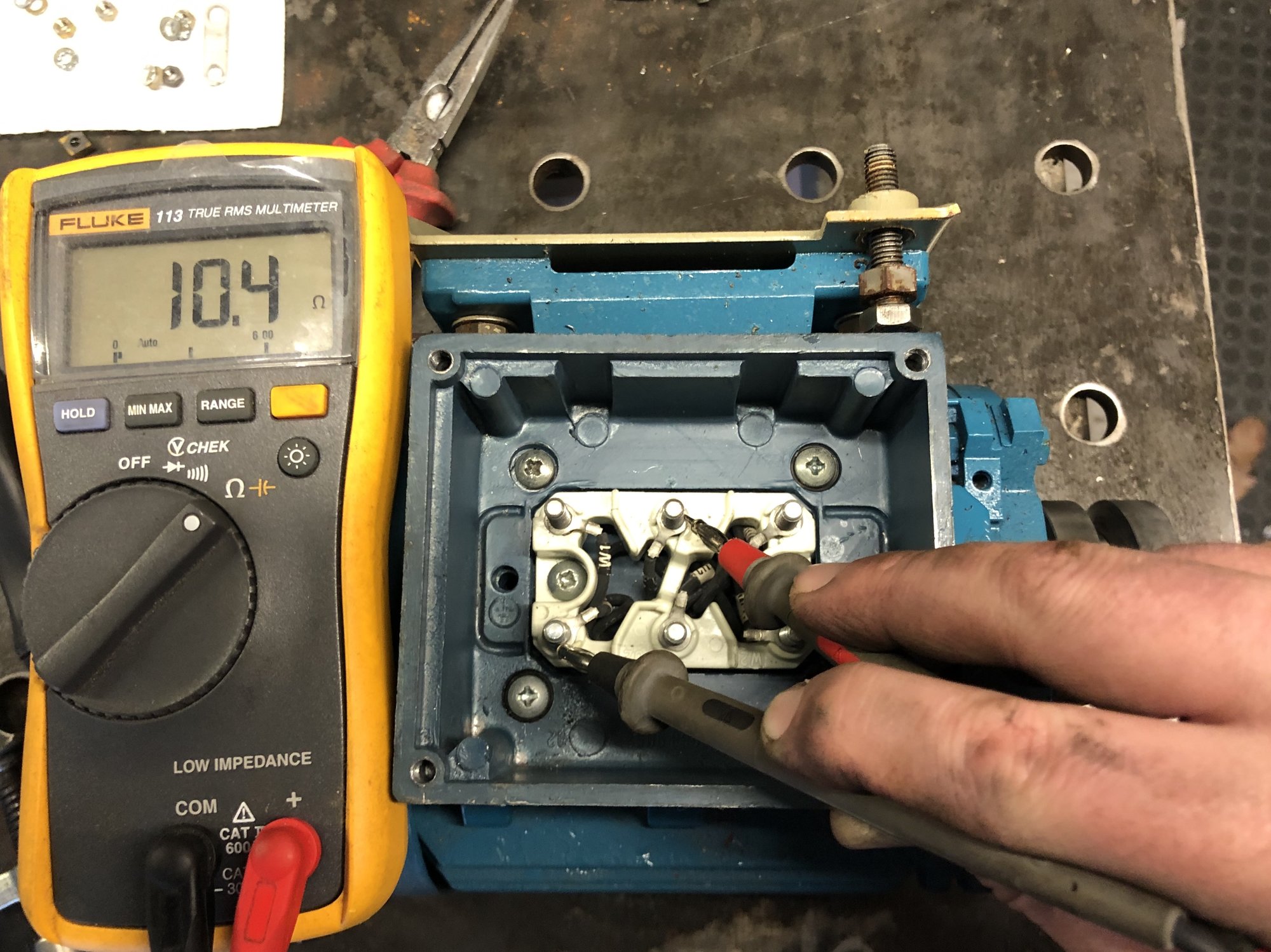

so the resistance of each winding is not exactly the same and to me seems high at +10 ohms.
Ok so pulled it out of the lathe and disconnected from the inverter I think that was throwing results but I still think I have a problem each phase is reading between 10.3 and 10.5 ohms that seems high?
