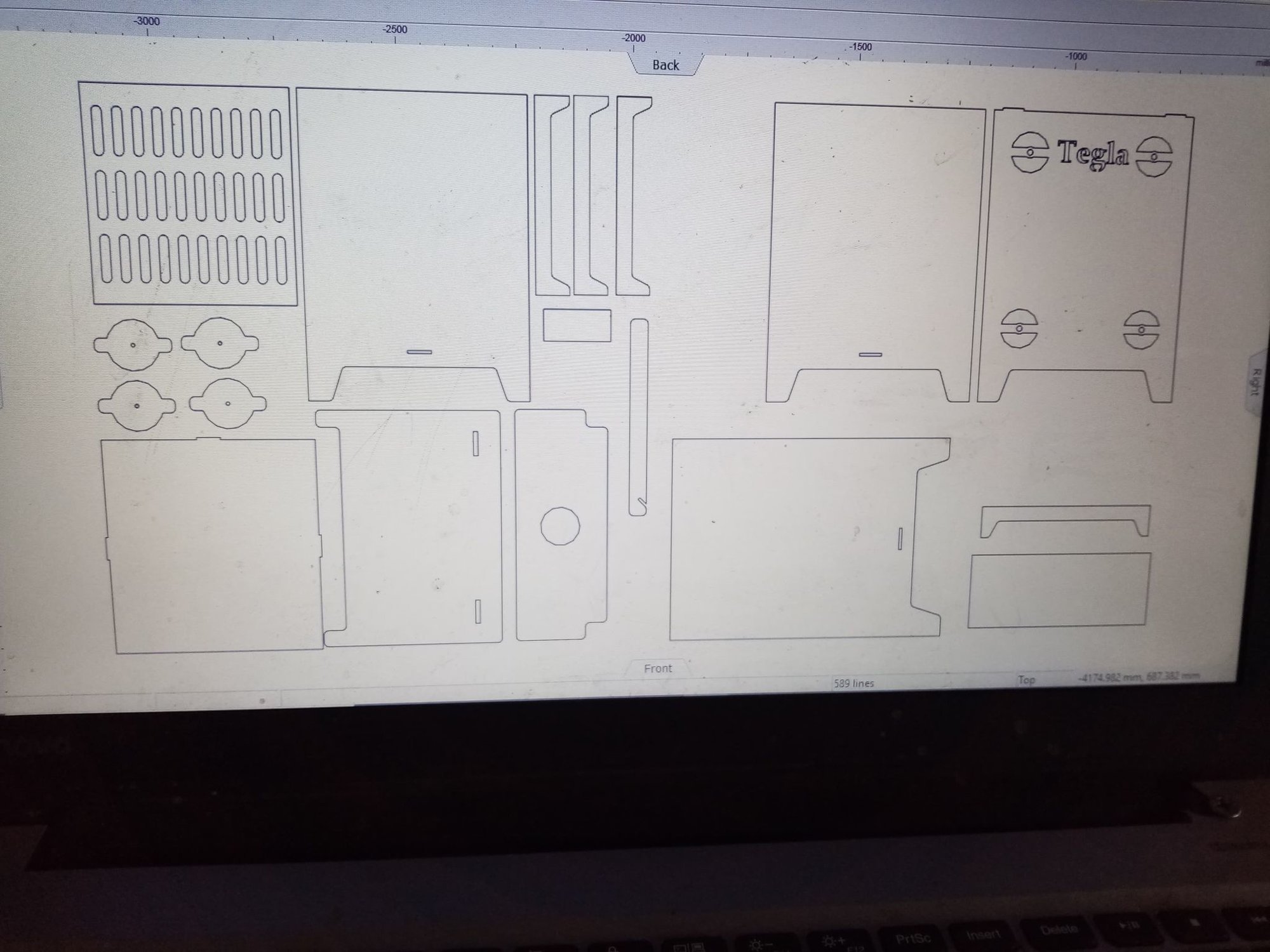

How much would you charge to supply steel and cut it out?Just had a look and as it is that design has 101 pierces, 45.6m of cutting and would take my machine 35 minutes.
I am coming to this from a woodwork and router background, so if plasma is different, please educate me...
Why is every single piece inboard of the plate edge? Is there no way to drop the plate onto the machine so that it is aligned with the axes? Does the sheet as supplied have a poor edge? If the parts are aligned with the plate edge, the total length of cut and number of mid-sheet pieces surely drops considerably. Even if the plate edge is wonky, flip the four sides so the bottom of the feet align with the plate edge. On the same issue, why does it take two parallel cuts to form each side with a small piece of waste in between? If they abut, one cut should do it. Is it just that machine time and consumables is cheaper than programmer time for a one off?
Thanks for any insight.

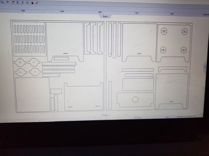

Did you do the sheet layout yourself or does the software do it automagically? If you take the gross area of all the parts, what percentage of a full sheet is it?
There might be some opportunity to split one of the larger parts into two for better nesting. The bottom RHS four parts, if removed, could be perhaps made from flat bar. Maybe consider how you might do it as a 'one sheet plus stock' design.
Would you consider uploading an ASCII dxf of the files so we can play about with it? To get it to upload here, you need to change the extension to .txt and then the person downloading has to change back to .dxf .
