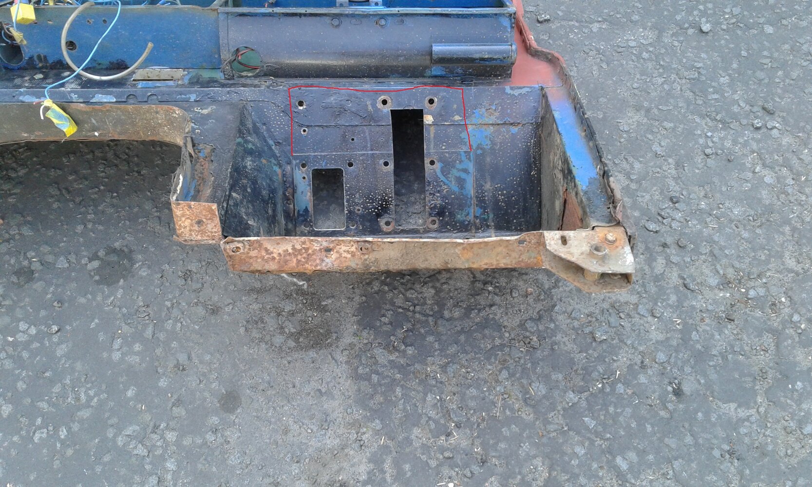

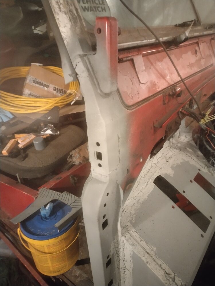

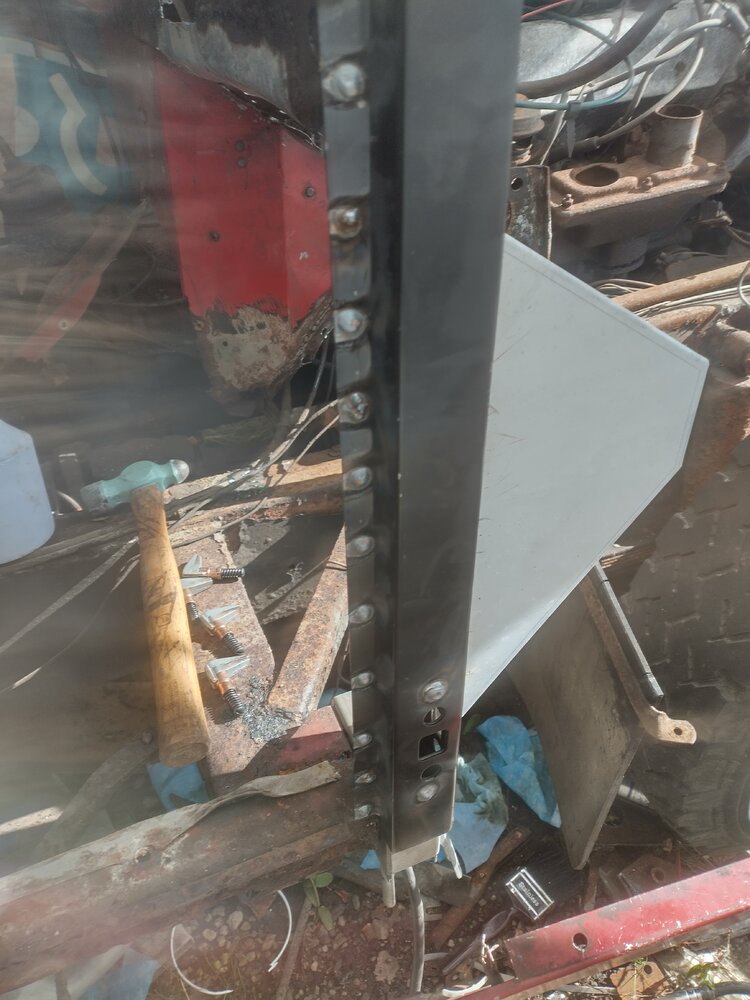

Nope, but it's almost double the thickness of the OEM footwell which didn't have reinforcement either...Did you add the reinforcement to the footwell for the larger servo brake tower, as well as the bigger hole?
If needed I can add it easily enough as we're a long way from being buttoned up.

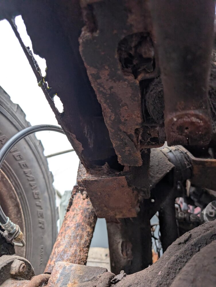

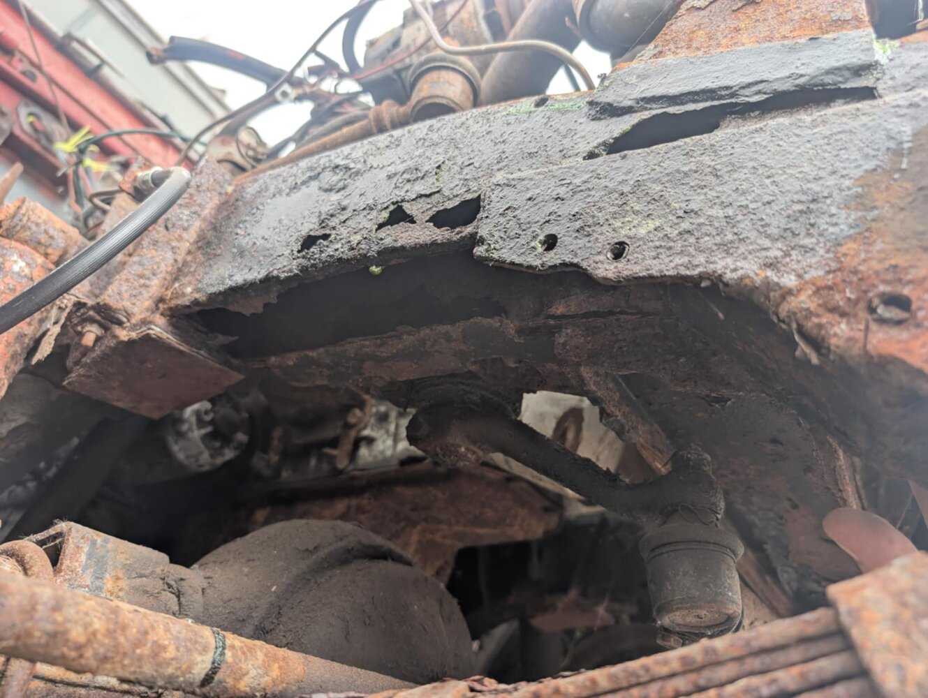

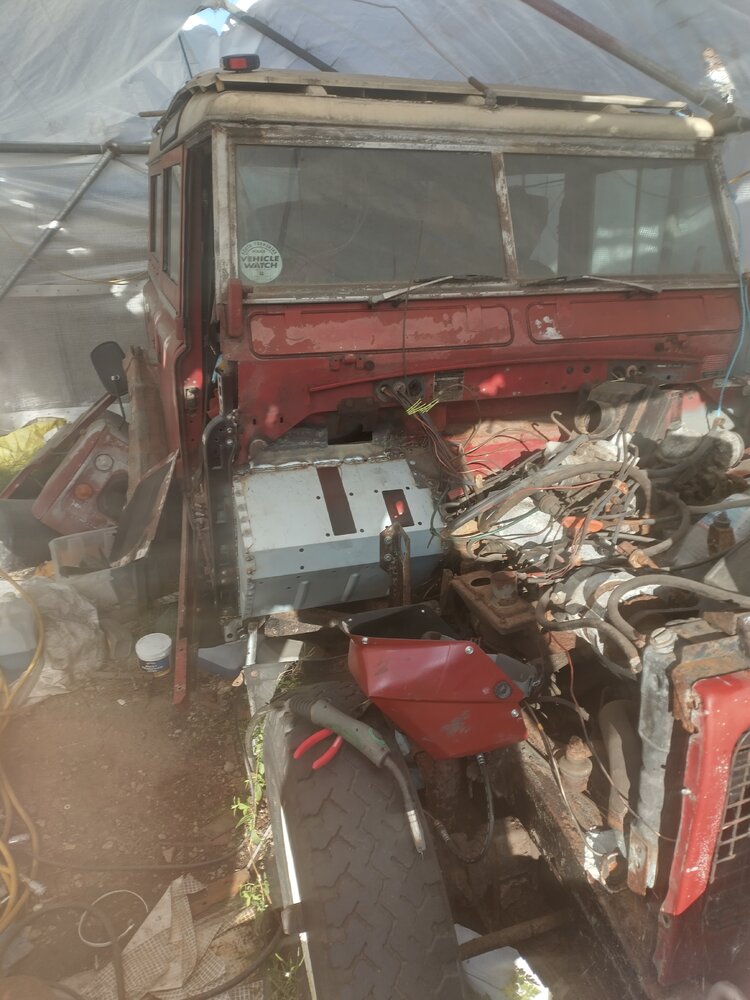

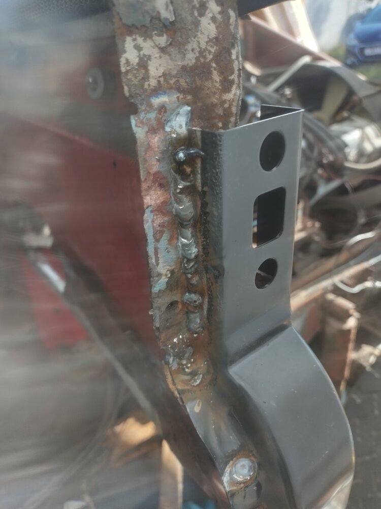

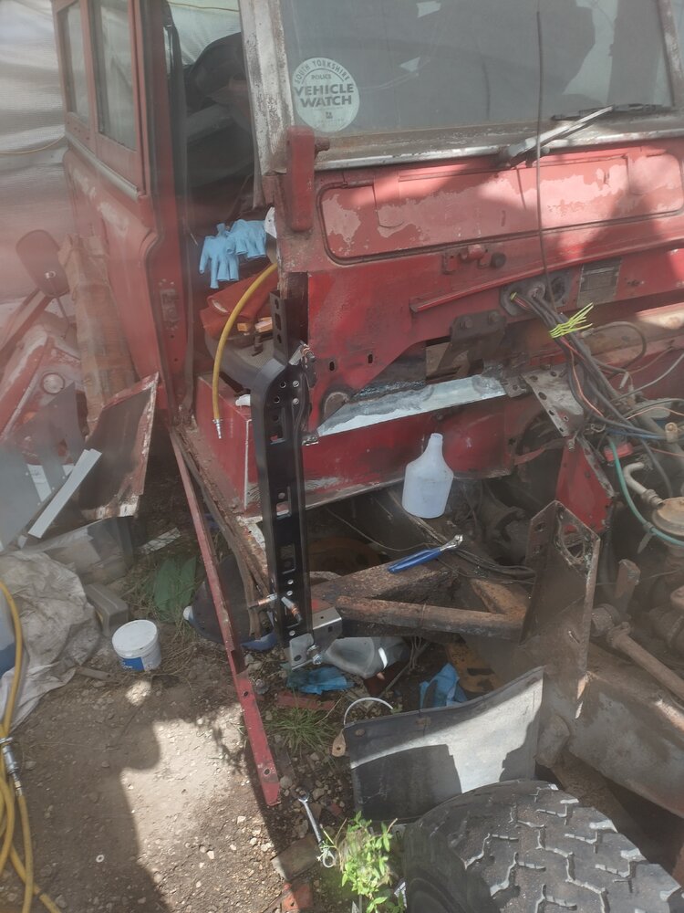

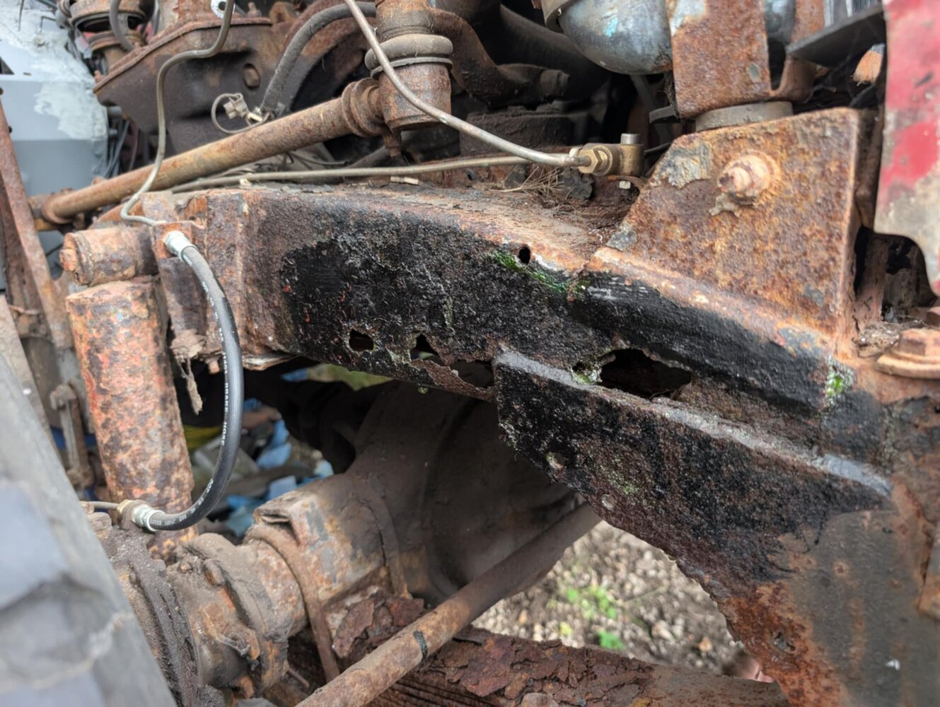

As far as I can tell with a hammer and a pokey stick it's actually in really good nic.How bad is the front cross member?
What seems to have happened is that someone applied a bitumen coating to the outside of the chassis, it failed in areas subject to the worst road spray, and trapped water causing it to rust outside-in whilst it was sat in the hedge, very badly but in very localised regions.

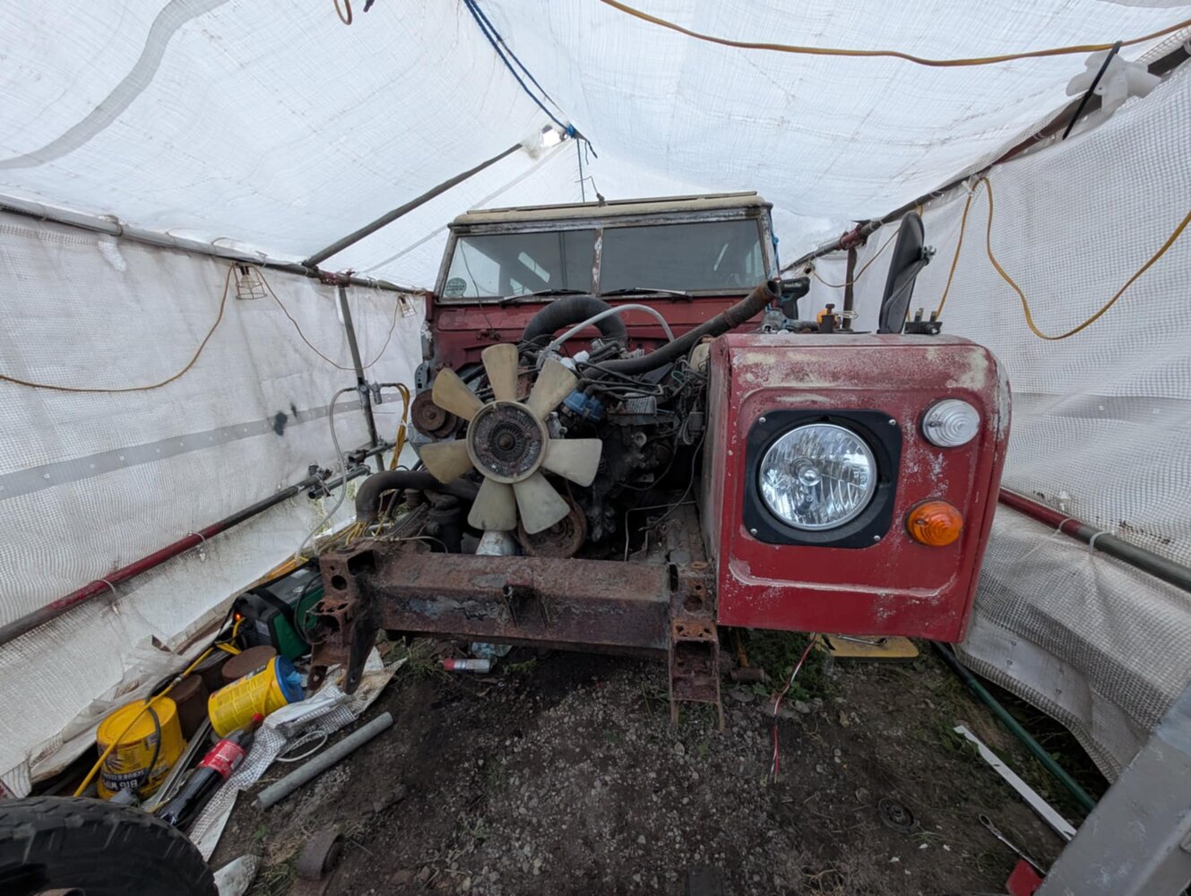

For one thing, I don't own a TV!Do you guys renovate these basket cases for Fun/ necessity / the challenge or just to avoid watching the T.V. ? Serious question as I just cannot see why.

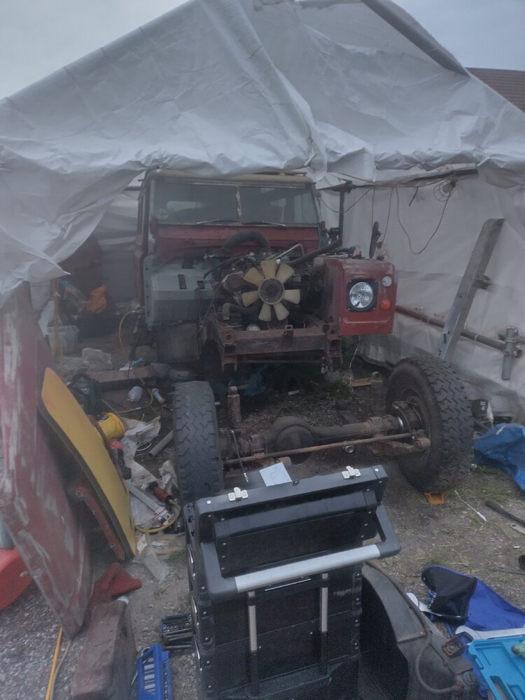

In this case, rebuilding a Landie is something I have wanted to do since I was about 12, and it wasn't meant to get anywhere near this bad when I committed, but I kept (keep) finding problems
I think it helps to keep me going that the Stage 1 V8 Station Wagons are fairly rare, and this one in particular has a very unique provenance (it was in a bunch of the LR marketing brochures and press coverage), and is in highly original condition...
So if I can get it repaired to a decent standard in a sympathetic way, it's probably worth significantly more than it otherwise would be...
I might even break even if I sell it!!!
