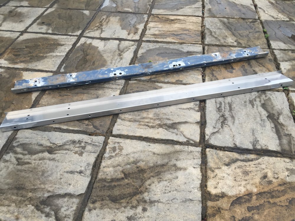

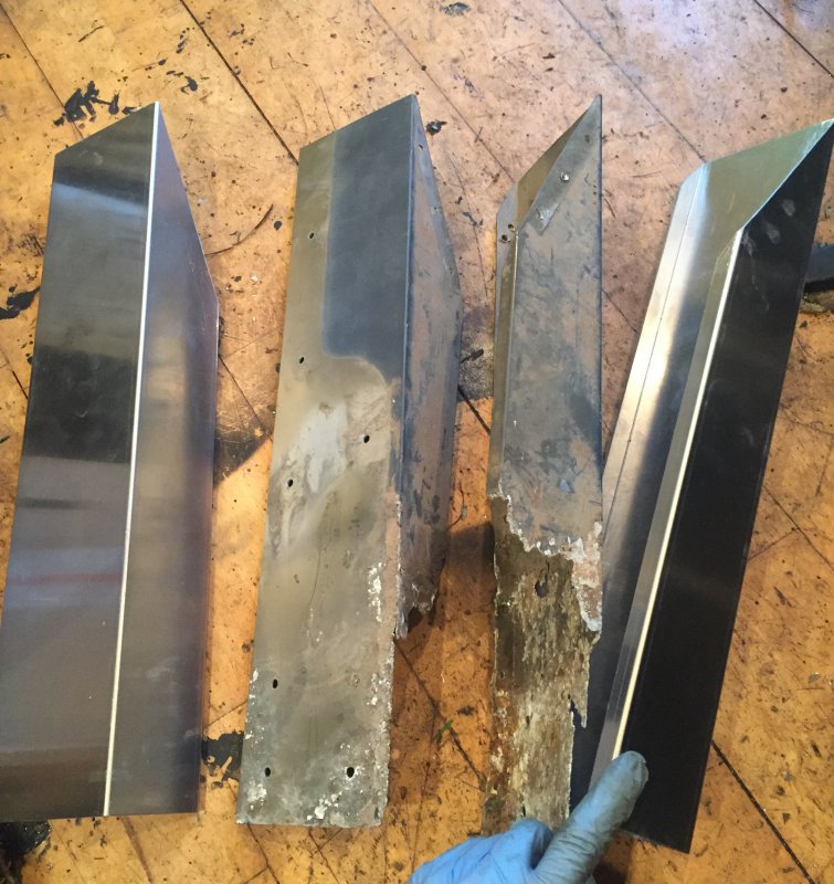

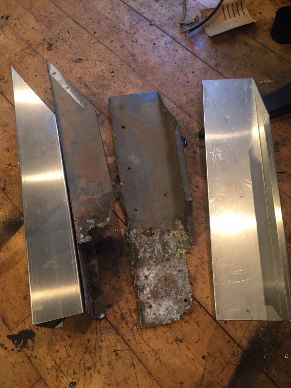

can't wait to get it done and fitted. I may leave the rear lights un cut till I put body on. Last thing I want is to cut them the wrong size
that'll sort that out

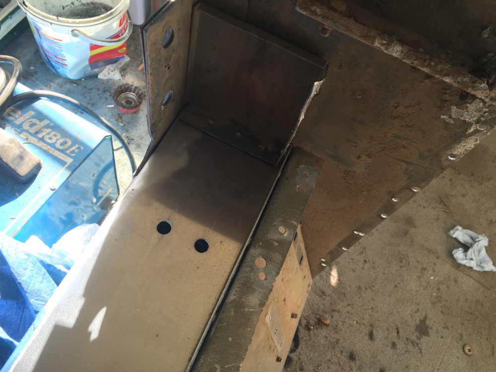

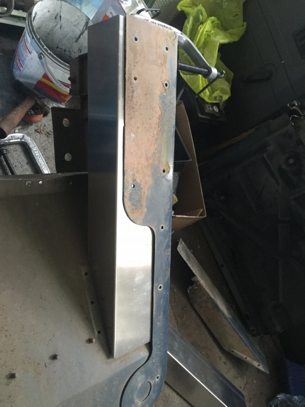

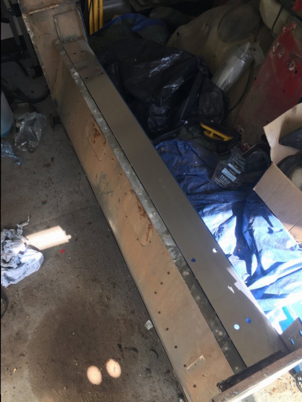

looks brilliant I think. Just need that final bit back and I can assemble it and drop the whole thing to be plug welded up.
