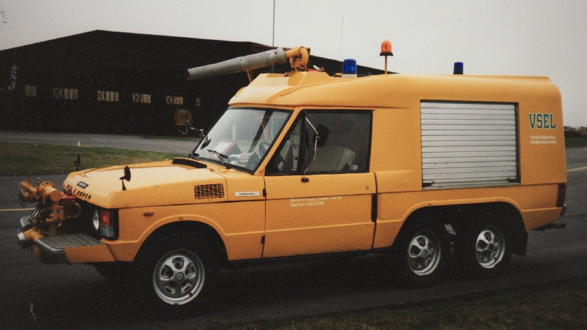

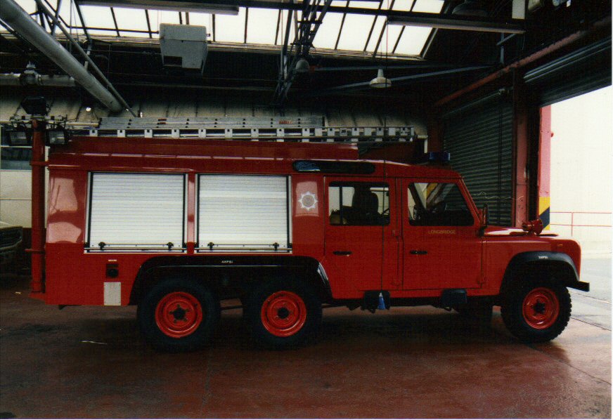

The problem I can see with the 6x6 is that the rear 2 axles prop shaft will be that short that you wouldn't get any reasonable articulation before the shaft snapped, I would however like to see one with a walking beam axle set up like the scammells
