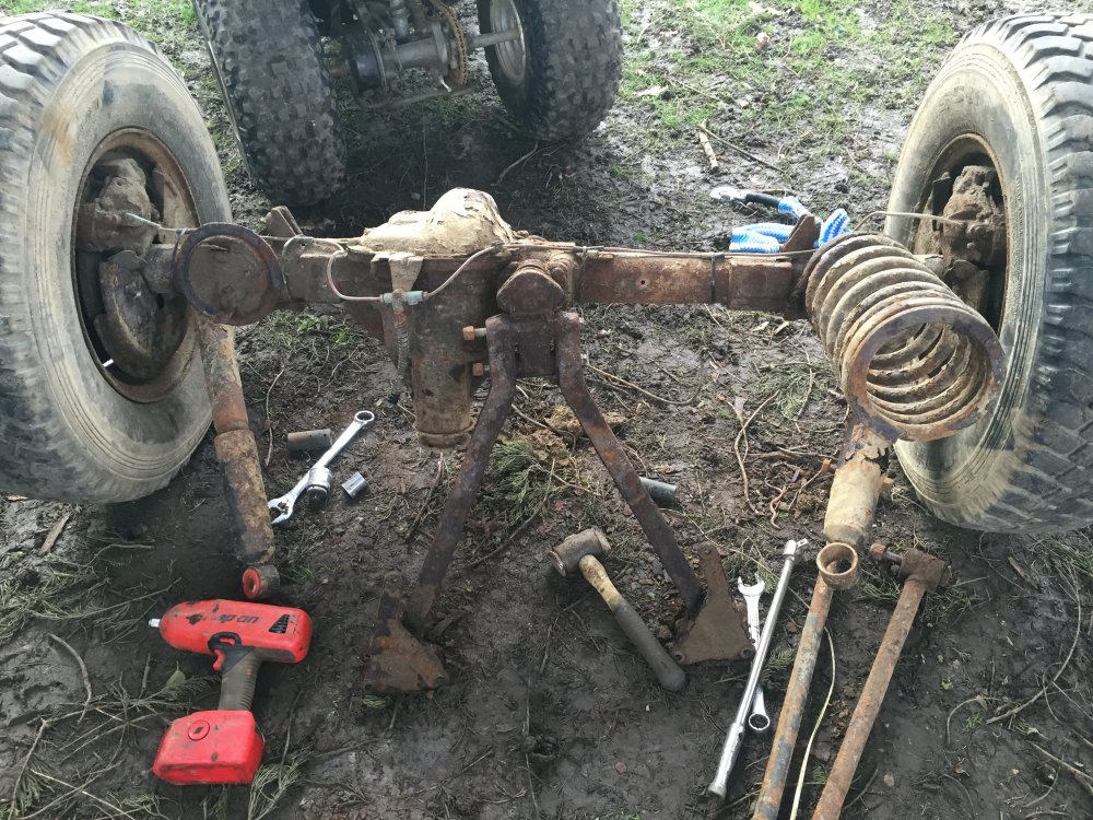

You have the easy option of a complete unit or just replace the balljoint if you have access to a BIG press, I've used the Lemforder ones in the past as they are OE suppliers to Land Rover.
Top tip: use allthread or bolts with the heads removed screwed into the tapped holes to guide the balljoint in so the holes line up for the fixing bolts, I've seen a couple that "missed" that had been drilled and bolted, but the extra holes weaken the housing.
