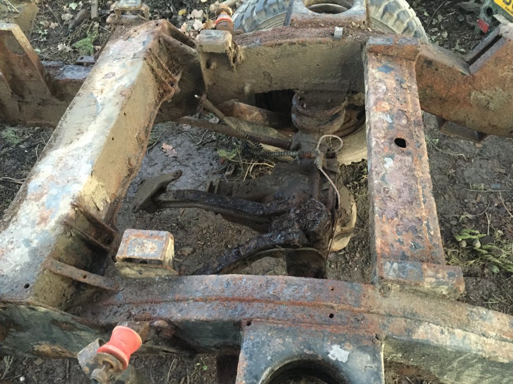

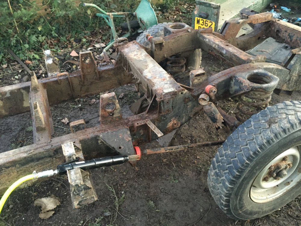

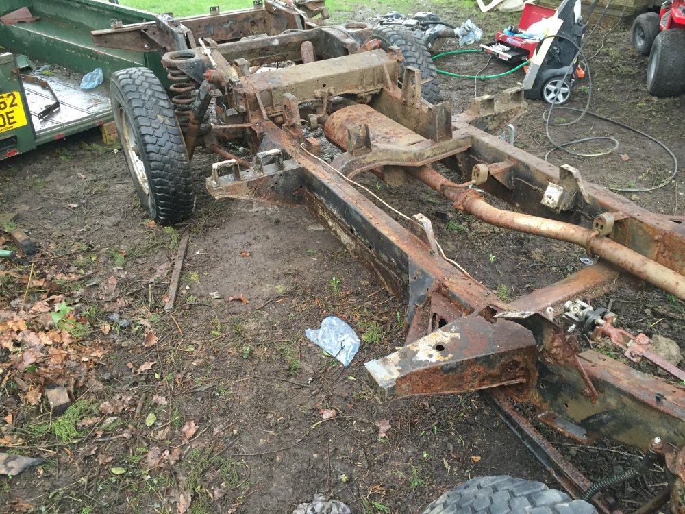

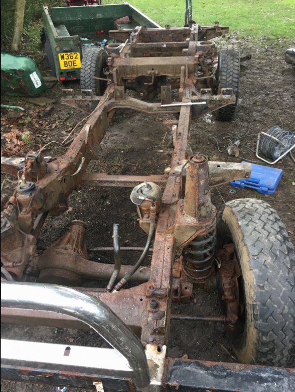

Spent 30mins trying to unscrew one tow bar bolt and still didn't get it off.
If it's one of the 2 lower ones going through the chassis you're better off cutting/grinding the bolt as you are getting a new chassis

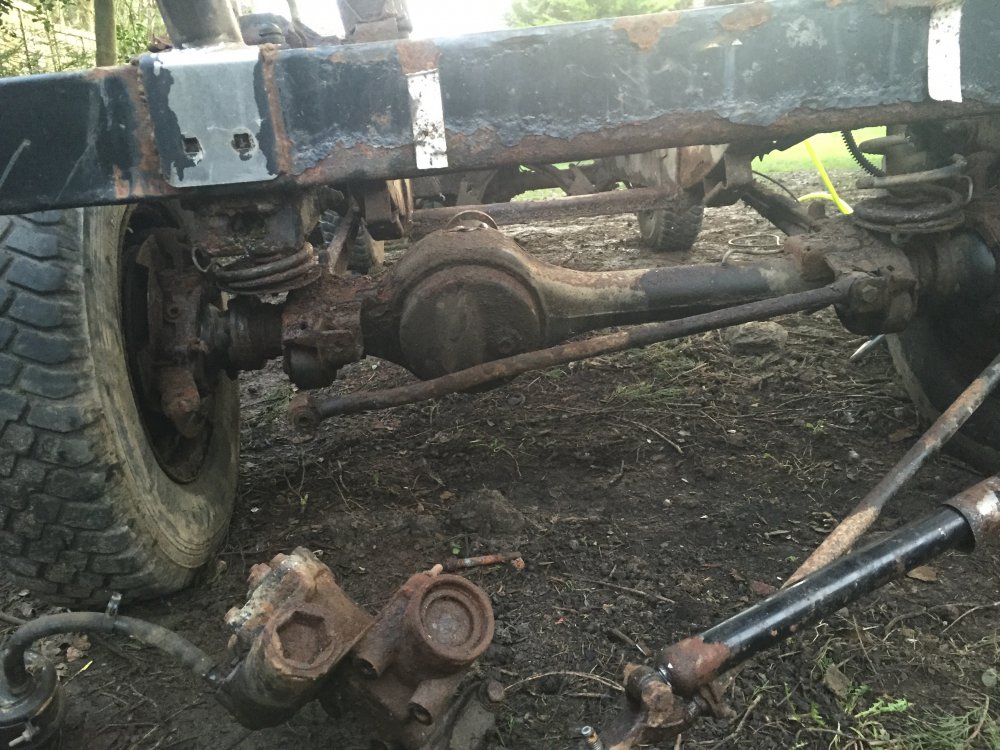

then get chassis end of next week and prep that.A frame on the rear axle ? I've been told how hard that is to get offChange the ball joint on the A frame before you put it back together - it's a sow of a job to do when everything is back together.
A frame on the rear axle ? I've been told how hard that is to get off![]()
I'm not looking forward to that thenThat's the one. Took a 30 tonne press, a good deal of heat and the judicious use of BFH to change mine.
. the chassis doesnt look that bad, I have seen far worse with an mot.

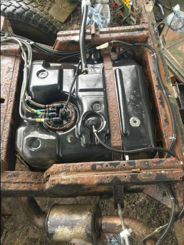

I snapped the little plastic ends on the fuel pipes that fit into the pump on my 110, the new pipes were a fortune to replace as you can't get the ends on their own.
I ended up turning up some replica end pieces out of aluminium and used rubber fuel hose instead of the plastic pipe.
Great idea but £550 :O I'm having to order bolt sets but whatever isn't to the galvanising I'm using stainless as long as it's not a suspension component. Don't want my axles fallig off lolI was looking for a chap who advertised in the LR mags who did fastener sets as I'd found him good on previous rebuilds, no luck but did find this don't know if it's of any help?
I'll be doing that then lolWhen we did my sons 90, we bought the ball joint complete with the bracket & just unbolted it. Saved pressing out the old one, as the complete thing was not much dearer than the joint on its own.
If you are replacing the brake lines I can recommend Automec brake pipes and customer services is also good.
I fitted them to my 110(the complete set). The rear axle one was a little longer than expected but with the 110 in bits you could probably get the pipes routed better than lying on your back in the drive!
http://www.paddockspares.com/fulcrum-bracket.html, from Paddock it £40 odd, but I don't remember it being as dear as that, I will ask my son where he got it. As the joints about £12 I would have changed it.
What I have done to remove large ball joints, when the rear of the joint protrudes through the housing is to grind the rear of the joint away, then drive the ball out of the back. Then you can split the joint remains with a hacksaw carefully & drive it out with a hammer. the new one can be pressed in relatively easily. I don't know if this is possible, it all depends if you can get at the back of the joint. I had to do this on my T2 VW steering when my friends press gave up at 30 tons
