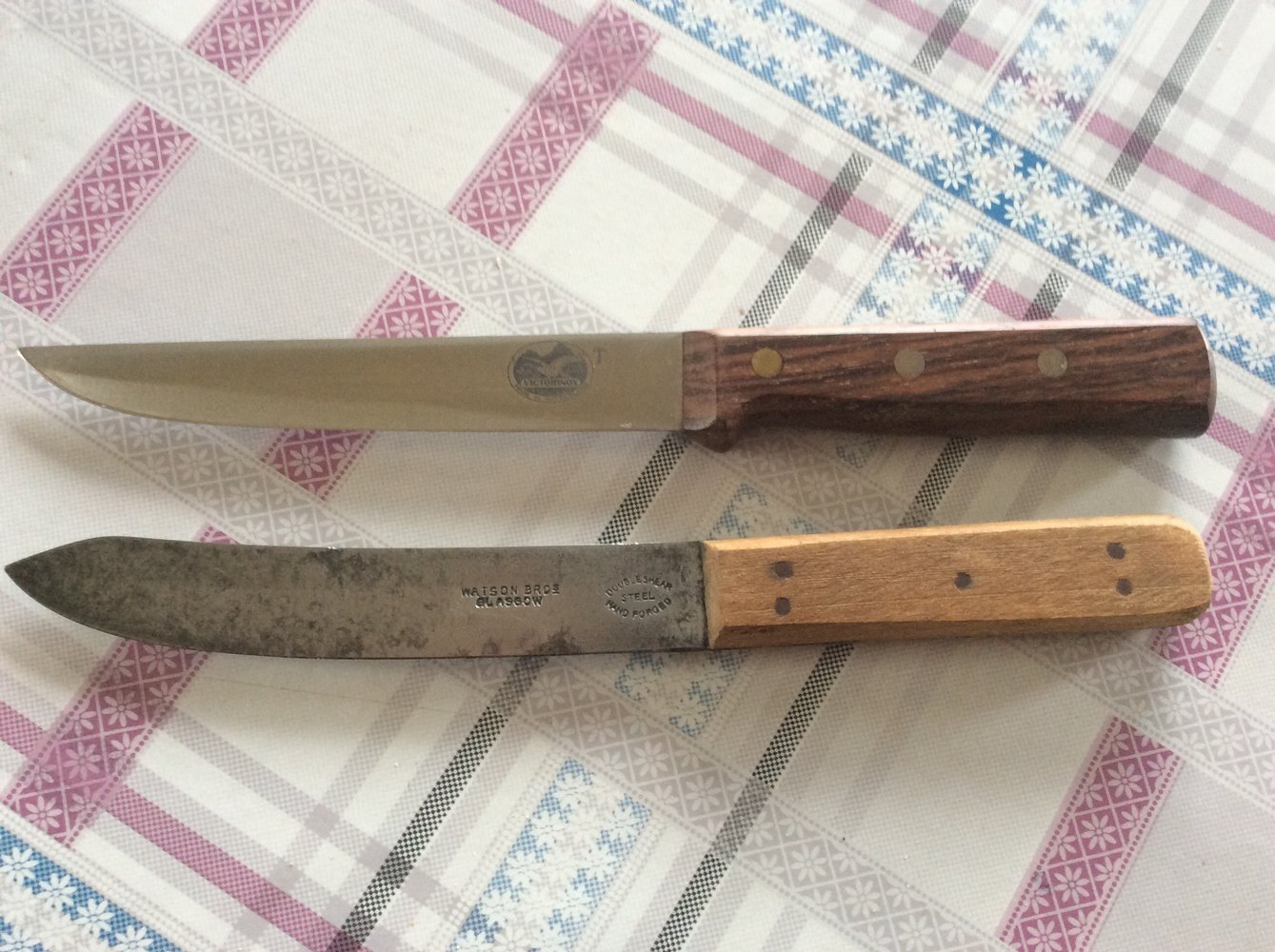

Stick one end on the coarse grindstone ...loads of bright 3/4 inch long tailed sparks & it's high carbon steel.Cheers folks
I've only got one bit but it's quite long about 5 feet so can have a few attempts
Planning on trying to make a basic knife I can put and edge on them to razor sharp fine but have never made one before from scratch.
I thinking to use a stock removal method and then heat treat with my blower and brake drum forge using coal.
Not terribly worried about the look of it or corrosion resistance it isn't being used in a fancy kitchen.
@Screwdriver it appears they reccomended that type of use in the red advert I copied into the post , talking about reamers etc and about its hardness and toughness
@hotponyshoes , very good idea I atleast know the exact steel but may be hard to find out those parameters if they last traded in the 60s so will have a bit of research
Might end up ordering a steel but I do prefer to use what I have lying around and I like the history of this steel so worth a shot.

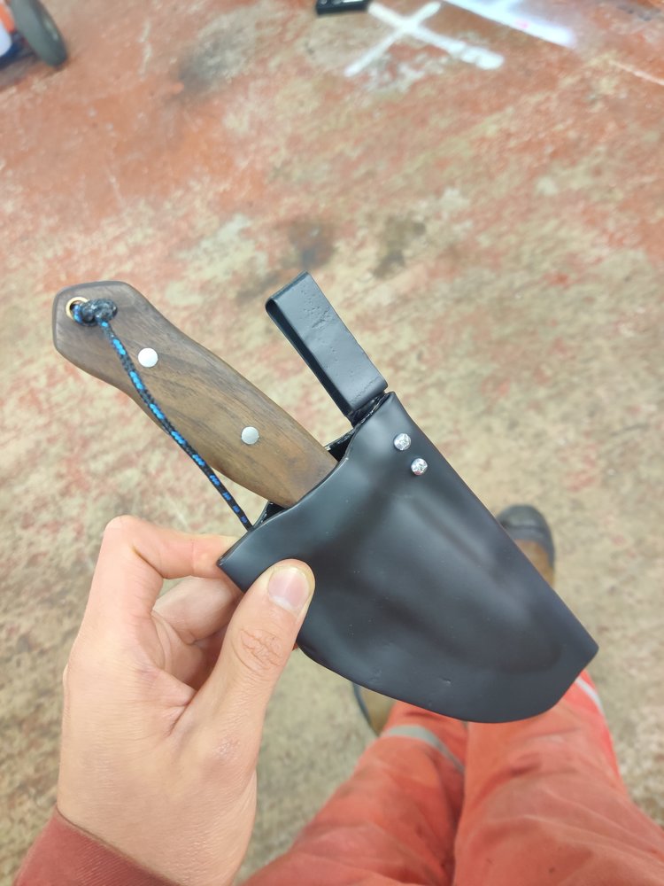

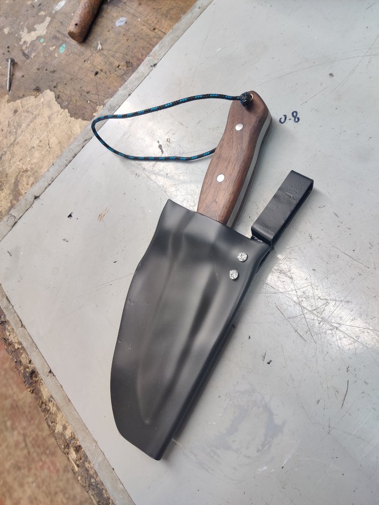

Thats great mate well done. Giz a shout if you need anymore leatherWell I suppose this is probably the final installment in the total build
Big thanks to @magnet for helping out with this one much appreciated pal
Don't think I would make a good leather worker this took ages and isn't even neat
I did get a bit faster onto the end so will have a go at an axe sheath now I have a tiny idea what I'm doing

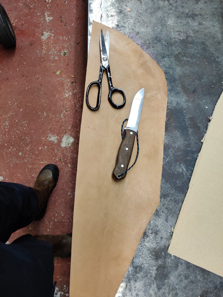

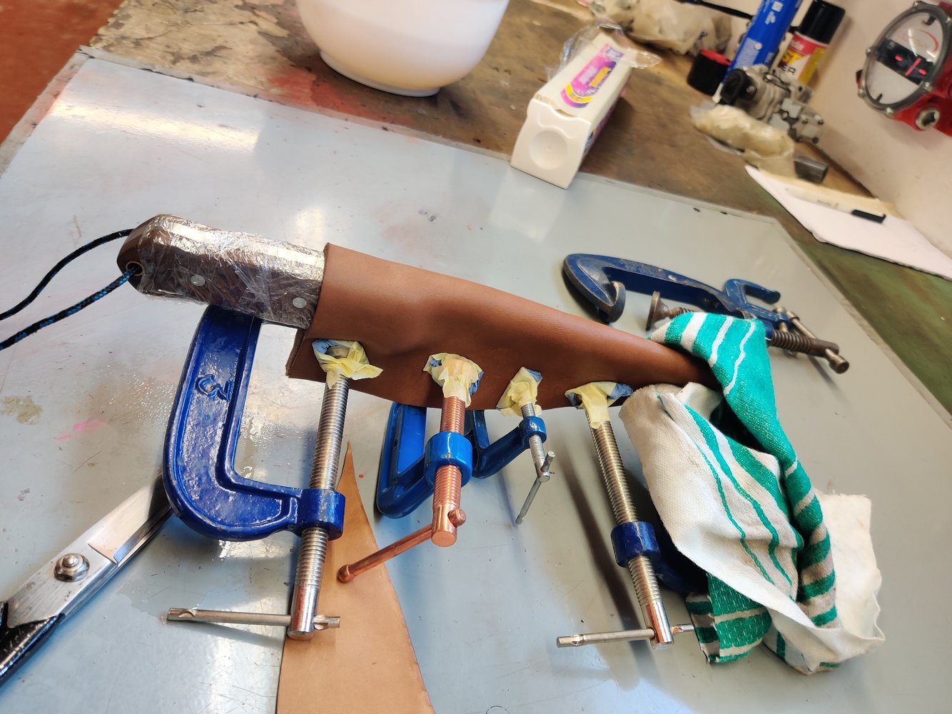

Started with 3mm thick leather

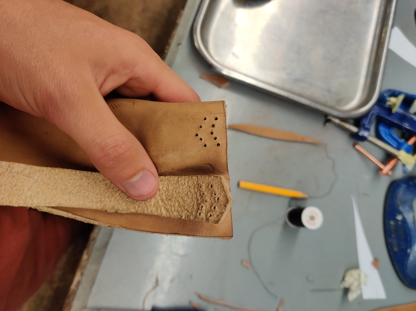

Then cut a rough template out around the knife allowing a inch and a half ish for room , this is then soaked in warm water to get it plyable , I was surprised how plyable it became very very soft so soft I managed to dent it with tissue paper on the end of the clamps whoops

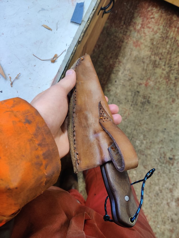

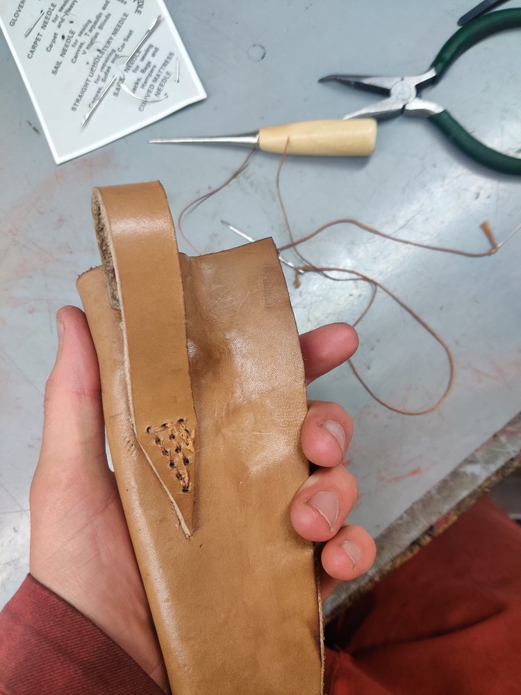

Belt loop cut from an offcut , drilled holes.for sticking as it was a bit heavy for my awl it seemed
Don't think the stitching wins any awards but it's holding it good n tight
Same technique on the edge bevel but expect I had another bit of leather cut to fit between the fold to give it a bit of a gap for the knife blade to go into aswell as stopping the possibility of the threads being cut

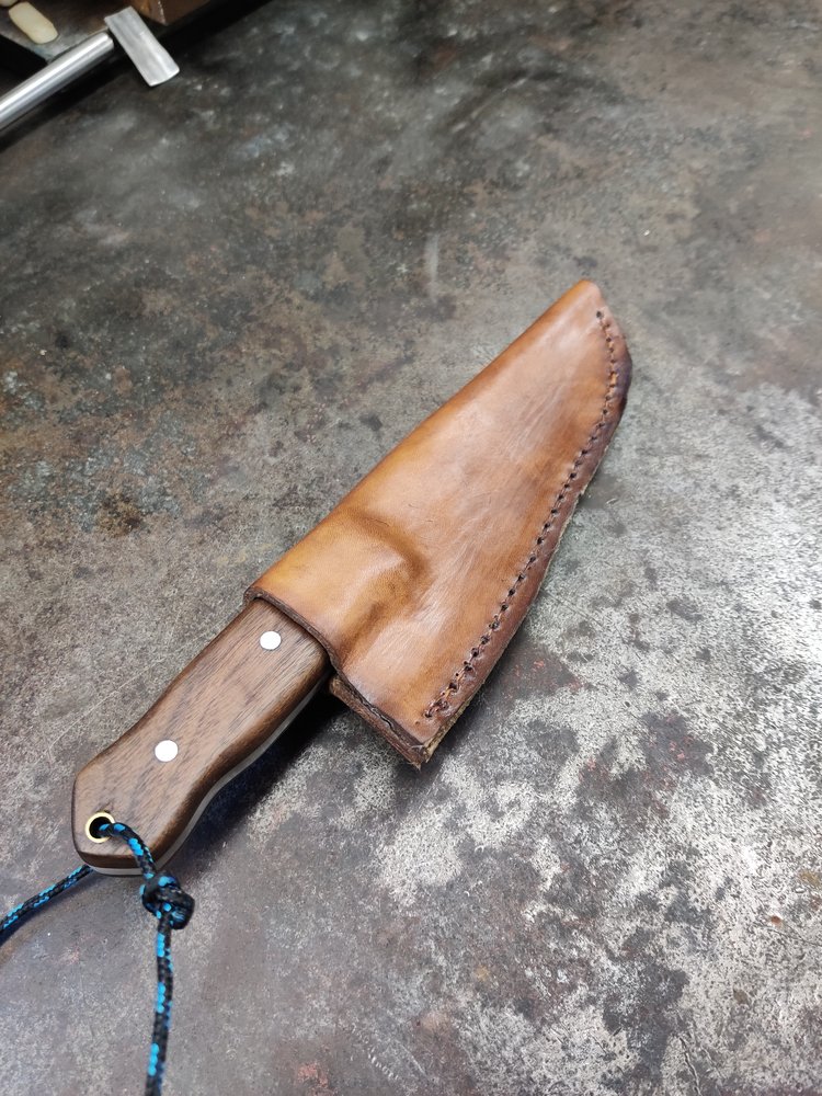

And the finished product with some beeswax oil mix for finishing
