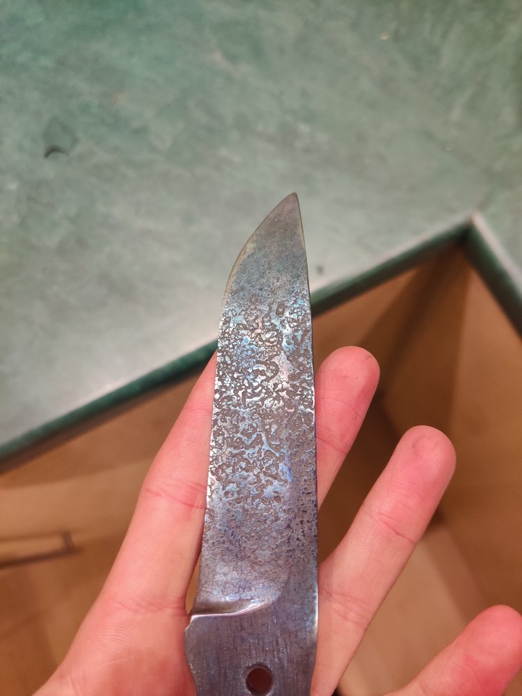

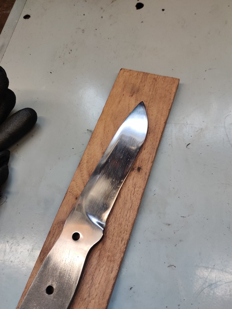

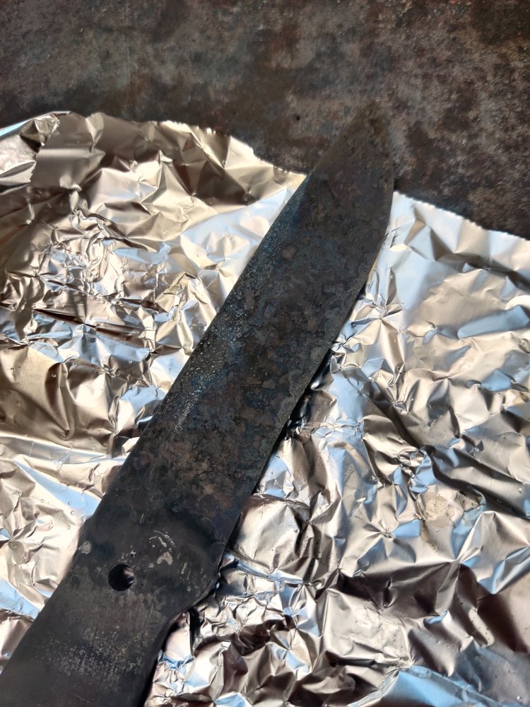

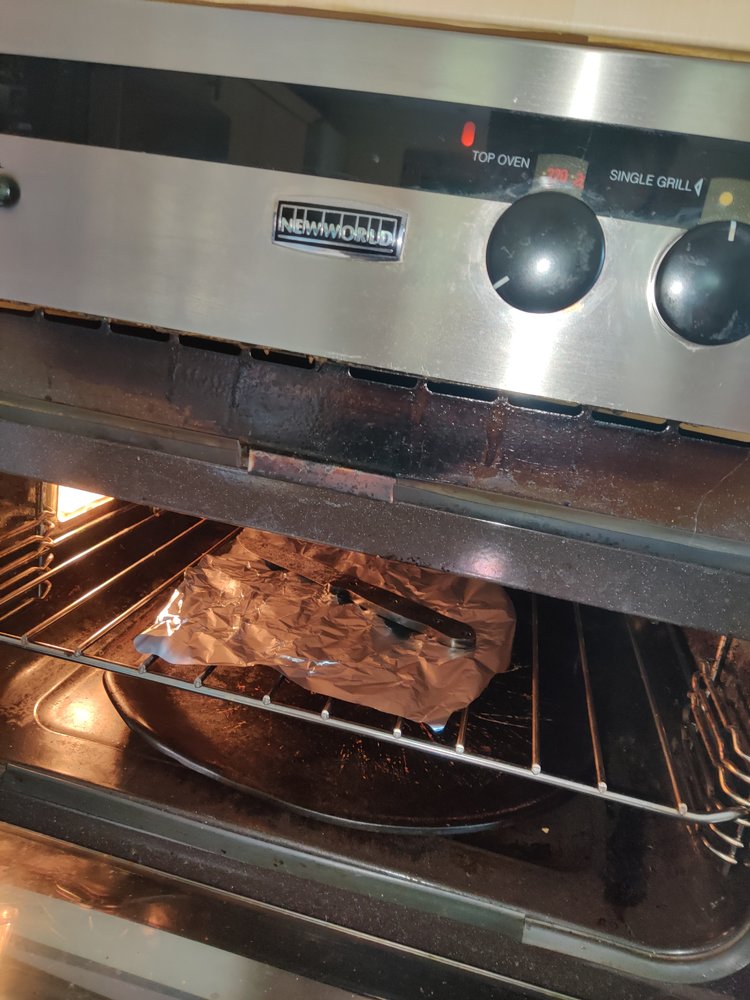

This is the latest knife I'm playing with from an old file, it's had an hour at 180 it's what I do all my knives at, but we've got a hardness tester at work so if they're a bit hard I can put them in again at a higher temp so far they've all been good. This only had althe edge heated up for the quench so I'm happy as is.Time to go in oven for another 2 hours , will see if the shiny steel changes to straw colour I hope for the temper

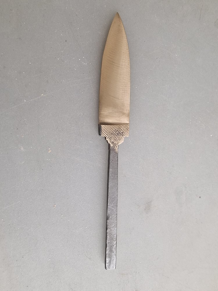

Looking good , Seems to have a bit of colour to it? . My blade is quite thick so may need a longer heat time.This is the latest knife I'm playing with from an old file, it's had an hour at 180 it's what I do all my knives at, but we've got a hardness tester at work so if they're a bit hard I can put them in again at a higher temp so far they've all been good. This only had althe edge heated up for the quench so I'm happy as is.
