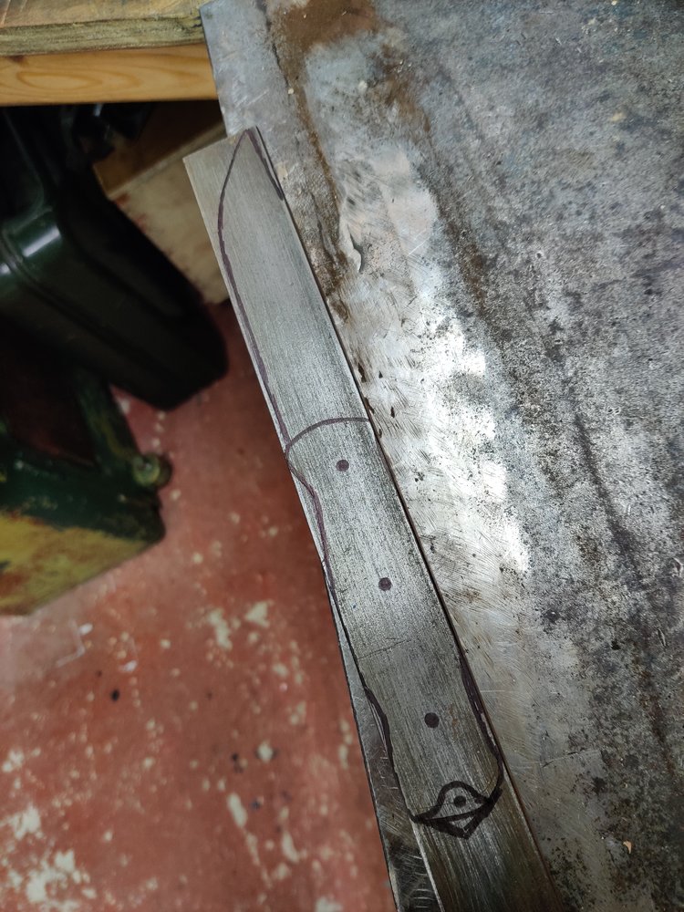

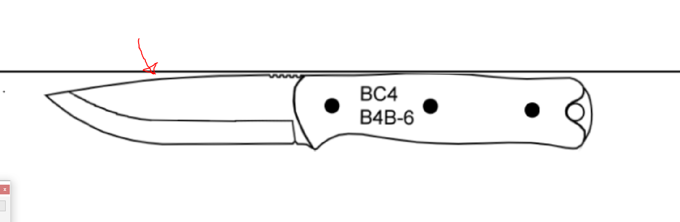

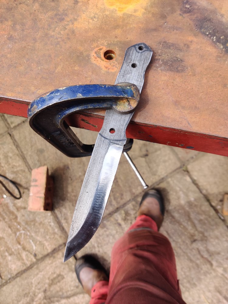

I think you will find with that design, it should have a very subtle curve all the way along the spine. Makes a huge difference to the look...

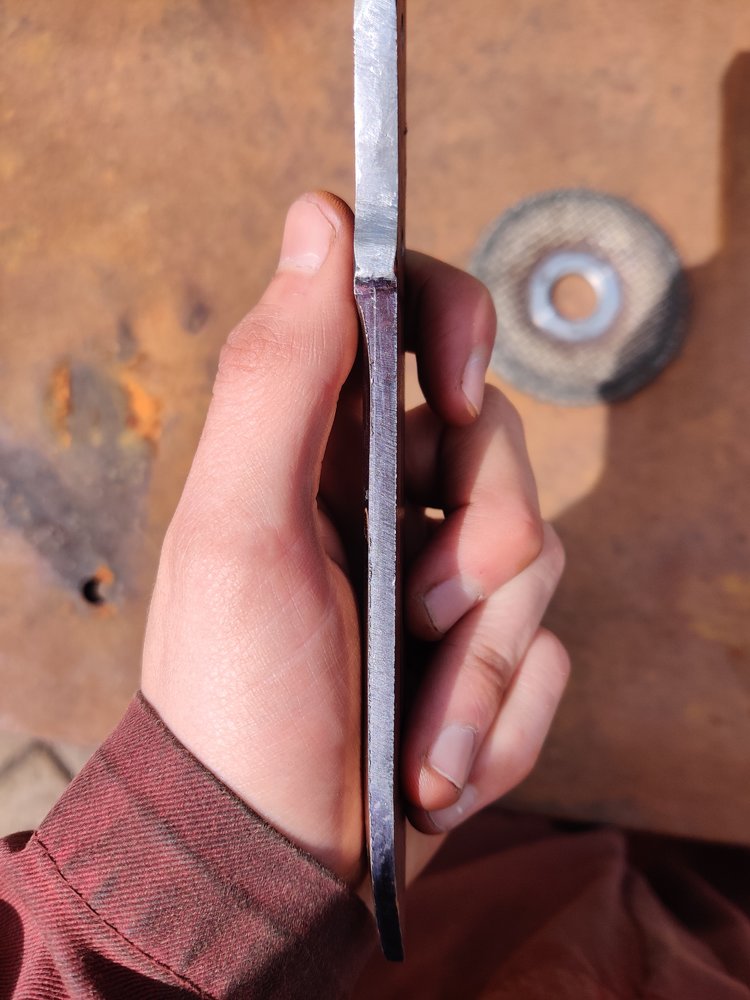

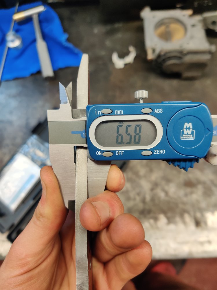

Cheers it's about 6.5mm thick so yes quite a thick bladeLooks good, how thick is the stock you started with? Looks thick, you might want to take the bevels up higher so it's not such a stout edge if it is as thick as it looks.

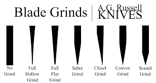

Brilliant cheers I will got for the full flat type grindThat's a thick spine. On something that thick I would go full flat grind. You can see why below, you will get a better slicer. It will be more like an axe edge like that I would think with such a thick spine.
You don't need to go all the way to the top but if it was me I would go pretty close. More work but hopefully you will get a more useable knife when you're done.
When I first started I made the mistake of making really thick knives which were obviously strong but just weren't good at cutting. Now I try to make them max 4mm thick spine for that size knife. I realise that's no use to you because the stock you have is 6.5mm but doing a higher grind will make it better.

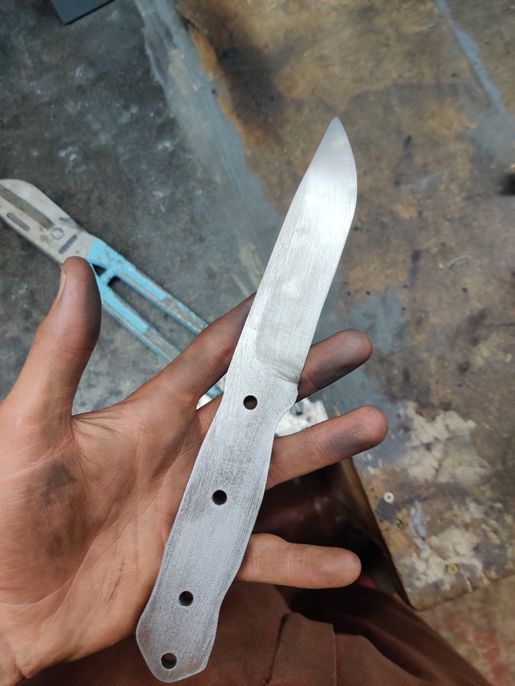

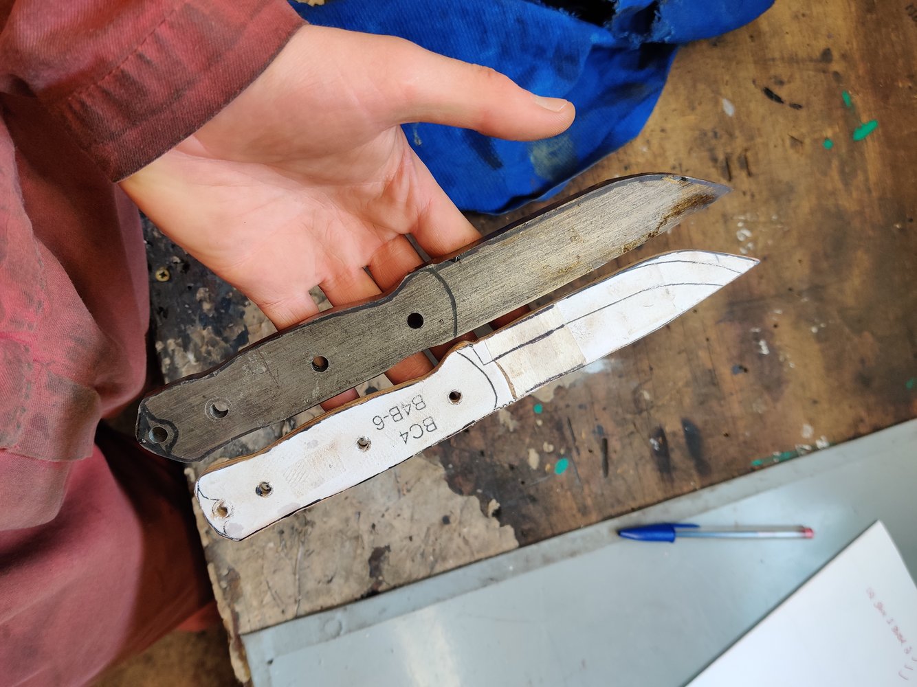

Unless you have a mill or surface grinder I wouldn't grind it flat to thin it out.Brilliant cheers I will got for the full flat type grind
I suppose I could also grind down flat on the stock just to make it thinner overall but not sure if that's a good idea
I've got a mill so could try it but this is a chopper bushcraft type knife not going to be slicing tomatoes ultra thin lolUnless you have a mill or surface grinder I wouldn't grind it flat to thin it out.
You have plenty of steel to play with, don't expect it to come out perfect on your first knife!! I've made probably a hundred and still have a way to go.
Looking great that mateI've got a mill so could try it but this is a chopper bushcraft type knife not going to be slicing tomatoes ultra thin lol

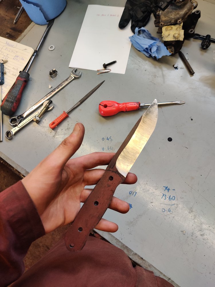

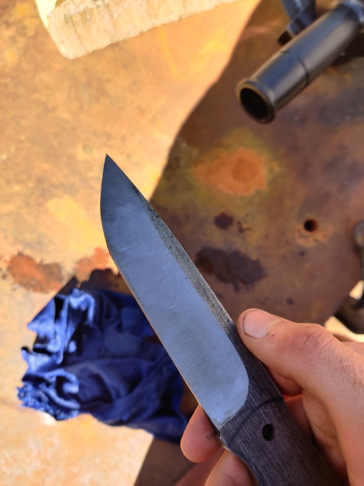

To be honest I'm actually preferring the look of this deeper grind aswell I really like it
Great fun![]()

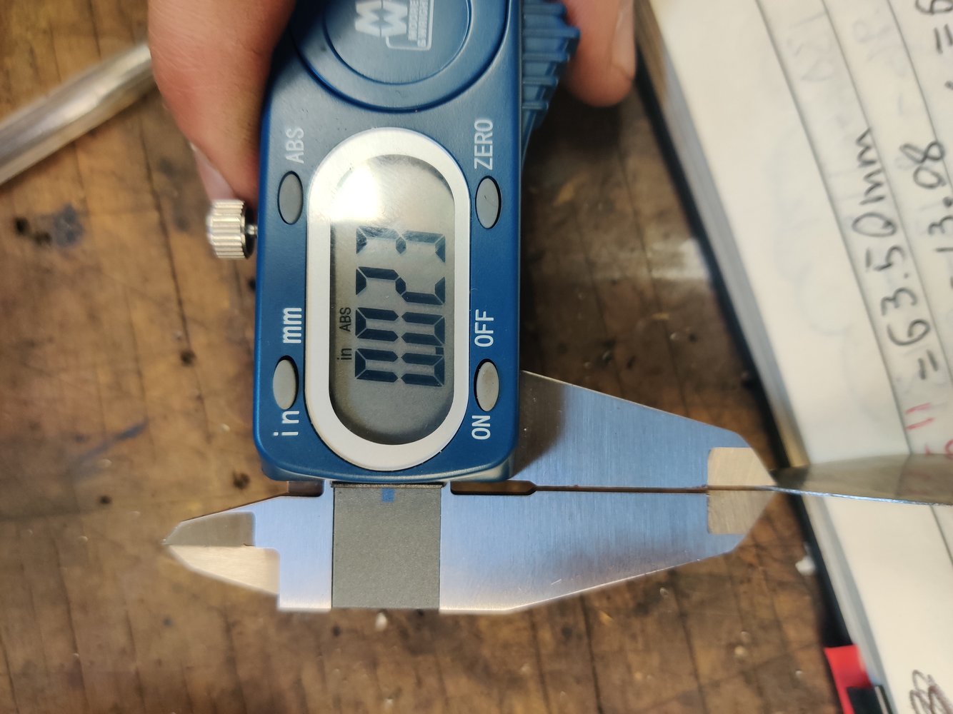

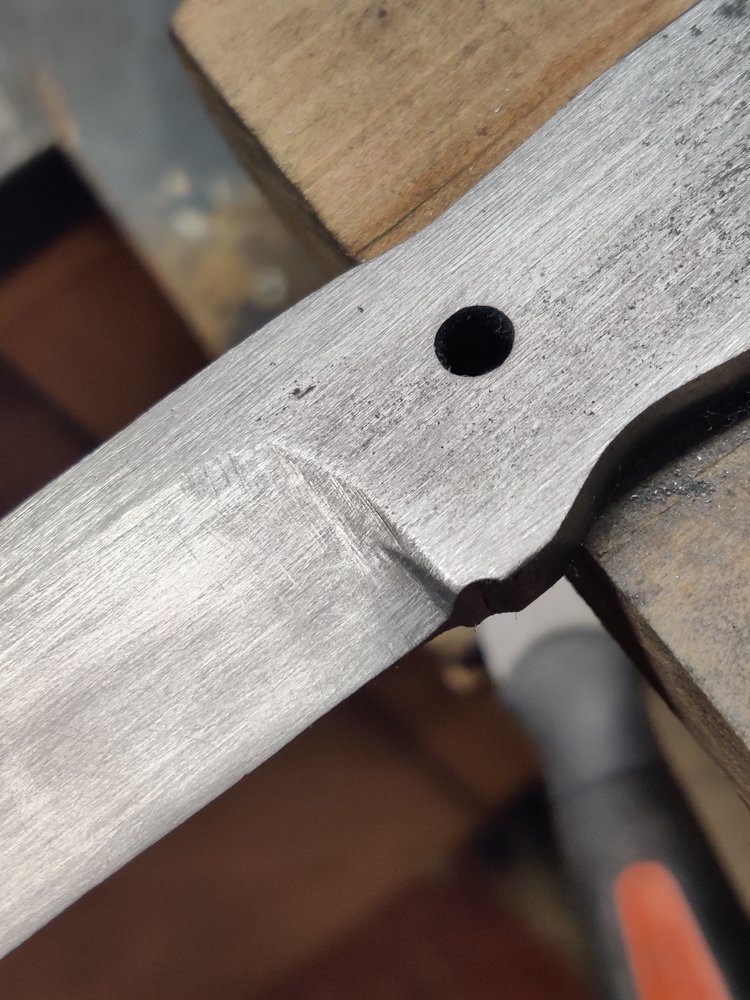

Oops may be a bit thin hereLooking good. Biggest mistake I made with mine is going too thin before heat treatment. Ideally you want to leave it pretty thick and even keep a lump on the tip to stop that burning out. depending how much you like grinding, probably 10-20 thou at the cutting edge. Otherwise the thin parts overheat before the entire blade gets up to temperature and the edge can decarburise. Had that happen with a kiridashi and I had to grind the whole tip off. Next time I'll leave the very tip really chunky and finish grind that to shape once its hardened.
