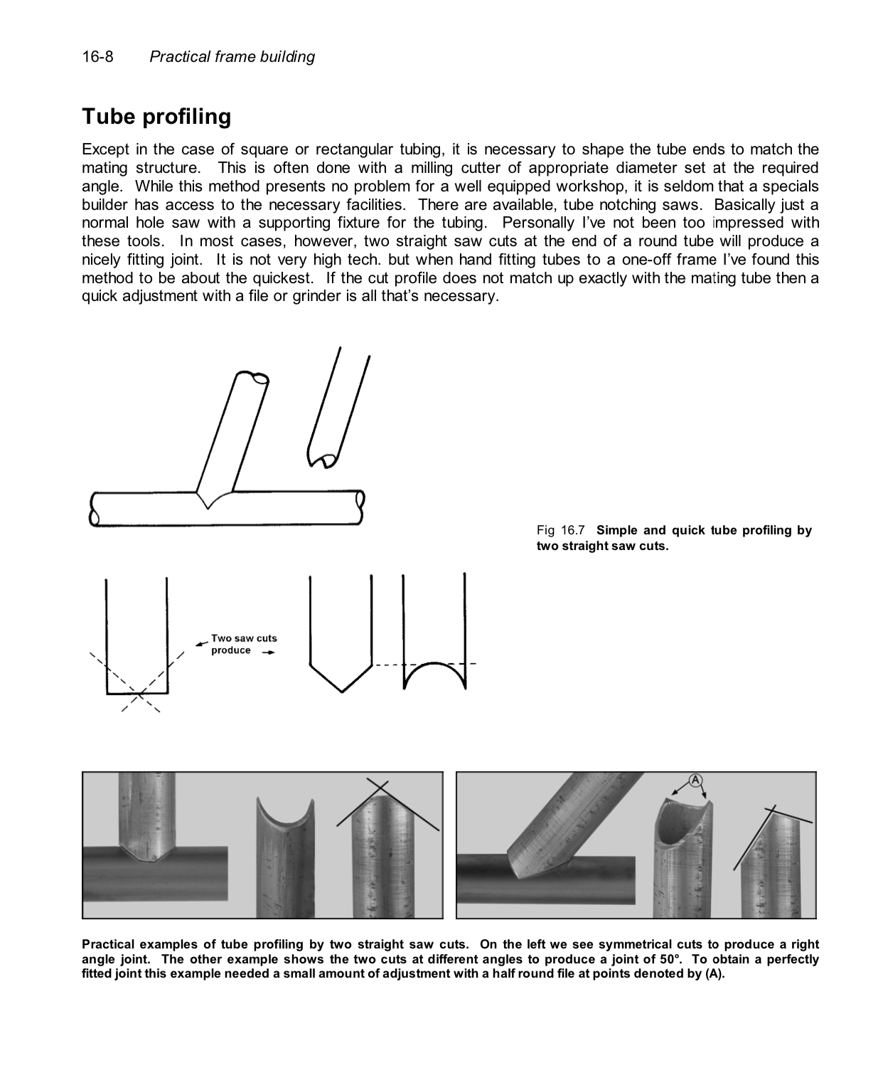

I have his other book:Found this ePub ebook link last night to Tony Foale’s motorcycle chassis and design book. The paperback is going for £472 on amazon or eBay as it went out of print a long time ago.
.I have his other book:
Covers similar in less detail:
Doubt I paid more than £10 for it when I bout it in 1989.

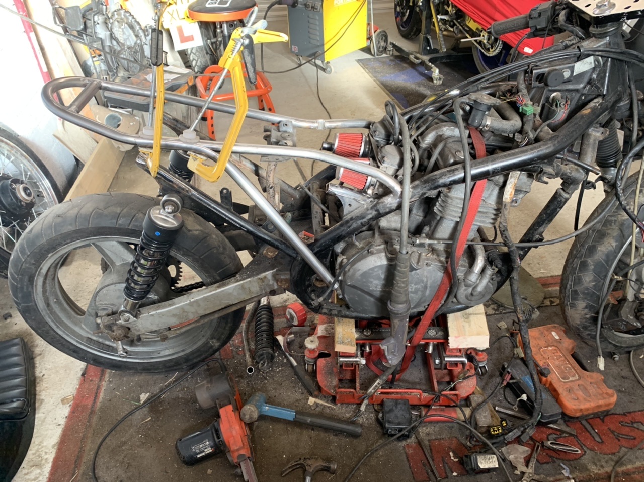

Really nice work so far, it's amazing how a back end replacement changes the entire look of a bike!
